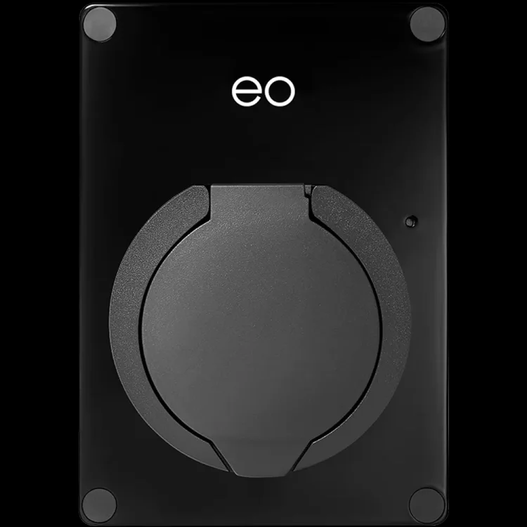

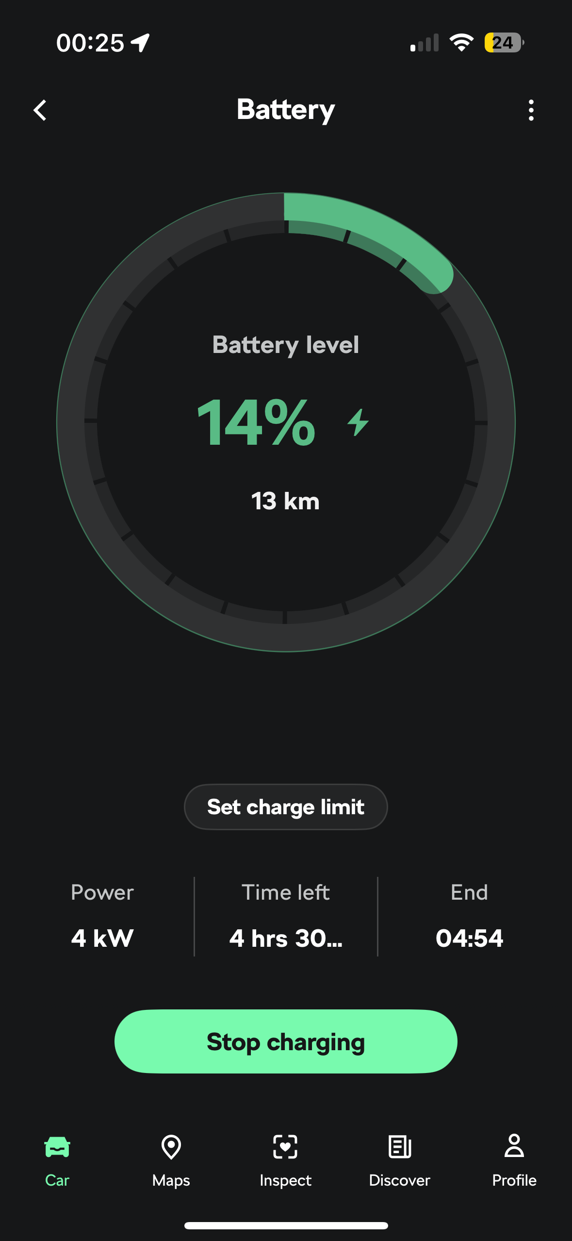

The saga continues, Skoda came back to me with the following: We have received a response from our technical team. As our colleagues have informed us your cables are on 3x20A (3 phases) but the charger is 1x32A (one phase). The Kodiaq can take about 16-20A from a single phase that means, about 4kW. With a single-phase charging, the maximum power is about 7.3kW. This is what the VW ID4 can almost use. To use the full 11KW three phases and a minimum of 16A are needed. Of course, we are talking about theoretical values, and the reality of physics will always be with deviations. So it seems to be either the cars software or the cable supplied with the Kodiaq as I charged the car at 6kw using a cable from a ID4. They donāt offer a solution. š¤·āāļø

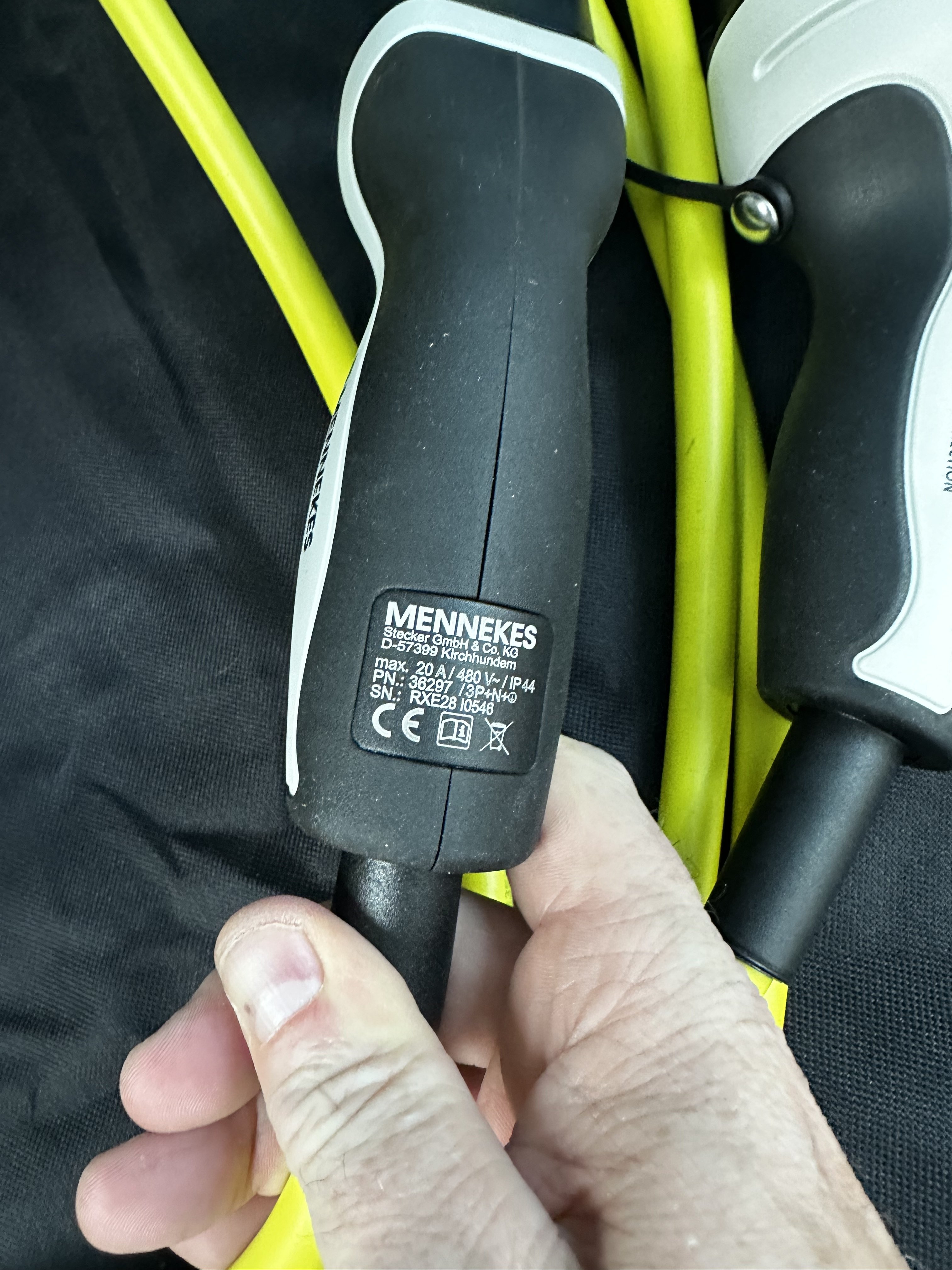

Just an update on this, I've done some testing using other chargers and cables. Kodiaq iv on my 7kw Home Charger Using cable supplied with the Kodiaq - 4kw Using cable supplied with a VW ID4 - 6kw VW ID4 on my 7kw Home Charger Using cable supplied with the Kodiaq - 4kw Using cable supplied with ID4 - 6kw Kodiaq iv on a 22kw Public Charger Using cable supplied with the Kodiaq - 10kw Using cable supplied with a VW ID4 - 10kw Also, the cable supplied with the car seems to charge at up to 10kwh but just not from my home charger. Also, just to note, the charging cable is not a branded Skoda cable, should it be?

Thanks for the info, much appreciated. The master fuse says 60/80A. We did get a load balancer with the charger when it was installed as we have a 10kw electric shower but I've tested car charging when there was low usage in the house. I charged another car a couple of years ago and I'm pretty sure it got close to 7kw, I'll retest it again. My Superb iv only charged at 3.5kw so it wasn't an issue. The company who installed the charger haven't gotten back to me but I'll keep at them.

I have a new Kodiaq iv (2024 PHEV) and I have an issue with home charging. When charging at home, the car should be charging at 7kw but it its only charging at 4kw (see attached). I have not set the current limiting. I used a public charger and got 10kw. From talking to people online, Iām not the only one having this issue, the guy in this review said the same thing. Anyone else having this problem?
