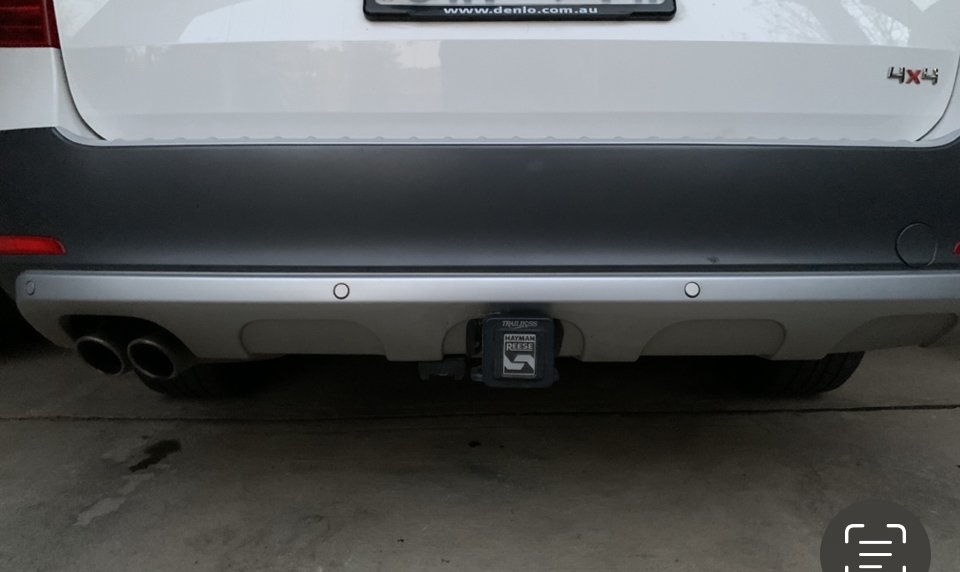

Mines a Trailboss, even though the cap Hayman Reese
