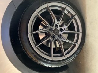

  1. This noise was present with my previous wheels and tyres, but due to overall noise it was more of a feeling. you have to listen closely, but there is a definite rhythmic pulsing “wrrmm..wrrmm ...wrrmm.” I thought it was wheel bearings but Skoda did not. it’s really noticeable at 115kph the new wheels and tyres made the recording possible

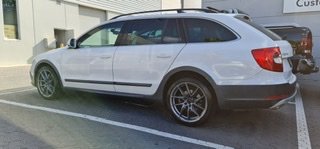

  2. 650km highway run completed on variety of surfaces. Very very Happy. 225/50r17's should be the standard tyre on this car. It is on the VW Passat in this country. According to GPS, the speedo is now showing the exact speed. (GPS and speedo show same)
  3. Highway run completed. Very bearable, even with cheapie tyres. delighted with my return on investment. 225/50r17 should be the default on this car. Just like the Passat in Australia.

  5. So after sticking 8.5kg of sound mat throughout my boot, bonnet, wheel arches, mud guards, underbody protection panels and skid pan in an effort to reduce road noise on Australian coarse chip surfaces I was a bit down hearted, the road noise had gone from being impossible to live with to a much better, less harsh, boominess. Better but not as good as I had hoped. So today I changed the wheels and tyres from 225/40r18 (7.5") to 225/50r17 I got an excellent deal on the 17" wheels from a 2020 Octavia buyer - 17x7" for AU$200 (EURO140-ish) - and went up from the recommended 215/50 to 225/50 (the VW Passat uses this size as standard) This was my last throw of the dice. First impression is "OMG!!!! HOW BLOODY GOOD!!!!": I am yet to do some Australian coarse chip freeway running, but on a couple of local roads the difference is incredible. I should have started with this change. It is soaking up the road imperfections with a soft bump, rather than a hard knock. And the while there is still a rumble on the coarse chip it seems much more muted. Only a true Highway run on the coarse stuff will show the worst. I'm very, very happy. The sound mat will also be helping no doubt, so no regret in the time and effort spent. I'll update when I have done a freeway run. I have 650km to drive tomorrow. Not dreading it now.
  6. So I have now changed the wheels and tyres from 225/40r18 (7.5") to 225/50r17 I got an excellent deal on the 17" wheels from a 2020 Octavia buyer 17x7" for AU$200 (EURO140-ish) and went up from the recommended 215/50 This was my last throw of the dice. First impression is "OMG!!!! HOW BLOODY GOOD!!!!": I am yet to do some Australian coarse chip freeway running, but on a couple of local roads the difference is incredible. I should have started with this change. It is soaking up the road imperfections with a soft bump, rather than a hard knock. And the while there is still a rumble on the coarse chip it seems much more muted. Only a true Highway run on the coarse stuff will show the worst. I'm very, very happy. The sound mat will also be helping no doubt, so no regret in the time and effort spent.

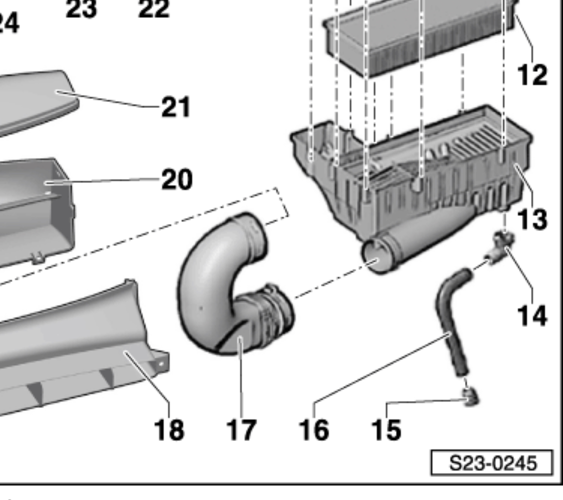

  8. Now I know it’s not #15
  9. Number 15 on this diagram is labeled as an over flow valve. It could be said item. It would be in the general area that I found it. If it is indeed the overflow valve, what does it overflow?

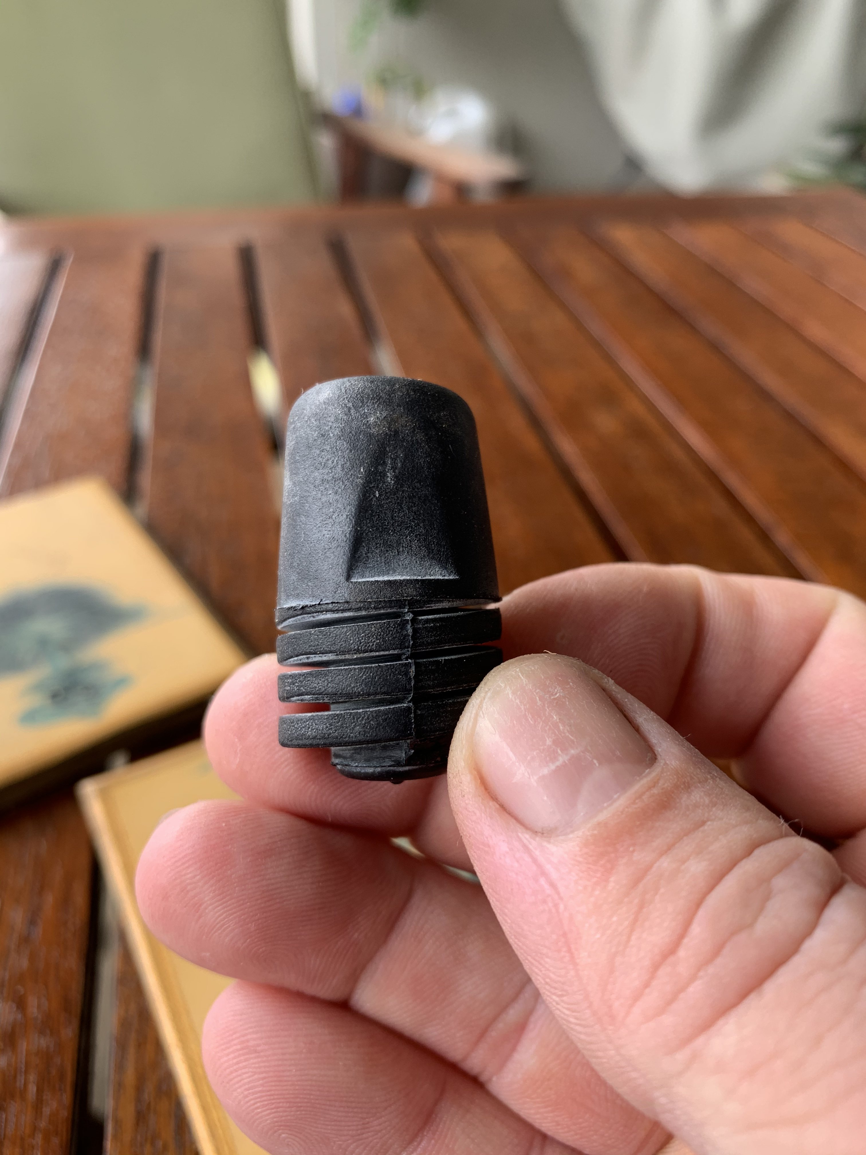

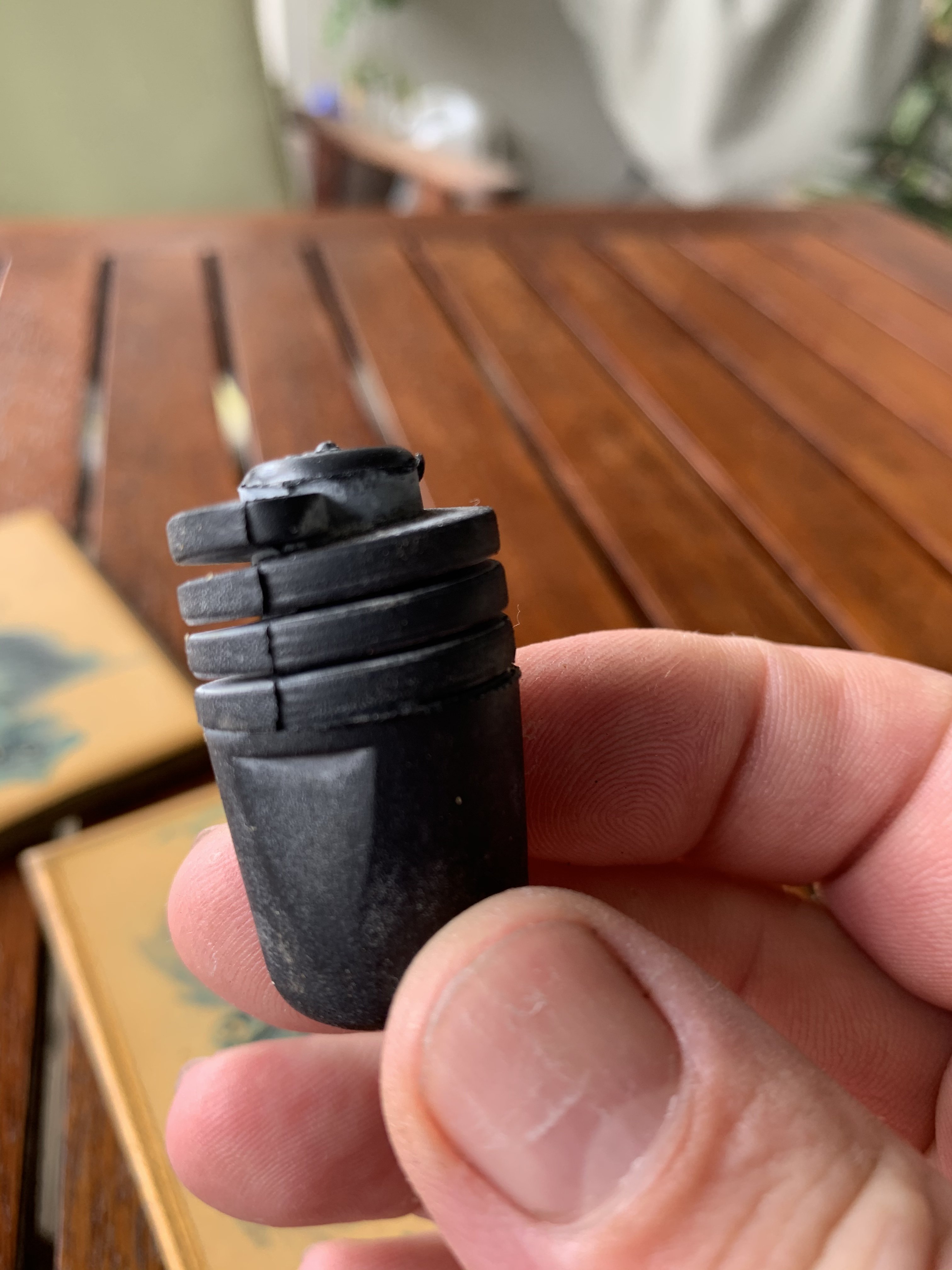

  10. Cleaning under and around my air filter housing and this rolled out. can anyone tell me what it is/does? it’s like a hard rubber screw in stopper.

  14. 18x8 instead of standard 18x7.5
  15. New wheels from the dealer under statutory warranty. I settled on some after market PDW Corsa rims, rather than waste time. The difference is immense, so much less overall road noise and the rhythmic woom-woom-woom is gone. Skoda workshop was correct in their diagnosis.
