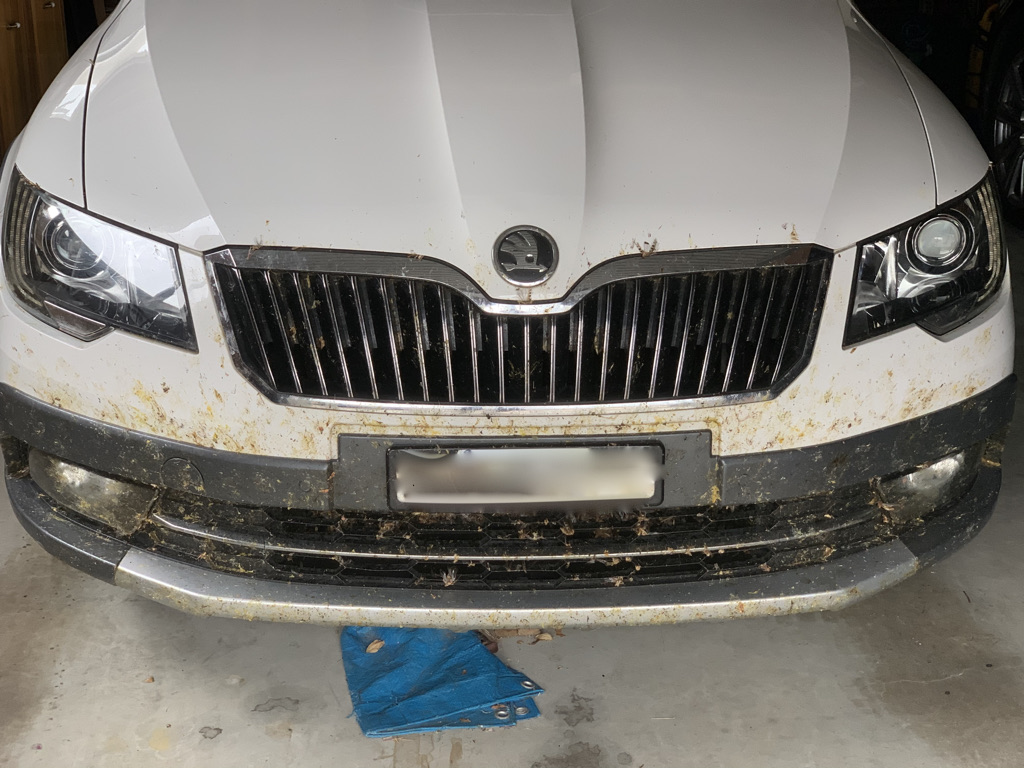

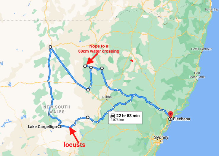

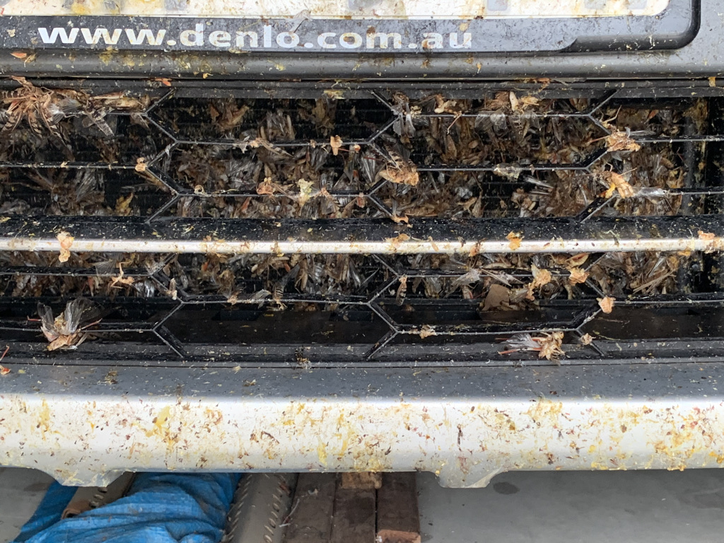

  7. I am happy to say the Superb coped well in the Aussie west, sitting on 120kmph in 37c heat. I was comfortable and the temp gauge never moved, even after the locusts clogged everything up. Camped in the back. My 173cm height fitted remarkably well.

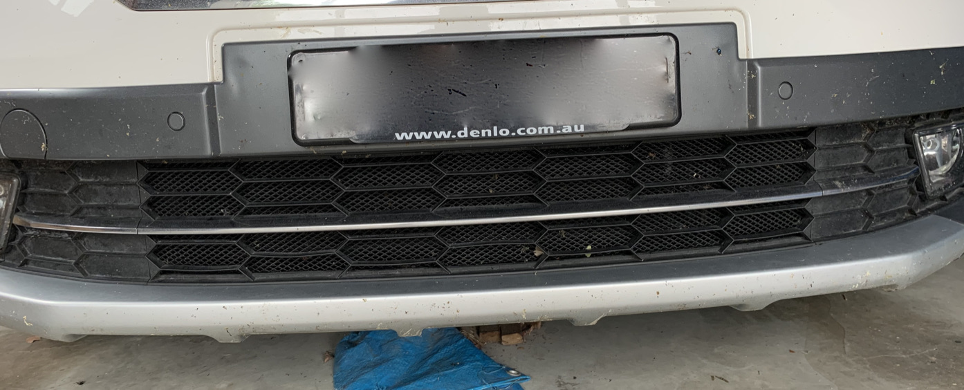

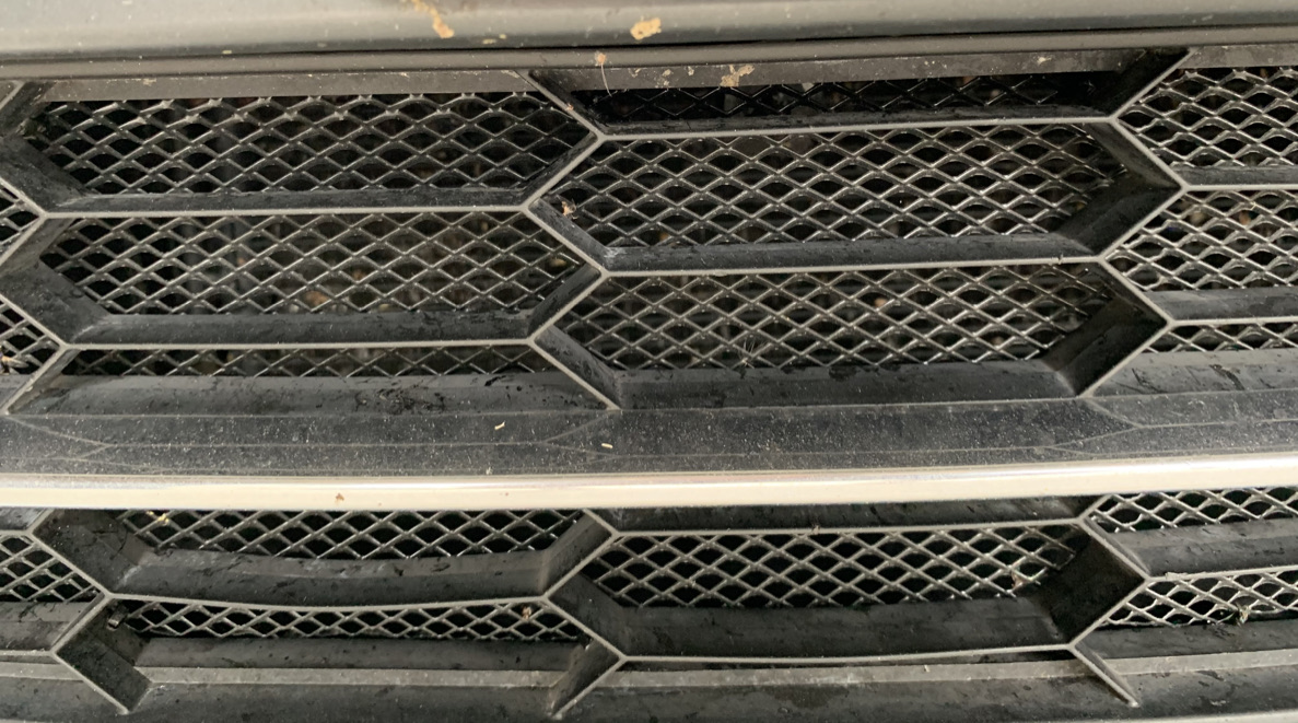

  8. I cannot believe where they managed to get into. All through the engine bay, trapped behind the mudguards. But I've sorted a solution for future trips... Aluminium 4x8mm mesh, using 4x screws and 15x2mm cable ties

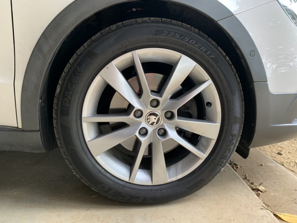

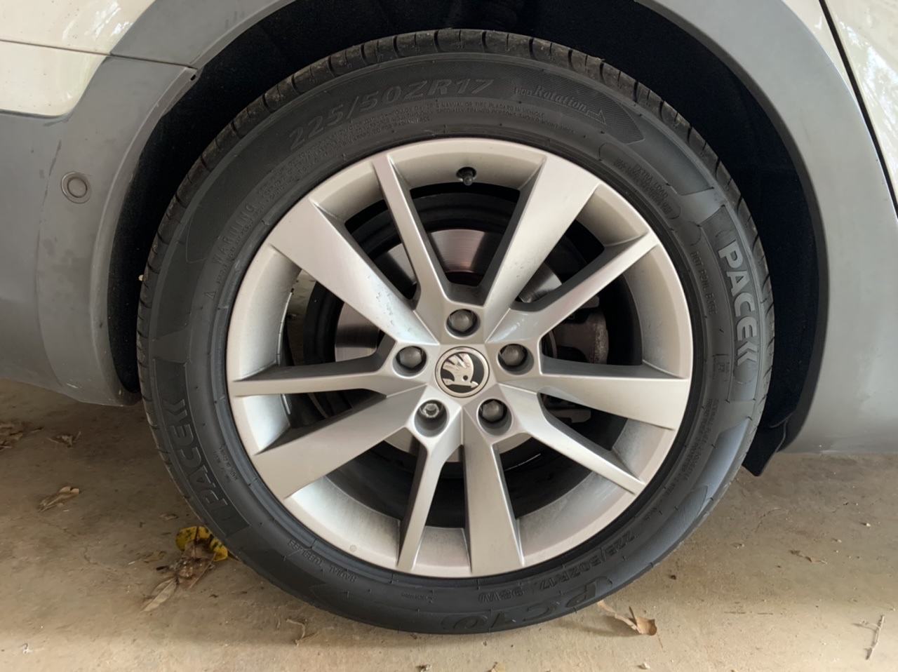

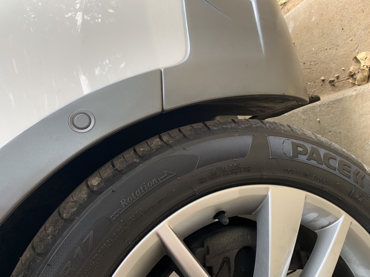

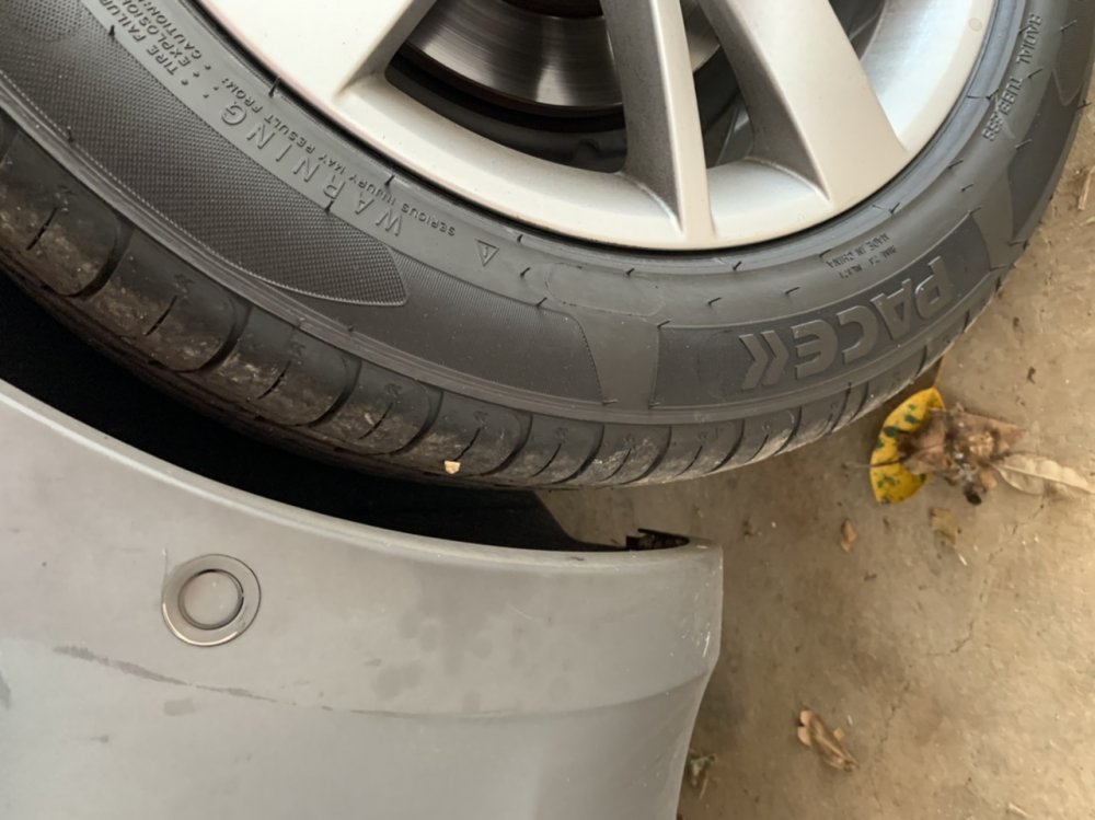

  18. With it’s smaller 17” wheels from a 2020 Octavia and 225/50r17 tyres. so much more refined than the 225/40r18 that were standard. look at the difference in the sidewall! no crashing over road imperfections now.

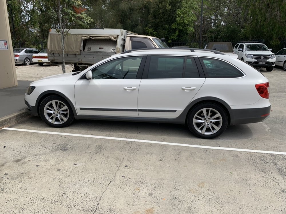

  19. This is how it looks with the new wheels and tyres. You can see the gap between the tyres and guards is smaller. There is about 2cm when the wheels are fully turned

  21. Just listened to the YouTube versions. It appears the compression algorithm has filtered out the noise FFS!!! Its so much clearer on my phone.
  22. My water pump just failed. Do you think that could be the cause of the noise/vibration? $1k for water pump and timing belt. 🥺
