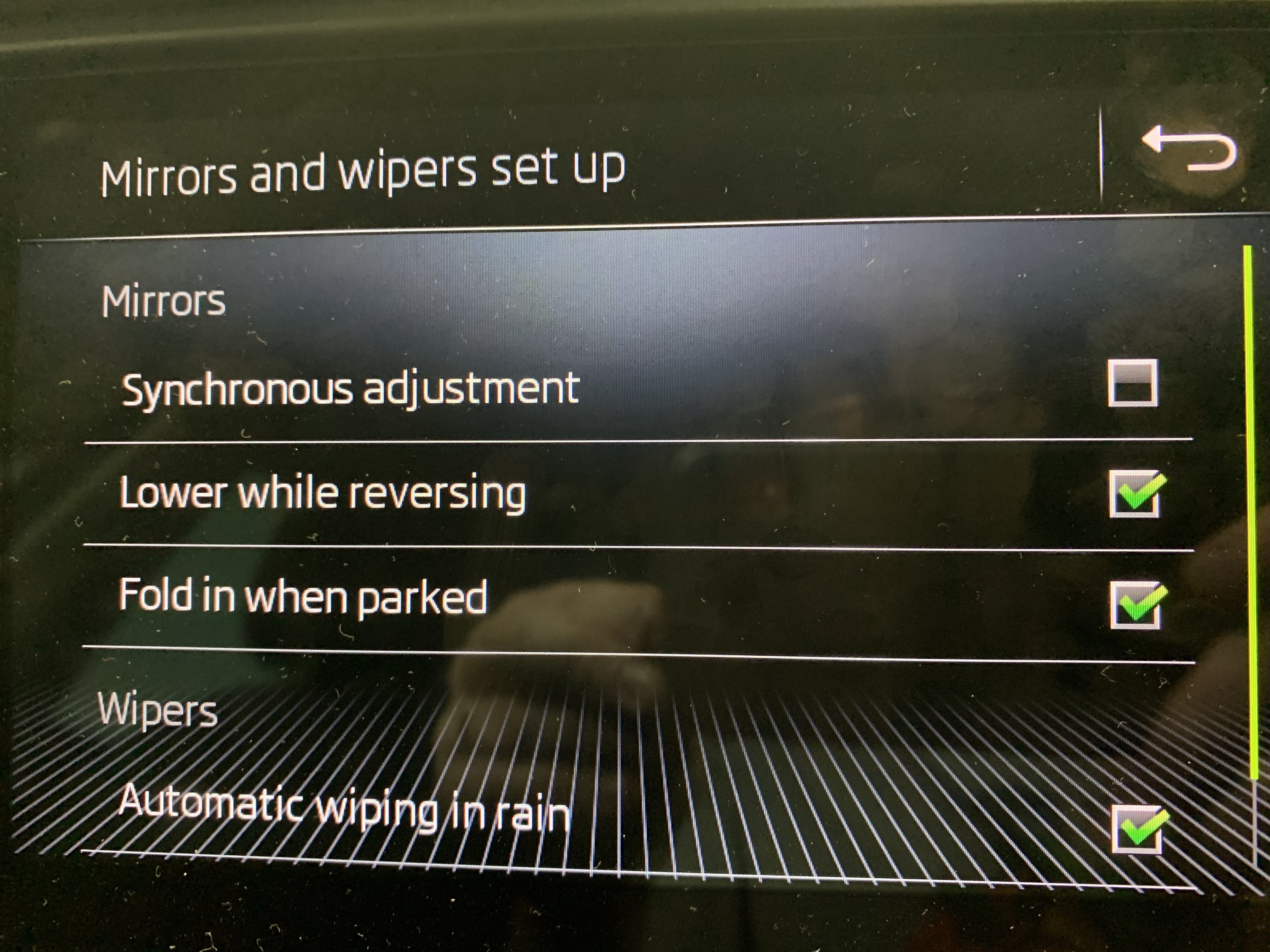

  17. Mirror dip is working and active. It doesn’t move a massive amount but it still moves and is useful when parking.

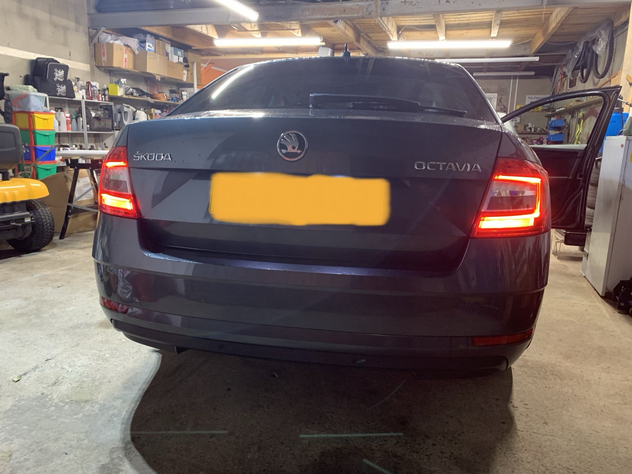

  20. Thanks, the page you first sent about the cornering lights what’s the top part as that would appear to be regarding temperature. Is that part of the fog light coding as this is the only thing that won’t work as yet

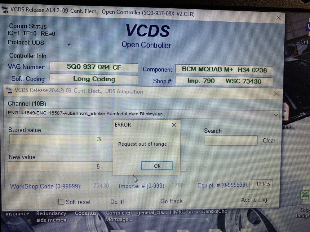

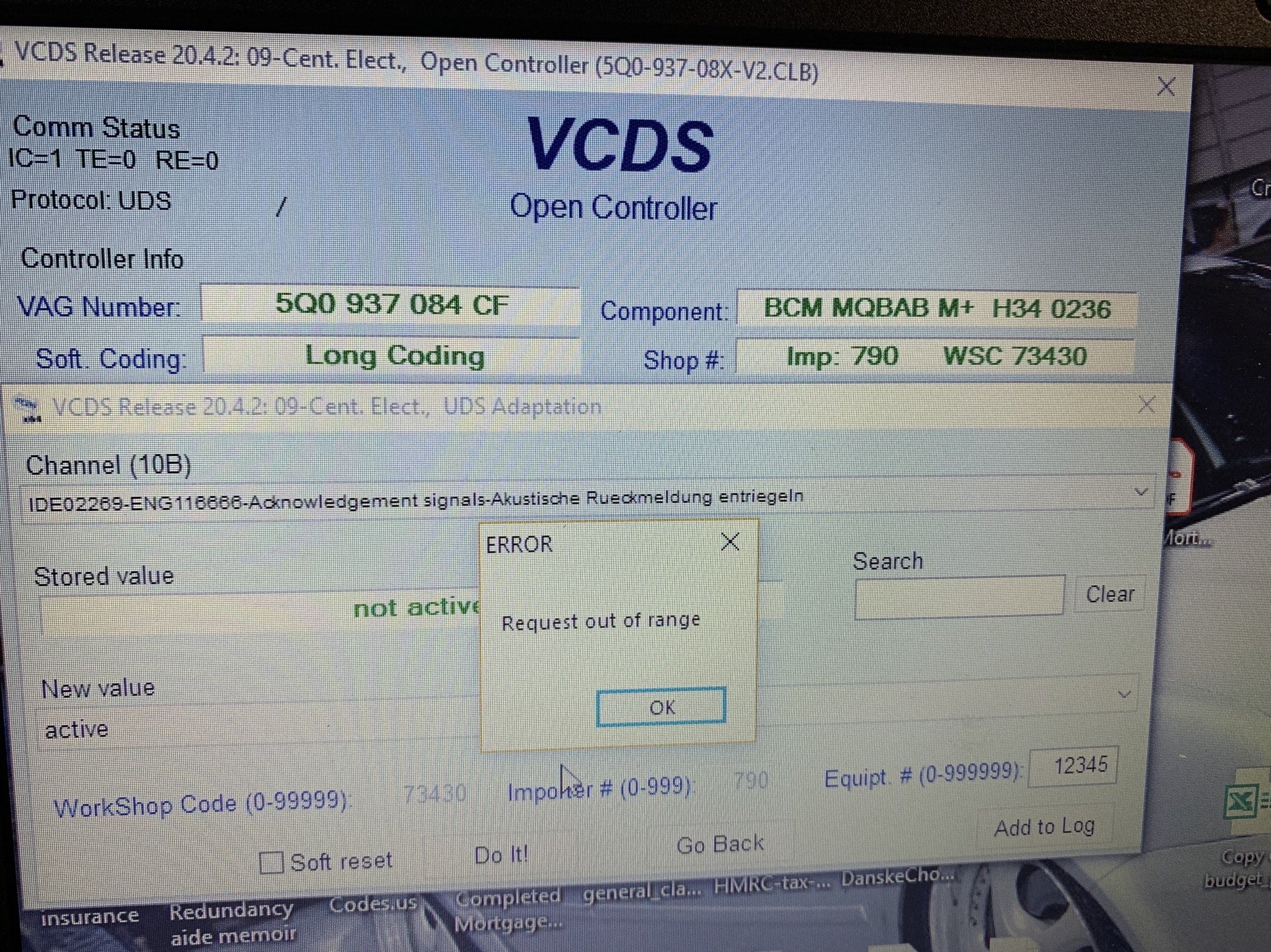

  21. I shut the computer down lol, went at it again and the comfort indicators and alarm chips now work although these are very very quite compared to other vag cars I’ve had. My Audi was very loud this is barely audible.

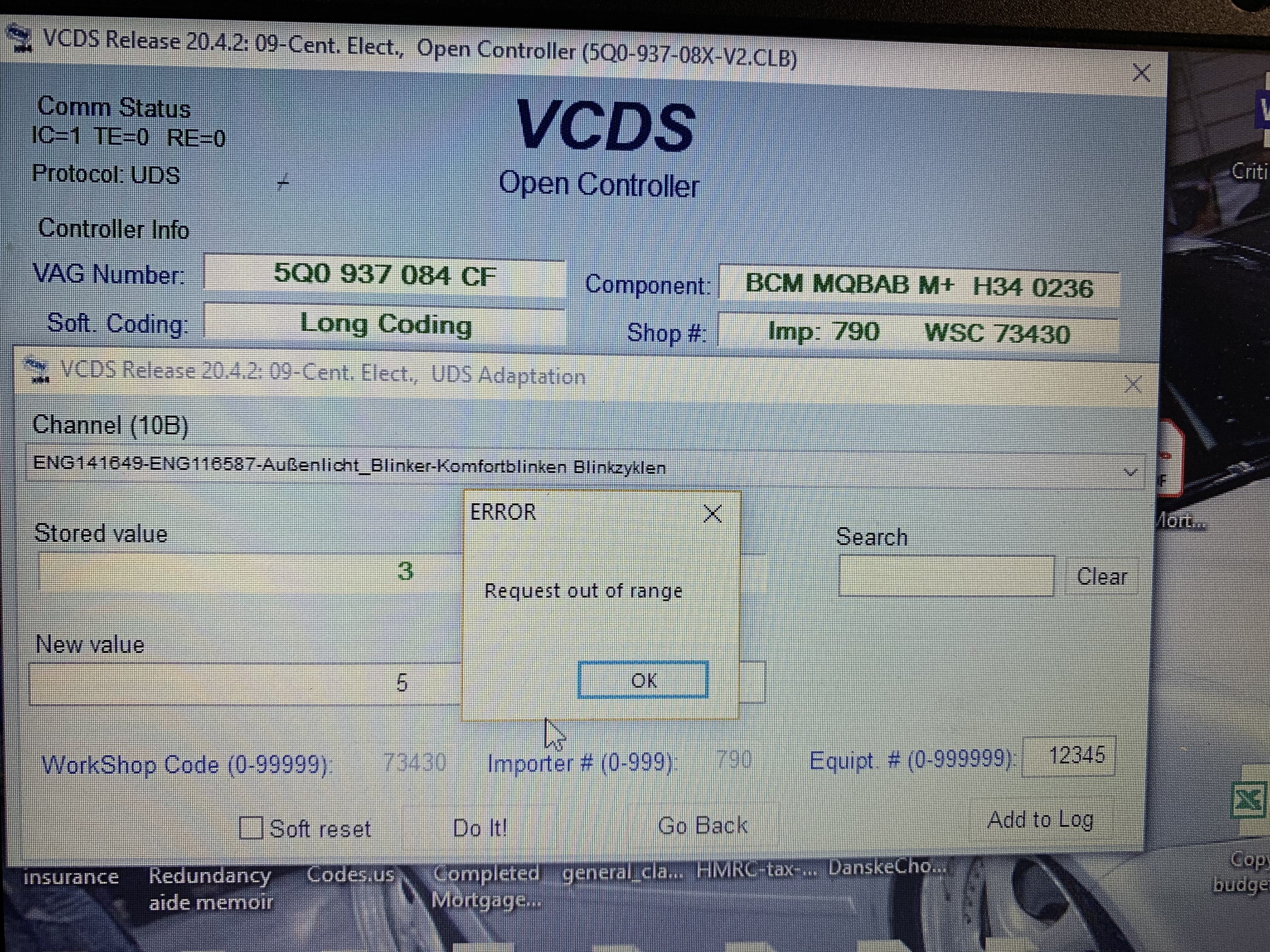

  22. Thanks for this but all I get is request out of range
