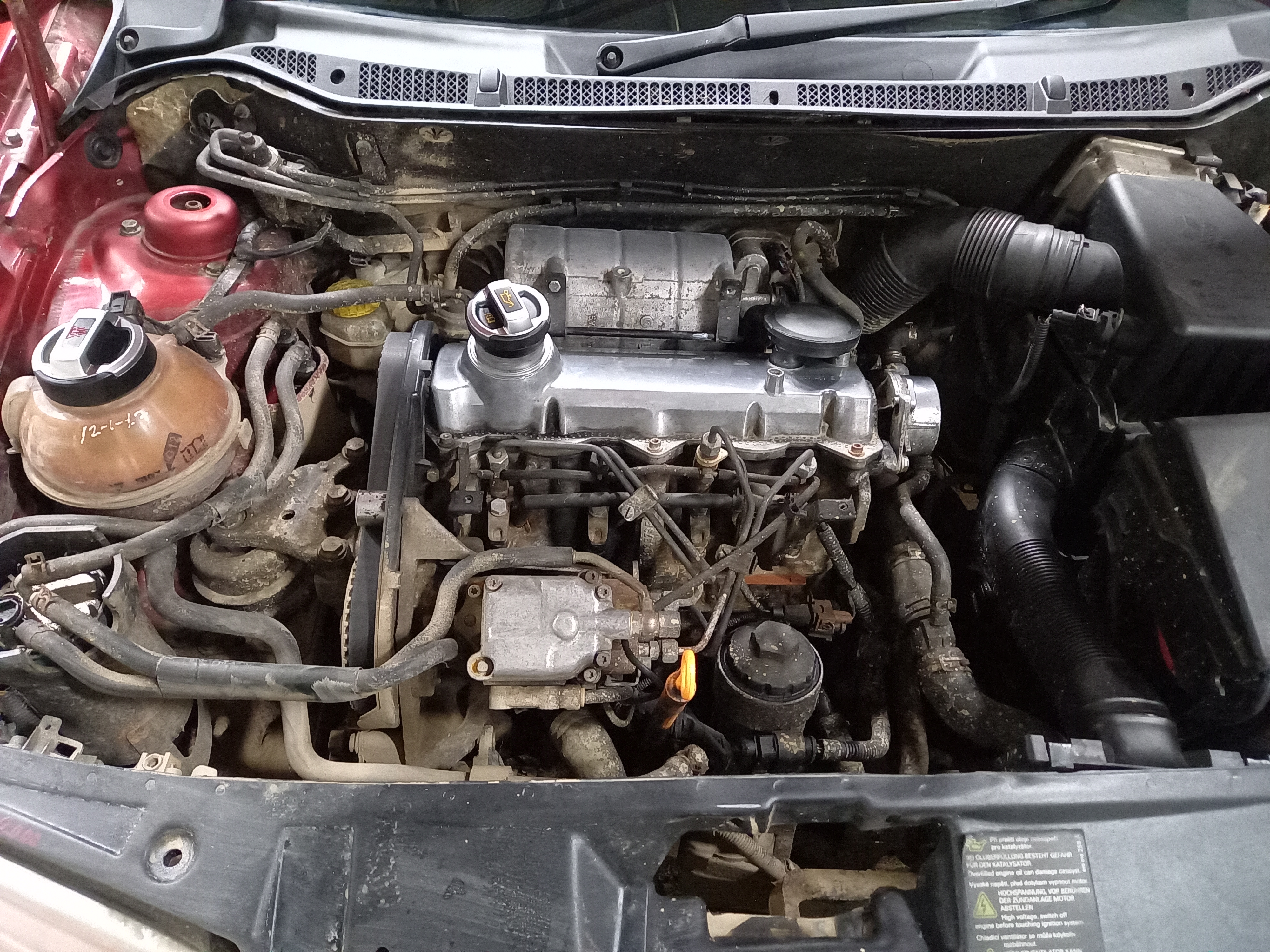

Okay, i have tested the evrymod for about one week now. And i must say, you can feel actually pretty good difference when it comes to more torque (not like ahuge amount). Really helps in low gears. Would recommend to try it out😊
Thats pretty impressive that it worked. How did you wire it up? Or have you just "sent it" by splicing in a resistor?
I pretty much put took two wiretap connectors and put it on the second and third pin in the 10pin connection (you see small notches with numbers on the connection), then run wires from it and through the firewall and in to the dash, putting on a 1kohm potmeter on and a switch. After that its just to urn on and adjust untill you find your personal preference😊
  • 4 weeks later...
Hello guys felt like an update was welcome. After knocking my cat out and preforming the evry mod my sdi has come alive. Alot more power then what it had. Maybe a 6 hp boost and more torque. Doesnt sound like much but my estate finally can finally out pace a bus 😅  I have wired a switch into the cab and can active at will. Much better then leaving it permanetly on. Leaving it on causes irratic idle depending on what resistance you decide to use. In my case i used an 1k ohm potentiometer. Allows fine tuning for power without ruining gretas chillhood with smoke. Overall a great mod to liven up my sdi. Still get 60 mpg no matter how I drive. Great car.
