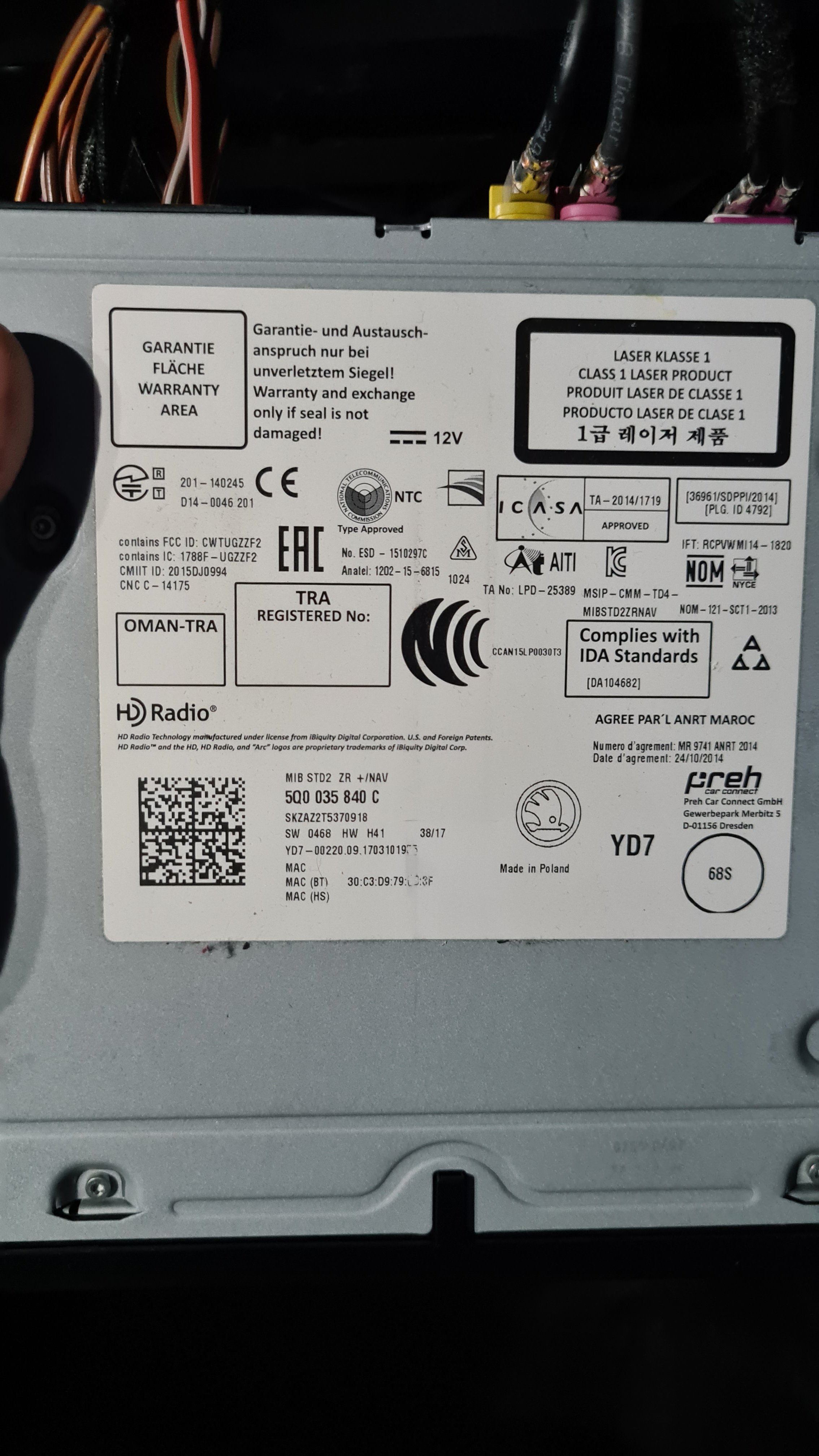

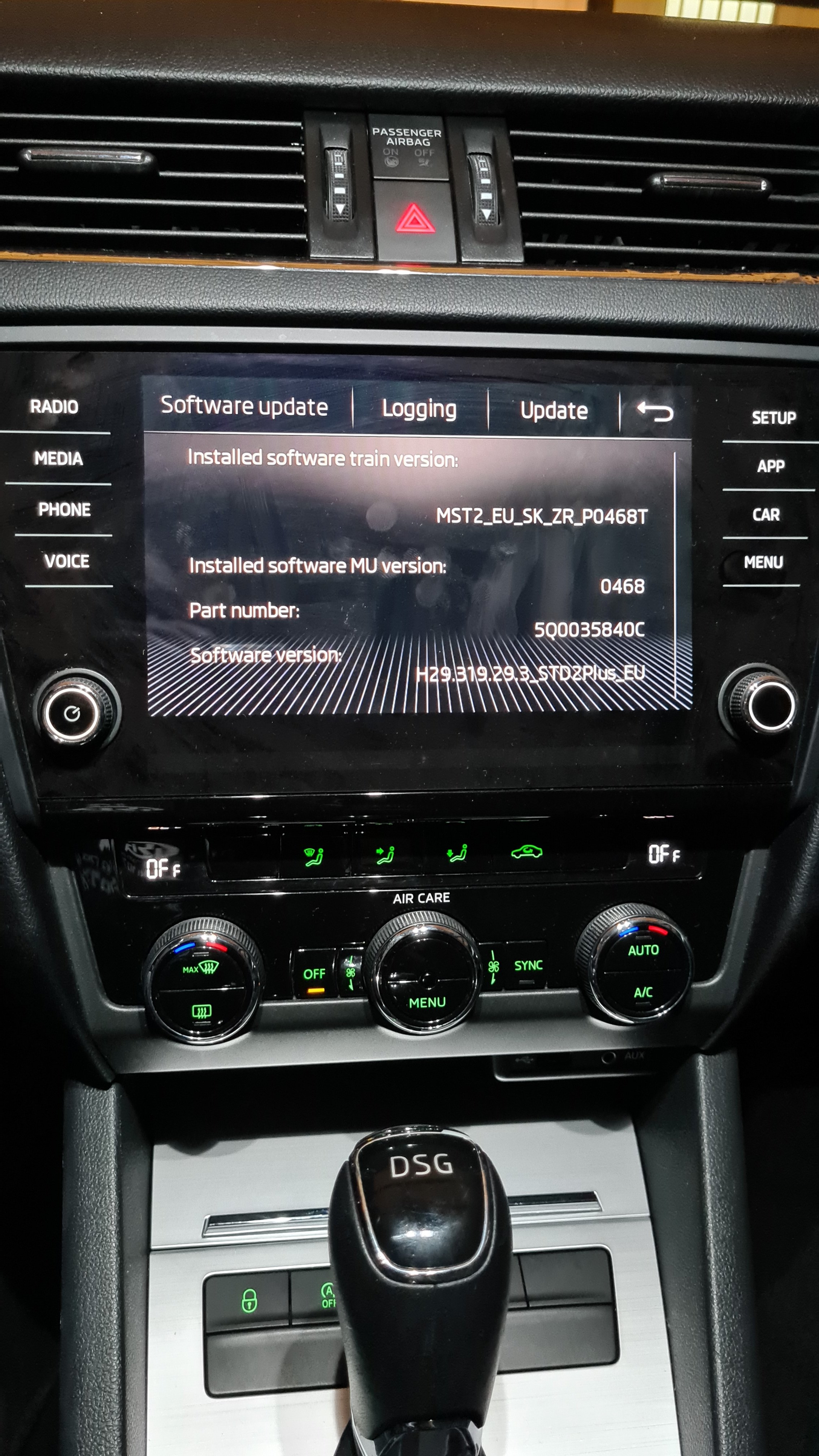

  13. @SashaGrace Thank you for your reply! I did the coding and the camera is getting its power from the rear wiper. Still not working tho :-( Maybe a software update will fix this? I've read in other forums that there was a bug in some software versions and owners went to their dealers to get an update. @pab567 Can you please help me? My Software version is in the first picture attached. Many thanks!
  14. Hey everyone! I'm getting this message on my screen that says "Parkpilot is currently not available". I retrofitted my camera today and coded byte 19 "rearview camera enable" using OBDELEVEN. Does anyone knows what could it be? Here a picture of my unit: Any help will be much appreciated :-)
