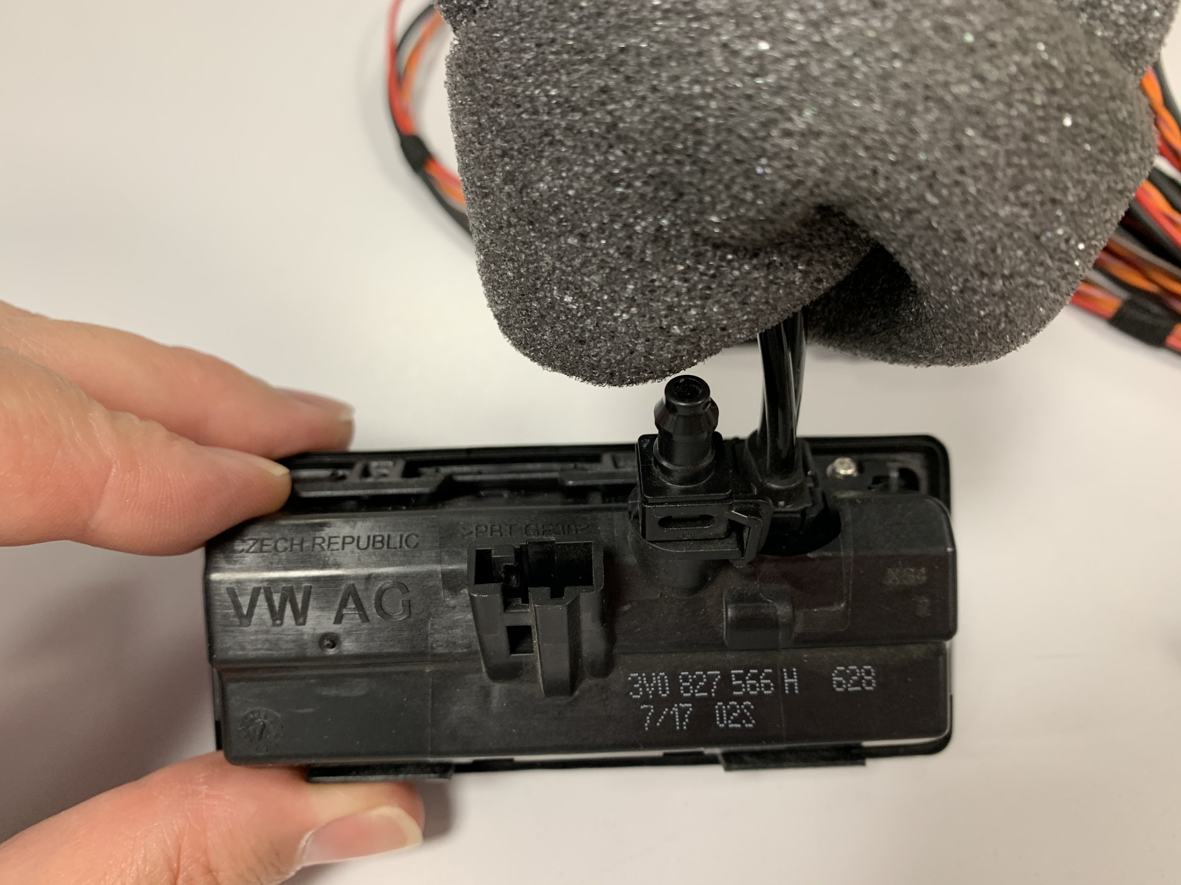

Hey everyone!
I'm getting this message on my screen that says "Parkpilot is currently not available".
I retrofitted my camera today and coded byte 19 "rearview camera enable" using OBDELEVEN.
Does anyone knows what could it be?
Here a picture of my unit:20200926_204310.thumb.jpg.21c40e67f3d2186d121d1487269afbb5.jpg20200920_190216.thumb.jpg.7bced3ec64477834c13dd294b393fe09.jpg
Any help will be much appreciated :-)

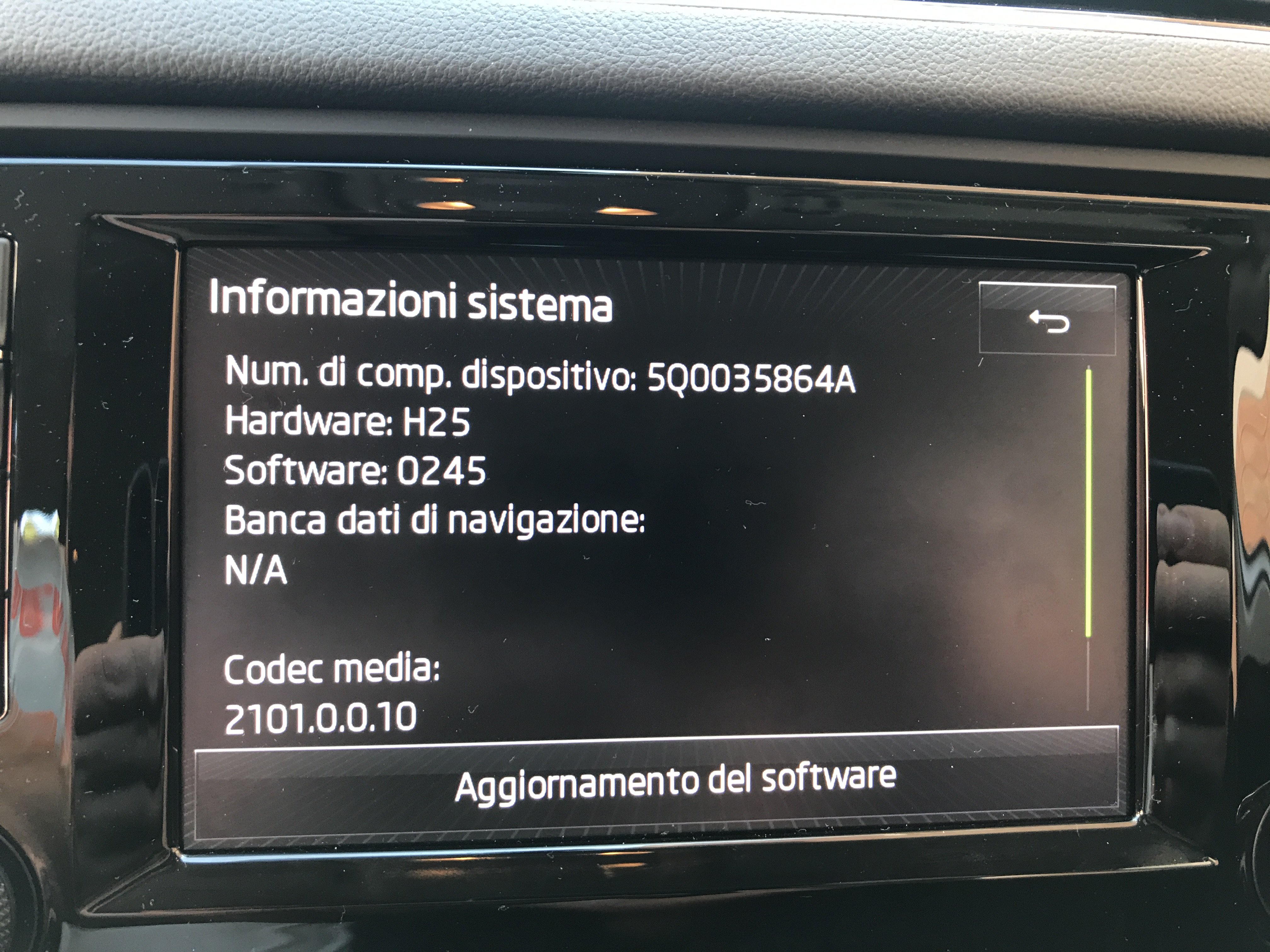

Can you please help me? My Software version is in the first picture attached.
Many thanks!

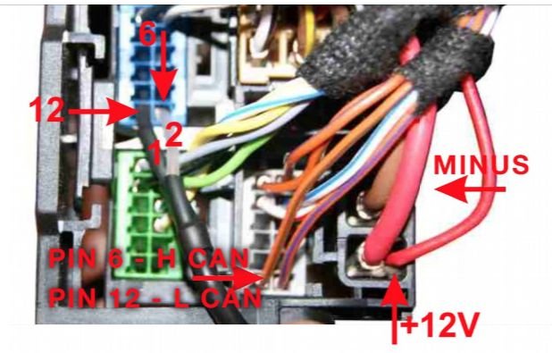

Hi guys, I also have the same problem as @HaronAshmoz , I have read many topics but i haven't been able to solve it yet; I have a 2016 Octavia Scout with Amundsen MIB2 radio (0245 software version) and I installed an OEM highline camera purchased on skoda-parts.cz with its wiring, I did the coding but I always get black screen with the error "Park Pilot not available" every time I put the car in reverse .
I connected the + 12v to power supply of the MIB unit (also GND), I connected the CAN high and CAN low cables to those already existing in the quadlock and the two video pins, all as indicated in the diagram in the photo.
What am I doing wrong?
Thank you.

I would connect to a constant 12v in the fusebox personally. Is there anything showing on the scan? Has the module been added to the gateway? Sounds like a video feed issue possibly.
Hi SashaGrace, thanks for your answer.
I will get power from the fuse box as you suggest (it was much easier to take power behind the MIB :biggrin: ), I will check with VCDS if I correctly added the module to the gateway.

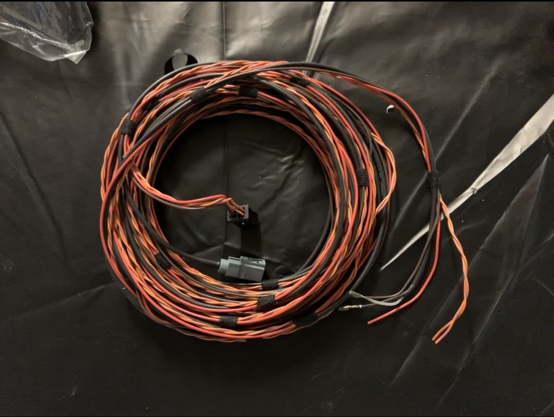

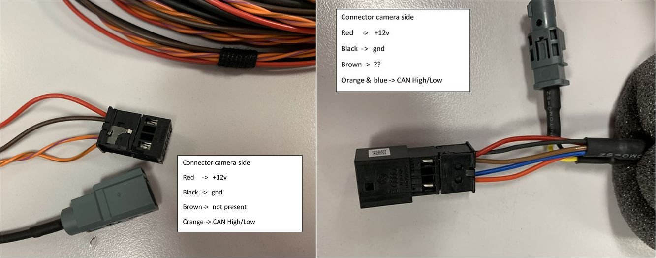

The only doubt I have to solve is on the wiring, because 5 wires come out of the camera while there are only 4 wires on the wiring (excluding the video signal cable wich is separate).
That’s normal, there should only be 4 wires from the CAN plug.
