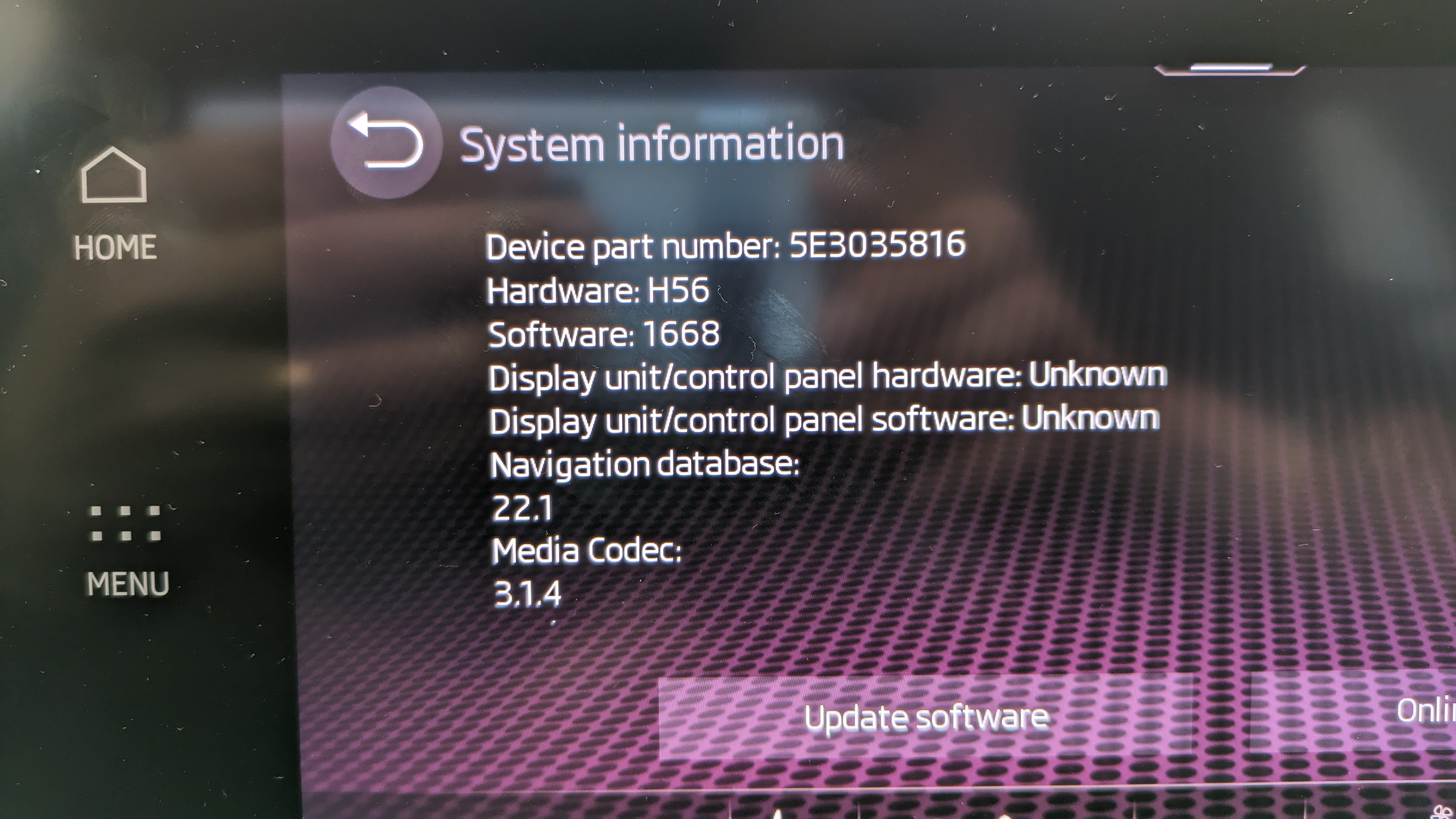

  4. My dealership updated my infotainment software a couple of weeks ago and I assumed it was the latest version, but reading the above posts, it doesn't seem to be... Device part number: 5E3035816H Hardware: H56 Software: 1896 Display unit/control panel hardware: H44 Display unit/control panel software: 2088 Navigation database; 22.1 Media Codec: 3.1.4 Since the update, my sat nav hasn't loaded at all (I've using my android phone instead) and it hasn't stopped the "pop pop SOS" error. The system doesn't restart itself though. I wonder why we all have different software versions.
  5. Find this thread quite late. I've driving my First Edition since 2020 and by and large quite happy with it. But the SOS popping and then crashing is very annoying. I checked my softward version and it showed 1688! More interestingly, both Display Unit/control panel hardware and software are "Unknown"., but I see above that other people's have numbers and letters. BTW, I have taken my car to France the last two years, and throughout the 2 weeks there, the system never popped one. Soon after I drove off the ferry at Portsmouth and got on the A3, it popped and the SOS error appeared!
  6. 1941?! Mine is 1668, which may explain why the SOS popping happens quite frequently and that the infotainment system has crashed a couple of time in the last few weeks.
  7. My Octavia is 70 plate and a 1st Edition. I just checked the software version and it was 1668! Perhaps that explains why the SOS is popping quite often and crashed a couple of time in the last few weeks. I've booked it in for the oil service and a software update in 2 weeks' time. Hopefully, it will solve some of the issues...

  15. Lucky you. My dealer doesn't know why it keeps happening. I can live with the error message, but when it makes the sat nav goes haywire, that's when I get annoyed. I mentioned it when I took the car in for another software update but they said they couldn't find any errors on the system. They told me if it happens again, I should drive to my nearest dealer so that they can record any faults showing and report it to Skoda. I mean, honestly...!
