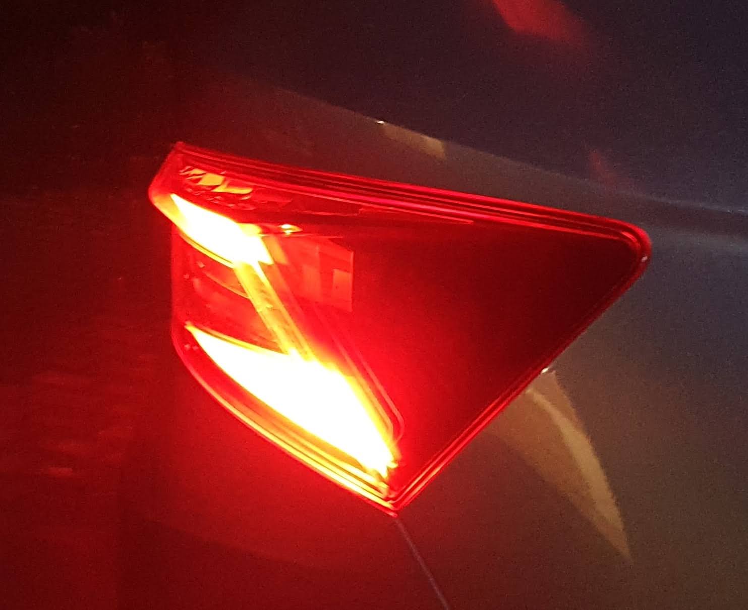

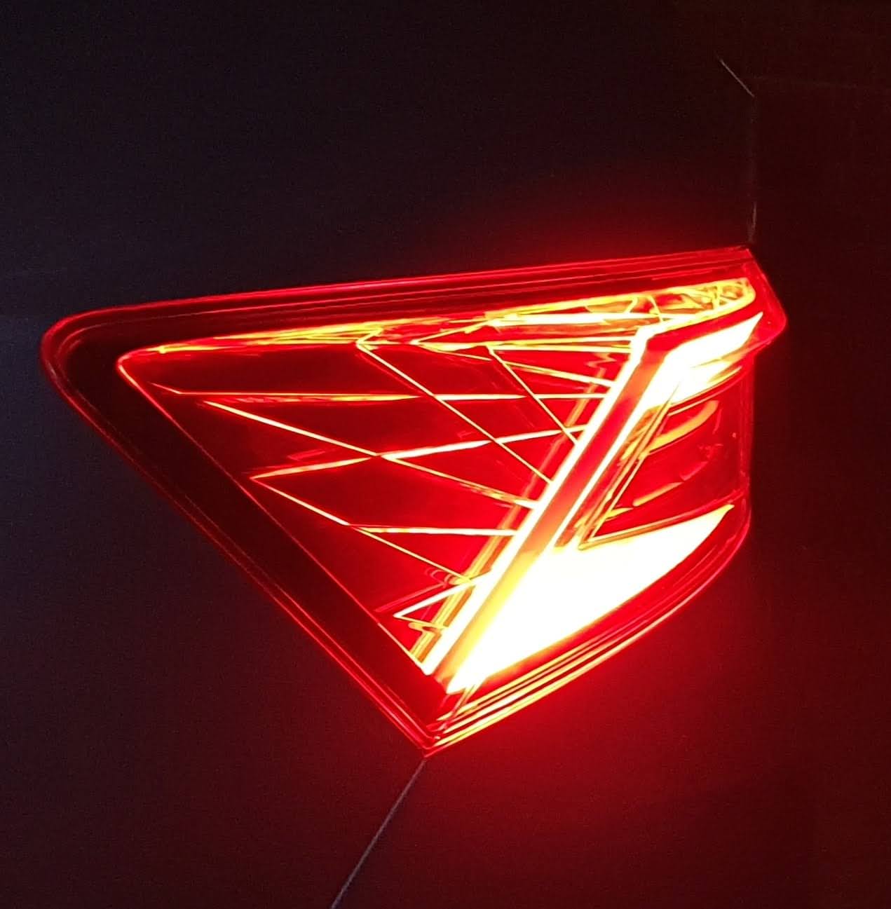

  3. Hi @Amarton I am just doing the retrofit from Bolero to Columbus, I see that there is GPS connection already in the roof aerial, so I guess it is for Telematics. I see in the electric diagram that you either connect Telematics or infotainment unit to the aerial, but could not find how they both can coexist. Were you able to solve the problem, I would love to go the original way.
