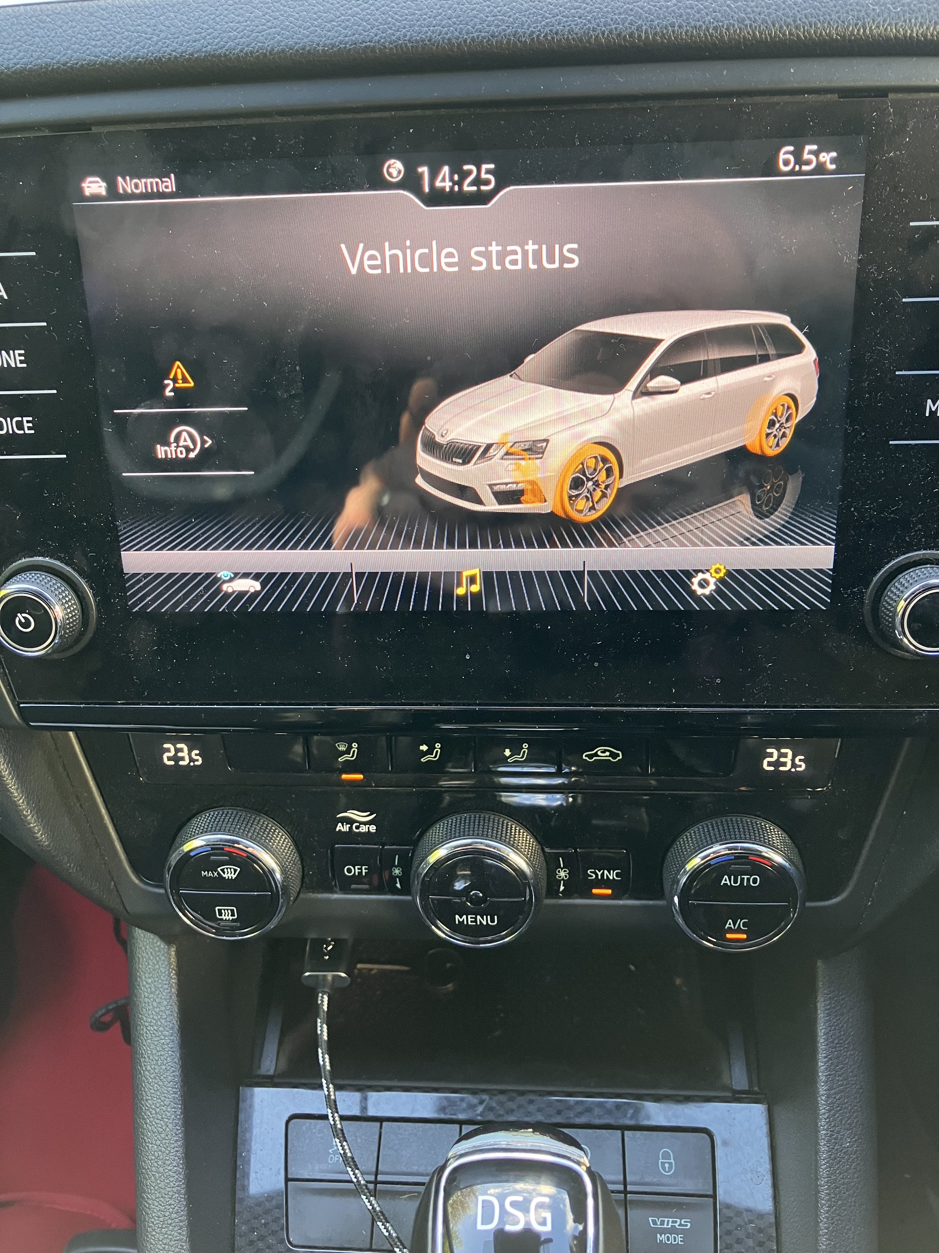

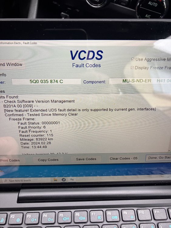

  9. Note to self * DO NOT LEAVE MY GENUINE HEXv2 vcds in my Audi TT in Uk. Here in Ireland with my MQB vrs Skoda estate,the borrowed Chinese clone ****e will spit it out. TPMS code cleared with Snap On at a local mechanics for €40. This will accept and update the genuine article only.Heres what shows on Chinese crap and cannot be corrected.Also the “Set “ function will not show on the touchscreen,I presume until a full Autoscan and clear all fault codes has been accomplished,which it won’t with a knock off. Thank you to everyone for all of your help in following this problem

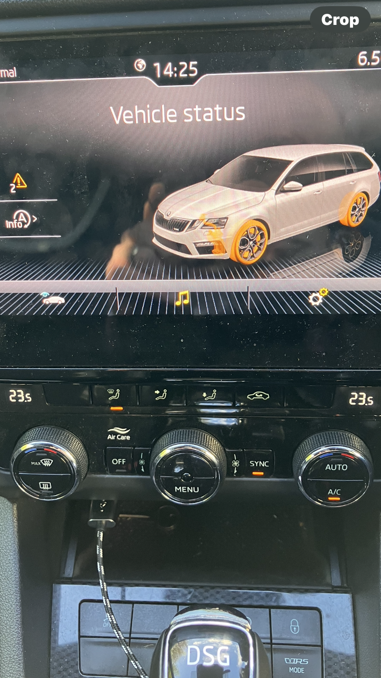

  12. Hi yes and Thank you,yes “Tyres” does show up,I touch screen that and only further option is “ winter Tyres” and I could choose to have a 60mph speed limit option for “ winter Tyres” that’s it,nothing else,no other options

  18. Yes that settings/gear icon does open up another menu( can’t remember what now but no reset TPMs😩 I did,however,work out how to use vcds and test the x4 tyre pressures and the x4 ABS sensors all gave a reading of approx 30mph,I was hoping 1 of the sensors would read at 0mph so now I don’t know where to go next Here’s a screenshot

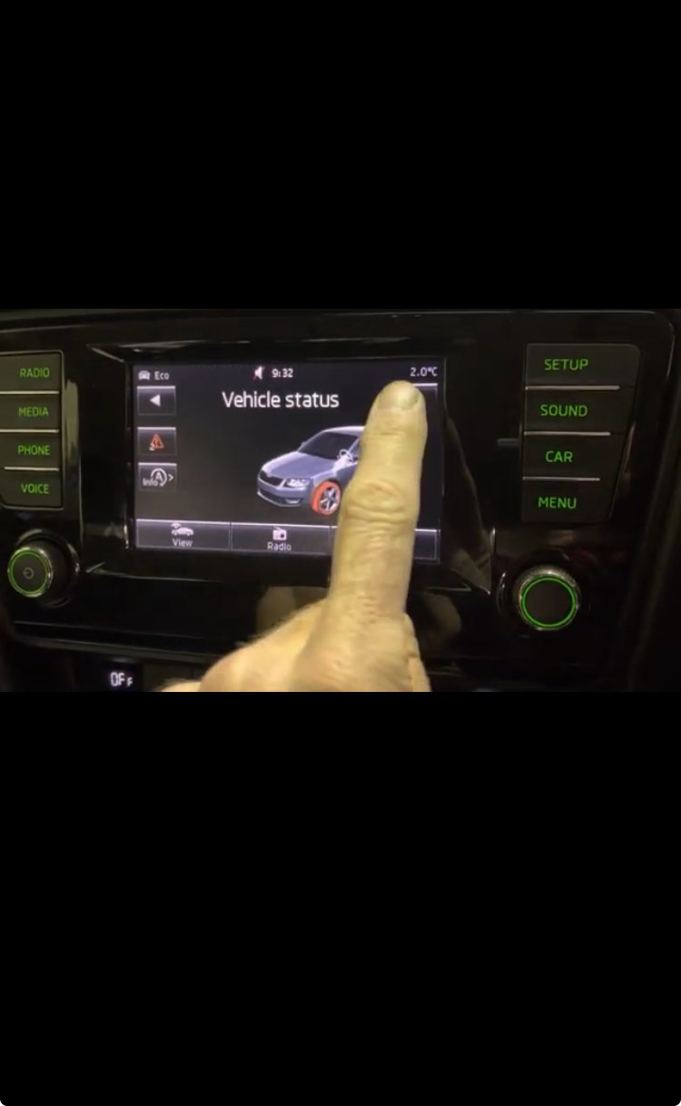

  23. Yep mines a mk3 vrs estate 5e MQB with infotainment for the reset,there is no physical button to reset TPMS anywhere on the car. photos are 1.My car 2.The above YouTube video I’ve seen before,as I was saying,there is no “Set” to touch on the top right of touchscreen to reset as in the above YouTube video,it’s just not there 😩 It did come up as ABS
