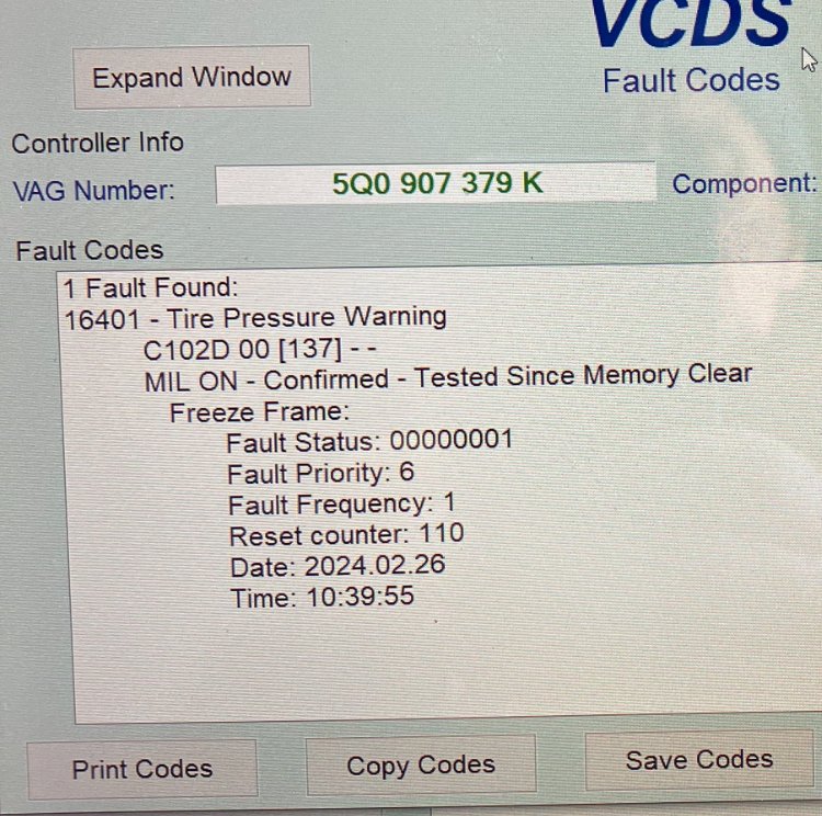

I’ve had vcds and also Autocom scanners on it,clear codes and it pops up again.

What is the code telling you?
Code is this ….

Thank you Paulski.I just checked and deffo no button in the glove box or the centre  console.Ive also cross checked the ABS long code to a log file from vcds when it happened back in August 2023.The long codes are the same 😩
As someone said earlier,I do now believe it is down to a faulty ABS sensor ( 1 of the 4) but which one is anyone’s guess,don’t see how to this is achieved if no info on the infotainment screen
If sensor at the wheel faulted, VCDS would have error in ABS module as well. That's where I'd be looking next. But given your knowledge of VCDS, I expect the autoscan has already been checked.

It did come up as ABS
