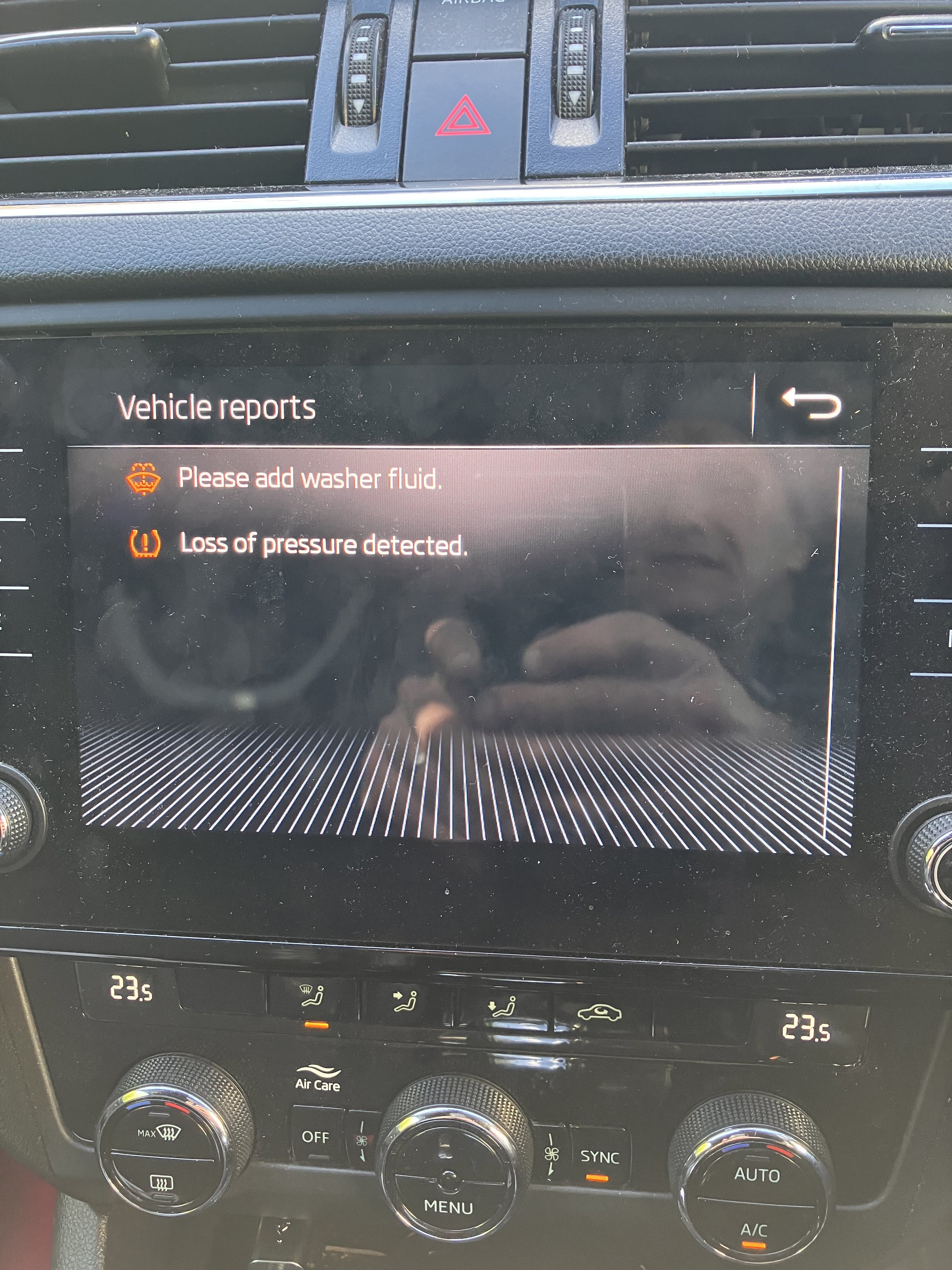

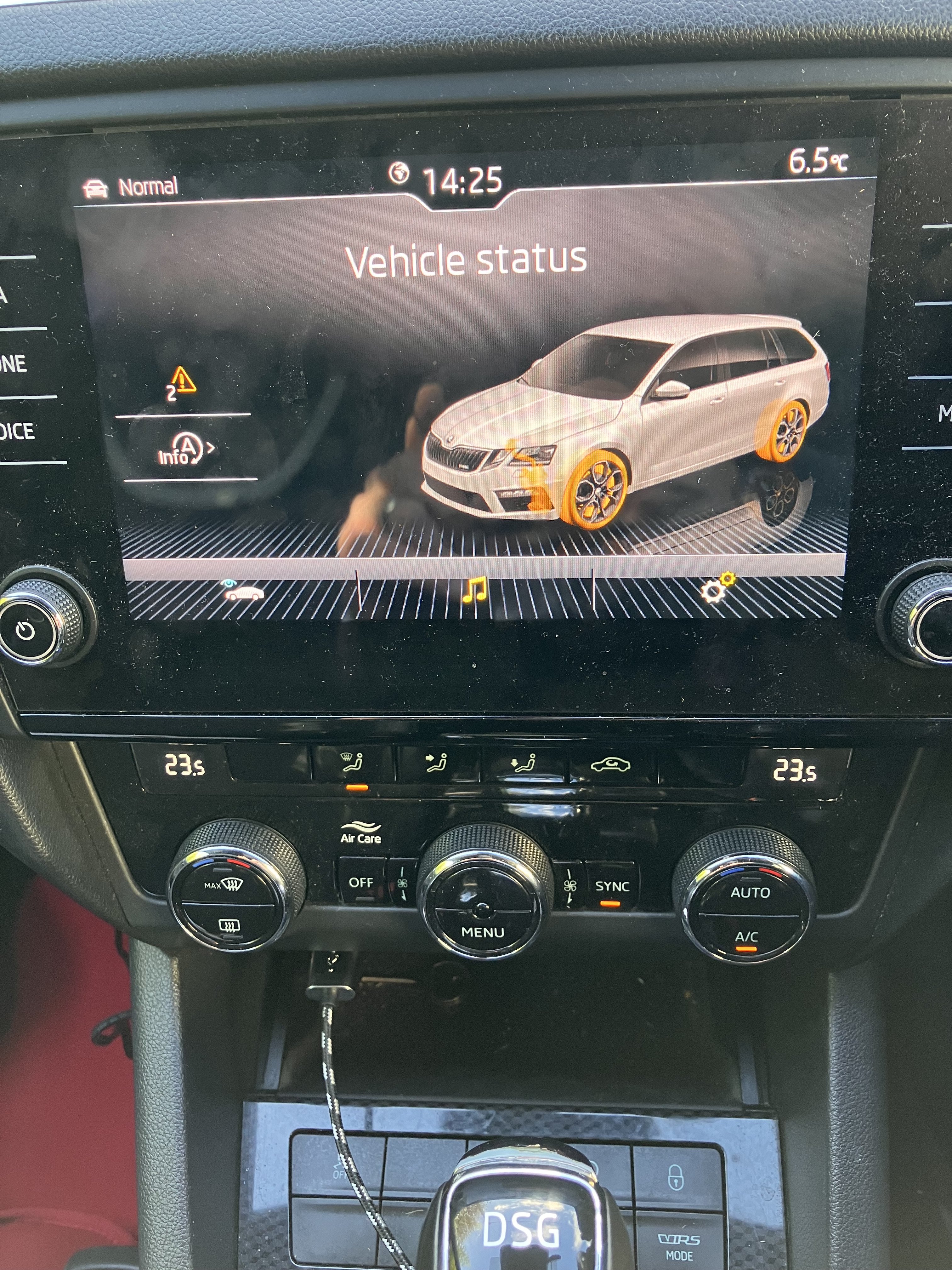

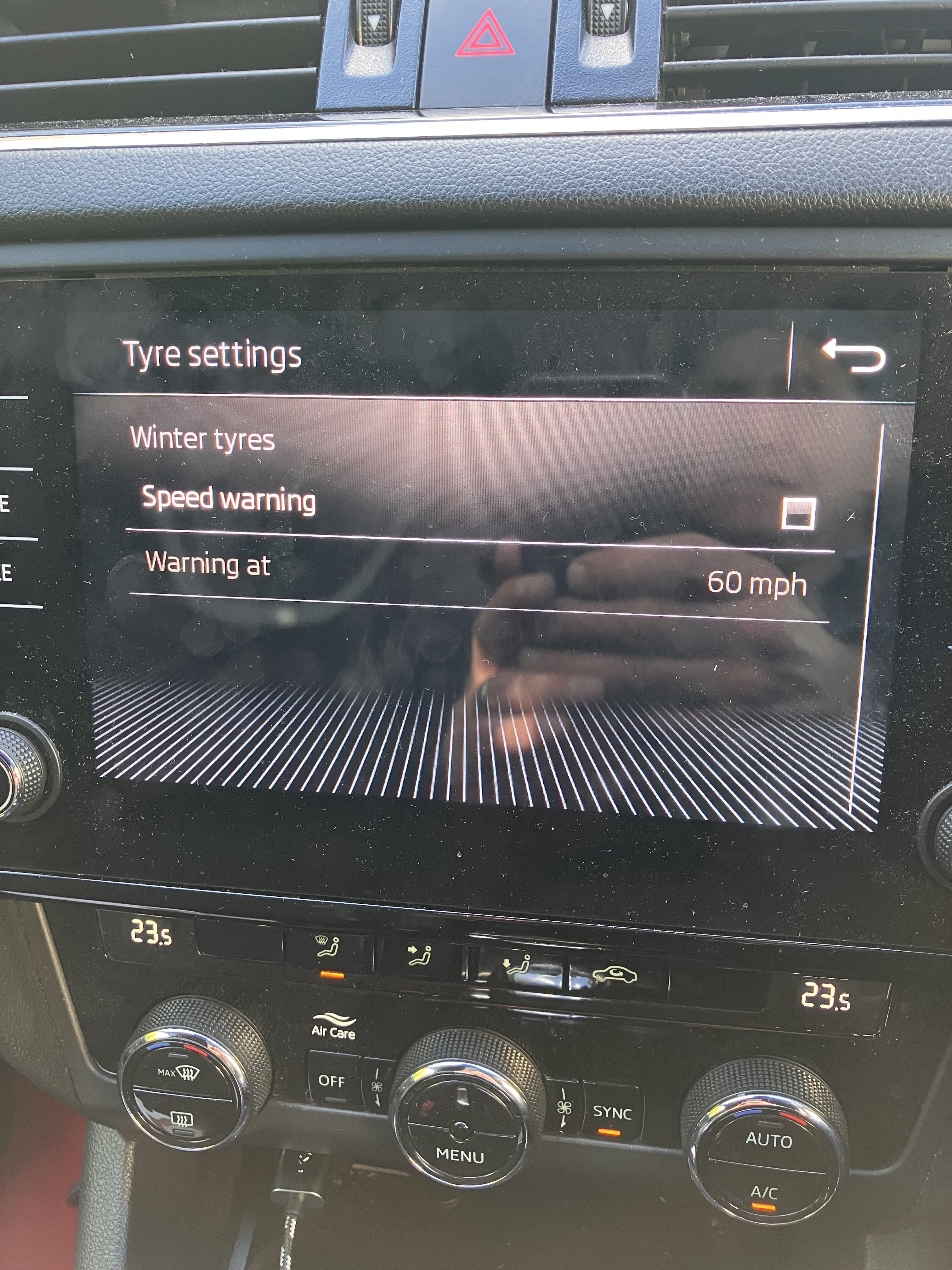

This will accept and update the genuine article only.Heres what shows on Chinese crap and cannot be corrected.Also the “Set “ function will not show on the touchscreen,I  presume until a full Autoscan and clear all fault codes has been accomplished,which it won’t with a knock off.
Thank you to everyone for all of your help in following this problem
Sometimes you have to sort problems in order! So topping the Washer Fluid first, may, and I mean, May! allow you to then 'Set' the tyre pressure!
Give it a go! it won;t hurt! 😁
