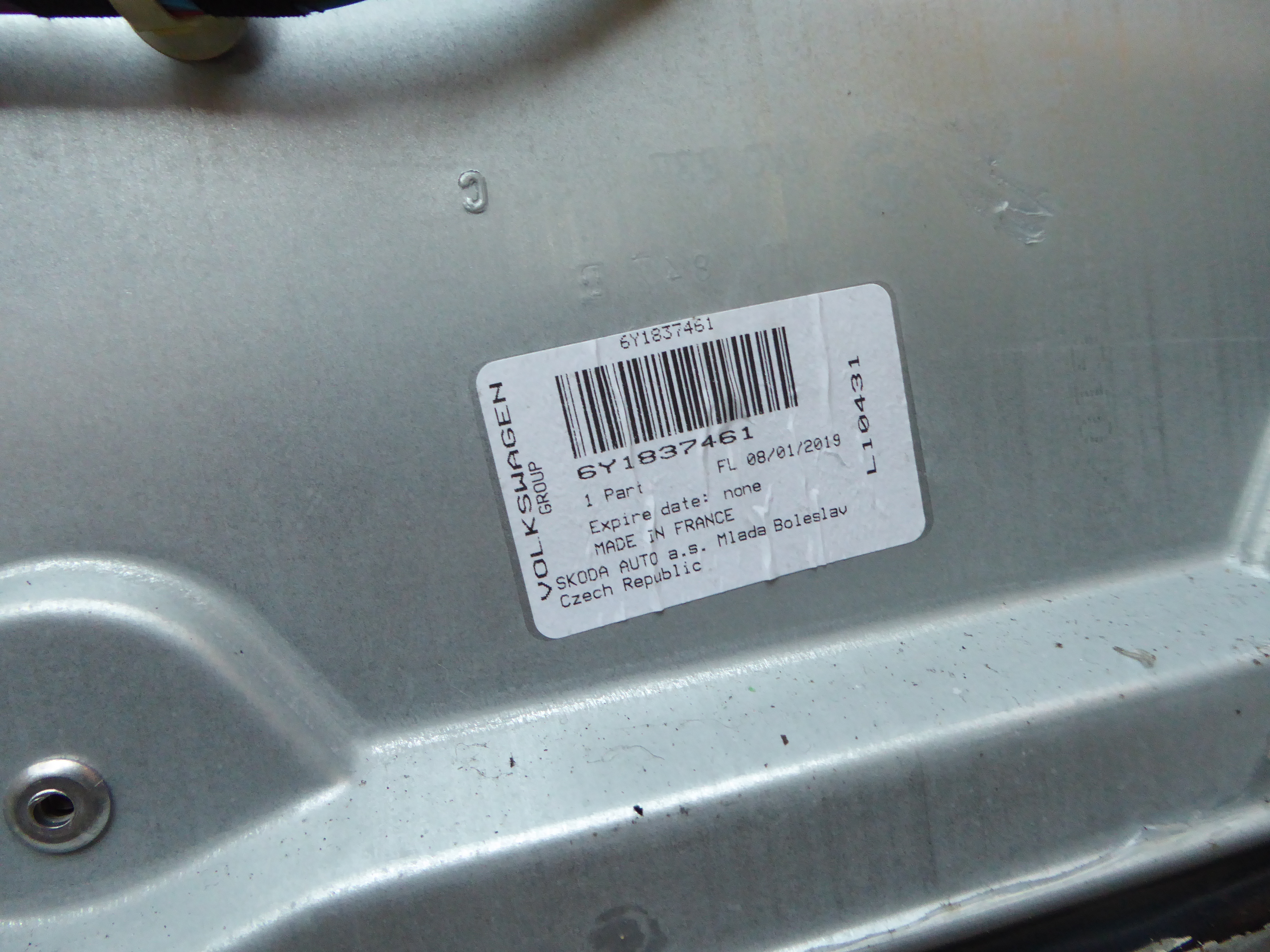

  5. I'm assuming it was built with a 6Q motor (with a new reg at some point) and the new drivers door is off a later 6Y model, hence my problems. I'm not sure the exact build date, I've put my boot sticker in that imgur album, can you tell from that?

  7. Looks like its had a new regulator too, it's still riveted in though, main dealer?
  8. Passenger motor is 6Q. I think this could be the issue!

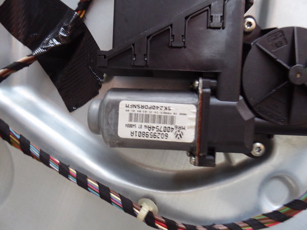

  10. They're badly lit pictures; will get some better ones tomorrow. I'm wondering if the hacked+melted mirror plug is why my mirror controls don't work, I assume since there's no plug on the motor then those controls aren't affected my mirror issues. I'm also wondering if its an issue with the door connectors. Will take the passenger side off tomorrow too and see if it's a 6Q or 6Y, if there's a mismatch then hopefully that's the issue, just got to achieve the impossible task of finding a vrs being broken south of london...
