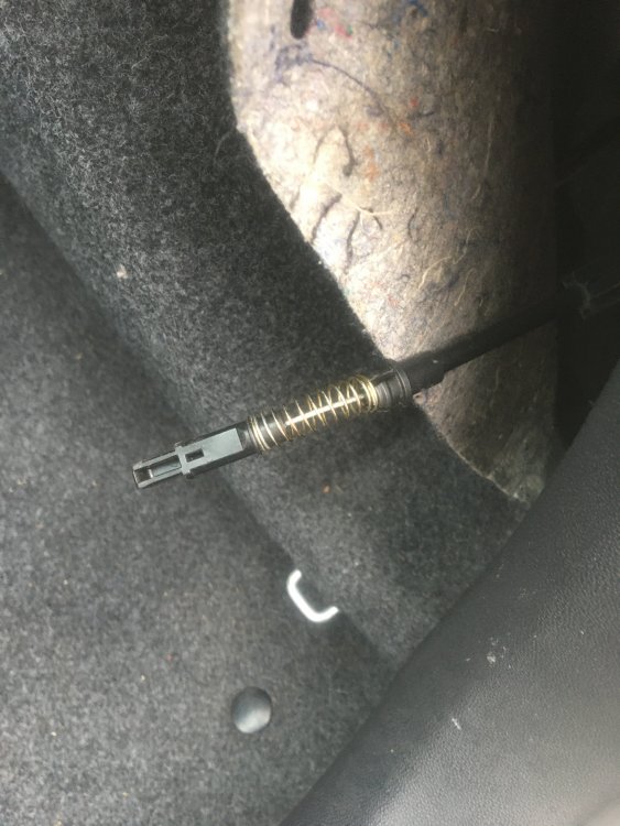

Watched a couple videos on this issue and seen the little metal spring of sorts in other cars seems to be permanently depressed on mine - will have a closer look tomorrow.

Have now stuck a zip tie around, hopefully it'll stay. Doesn't seem to have done anything. I can see the door trying to open when I pull the release level, but it just isn't able to pop open without an extra pair of hands to give it a pull. I've checked and the locking part fully retracts as well, not sure what else I can try

I can now see the little locking part retract, but the door still doesn't 'spring' open so when the fuel door handle is released, it just re locks. Any ideas? Grow an extra long limb to pull the flap and release level simultaneously?

Didn't have it oriented properly - cheers!

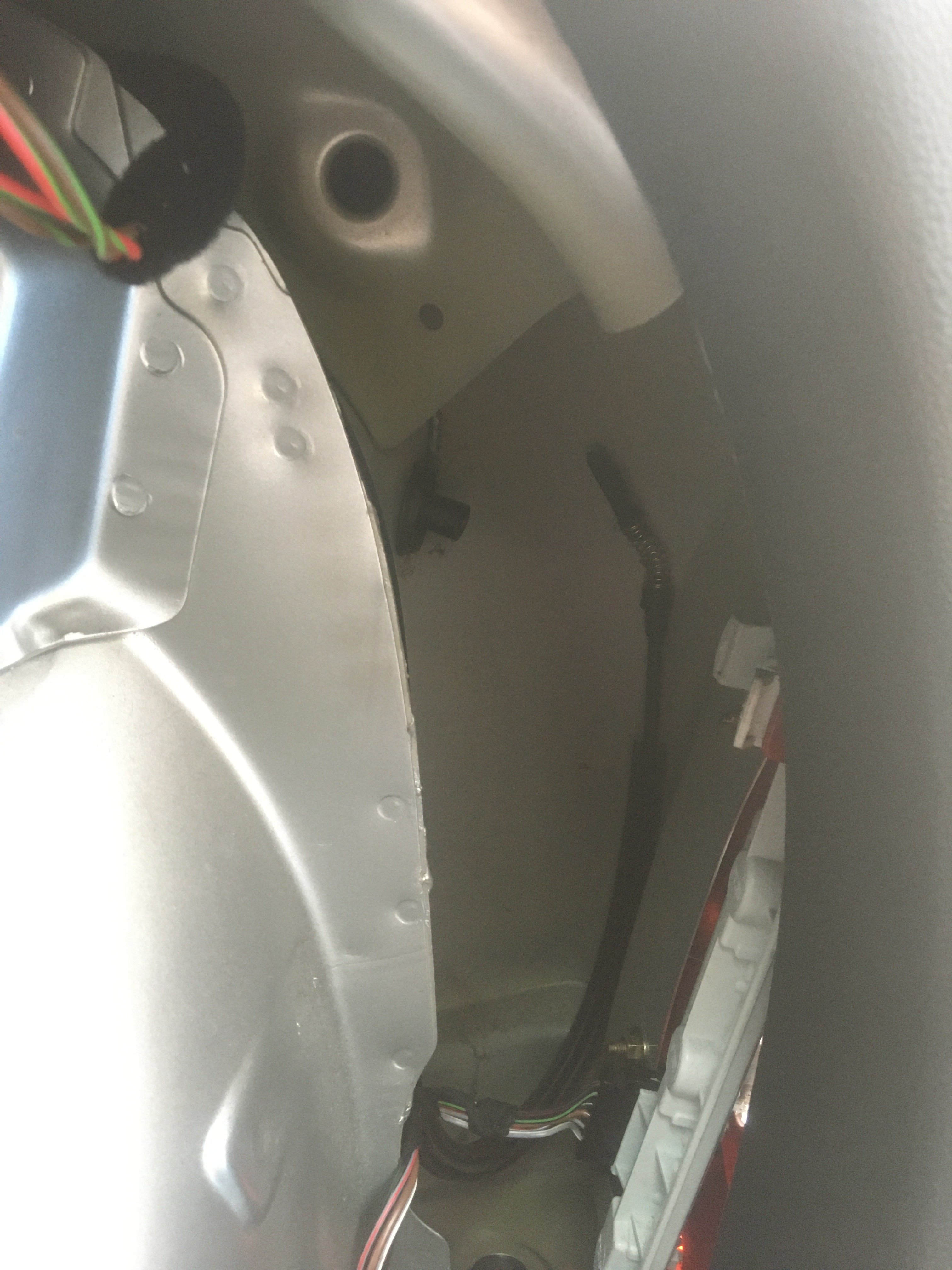

Hi all, recently purchased a 54 fabia vrs. One issue with it was the fuel door not locking, and after having a look on this lovely website I could see this is a common issue where a little cable has come out. Pulled aside the carpet and sure enough it had come out. However, when I locked and unlocked the car, nothing appeared to happen? I would expect the cable to retract and compress the spring, which it is not. Having the spring extending is making it impossible to replace the cable, so I’m wondering if this is defective, or I just need to use some more force
