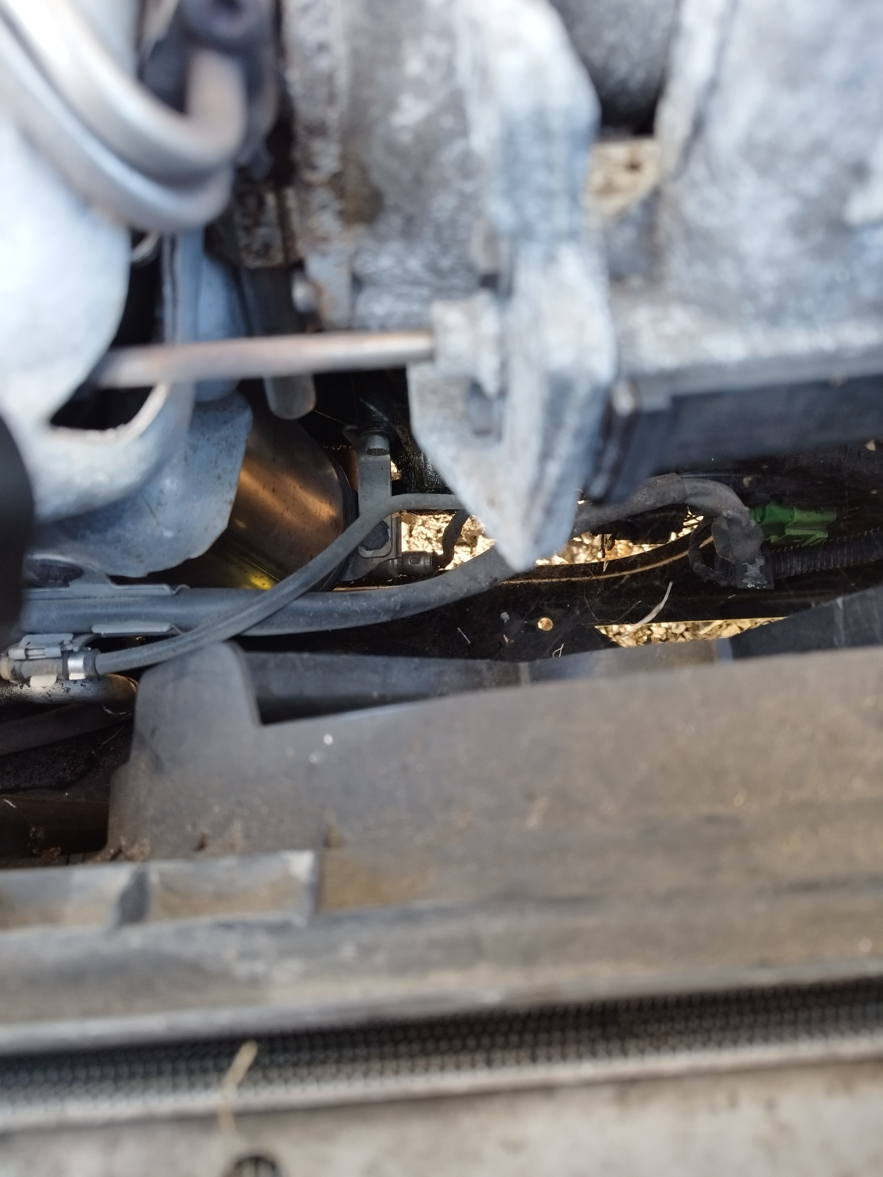

Can anyone please identify the cylindrical part just to the right of the bracket, it's the black part it's damp with coolant . Many thanks

Now the roomster 1.2tsi has coolant leaking out of what I'm assuming is the water pump. Is the water pump located just below and to the left of the battery? It's the CBZA engine 2011. If it is the pump what is the likely cost of replacement, in hours of labour and parts? Thanks for your help. Steve- WARNING! Bosch oil filters for 1.2 tsi EA111 CBZA/CBZB engines

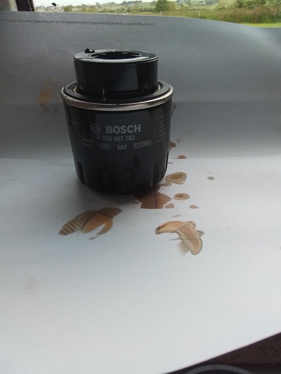

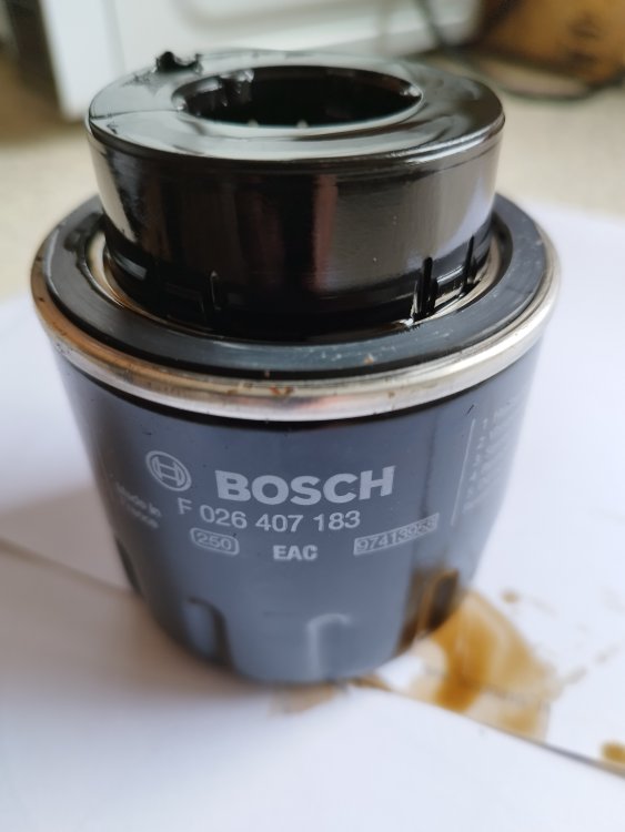

Here are a couple of pics of the Bosch F 026 407 183 which looks more like a Bosch F 026 407 181. Am I correct?- WARNING! Bosch oil filters for 1.2 tsi EA111 CBZA/CBZB engines
I changed my oil and filter last week and my 1.2tsi CBZA engine has been making a knocking rattling noise occasionally. It starts up quiet and makes the noise when hot and ticking over, a few revs and it quietens down again. It doesn't do it all the while. I've had my head in tatters with trying to figure out what went wrong. Thought it was the oil. I purchased oil and filter from Micksgarage.com based in Dublin. It was a Bosch F 026 407 183 it indeed has that on the box and printed on the filter itself. So have taken the oil filter out and it is indeed a Bosch F 026 407 181 , incorrectly labelled as a 183, as you describe without the rubber thingy. I have only done a couple of hundred miles with this wrong filter , just hope no long term damage. Thank you Xman for alerting us all to this Bosch **** up mess, which could have proven expensive.- Roomster 2011 1.2tsi 86hp
