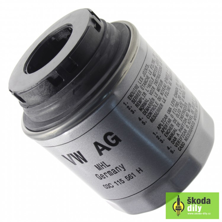

This warning applies to all models fitted with the 1.2tsi EA111 chaincam engines, includes Fabia, Octavia,Yeti, Rapid, Spaceback maybe some others. Also a wide range of other VAG models VW, Seat, Audi with the 1.2tsi engines

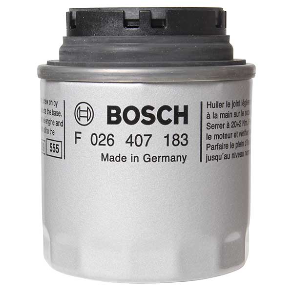

Today I picked up a Bosch Filter from Eurocarparts for our 2011 1.2tsi Octavia. Checked it before leaving the shop and it is the wrong style of filter. The sealing arrangement on this Bosch filter is for the 1.4tsi engine and is NOT suitable for the 1.2tsi. Also it is a Black filter and not Silver indicating it has a paper filter element and not the synthetic filter that is specified for tsi engines and is the only type suitable for an extended serivce regime (2yr/18600 miles)
Bosch filters are rebranded filters made by other manufacturers and have appeared in this case to have changed from MANN made in Germany to another manufacturer now made in France.
MANN filters being the OE manufacturer for VAG supplying VAG branded filters to dealers.
This may explain the issue experience of @Dazl1212 and his knocking engine
Now I know he definitely had the incorrect filter type fitted. So probably had low oil pressure damaging his engine. He ended up getting shut of his car
Bosch evidently have not checked their new supplier is shipping the correct part. They are using the 1.2tsi part no but supplying a 1.4tsi part.

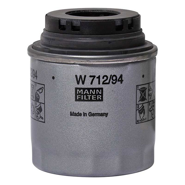

What it should look like, note the rubber sleeve
This is what the Bosch filter ECP supplied looked like except it was in Black and had the 1.2tsi part no printed on the box501440477.jpg.9599507fb6098c047cb427075cf53ce8.jpg
For reference this is the correct MANN OE filter That sleeve is important. Even Mahle in their video I posted elsewhere warn not to confuse the 2 filter styles.
Genuine VAG filter

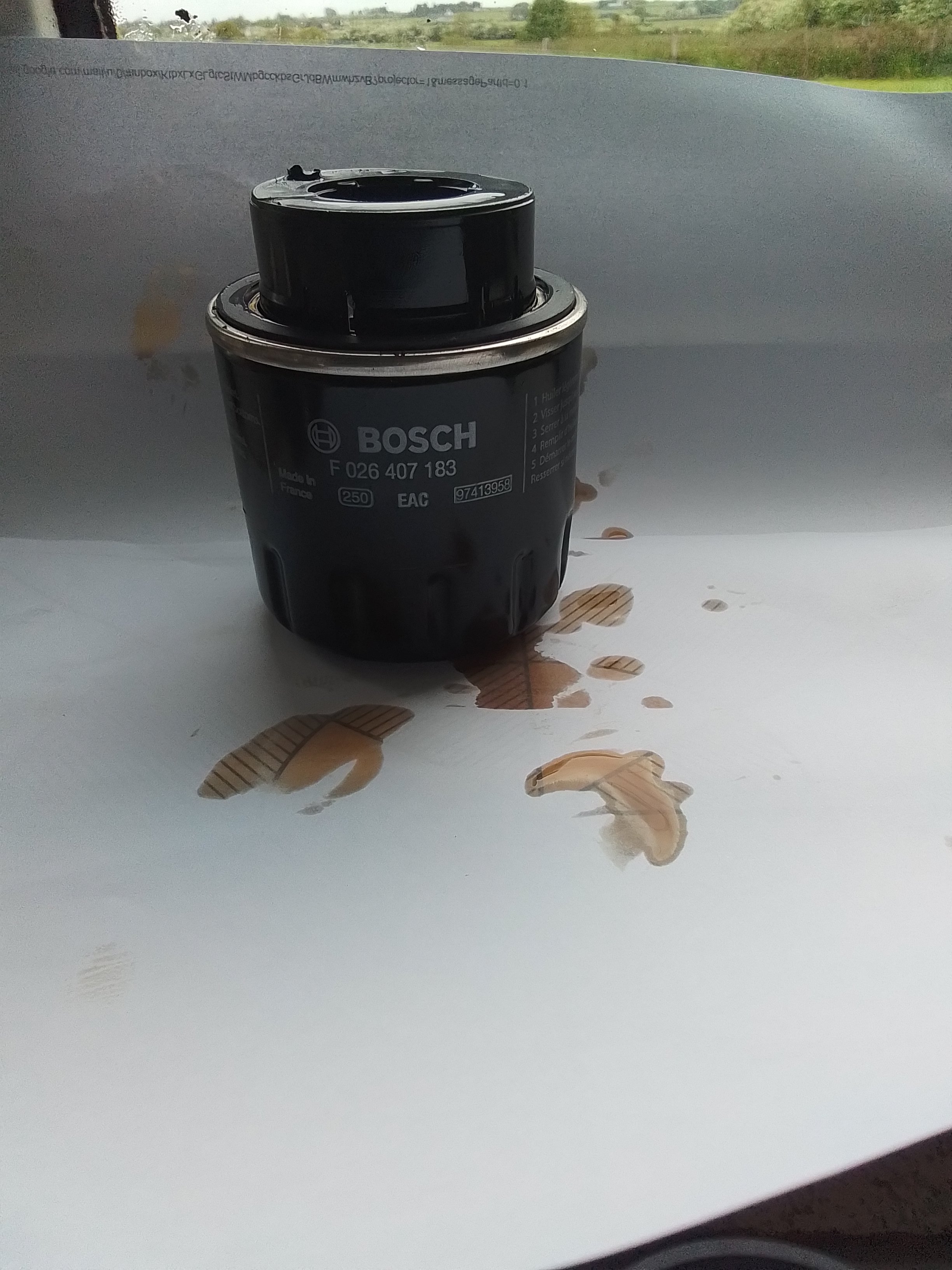

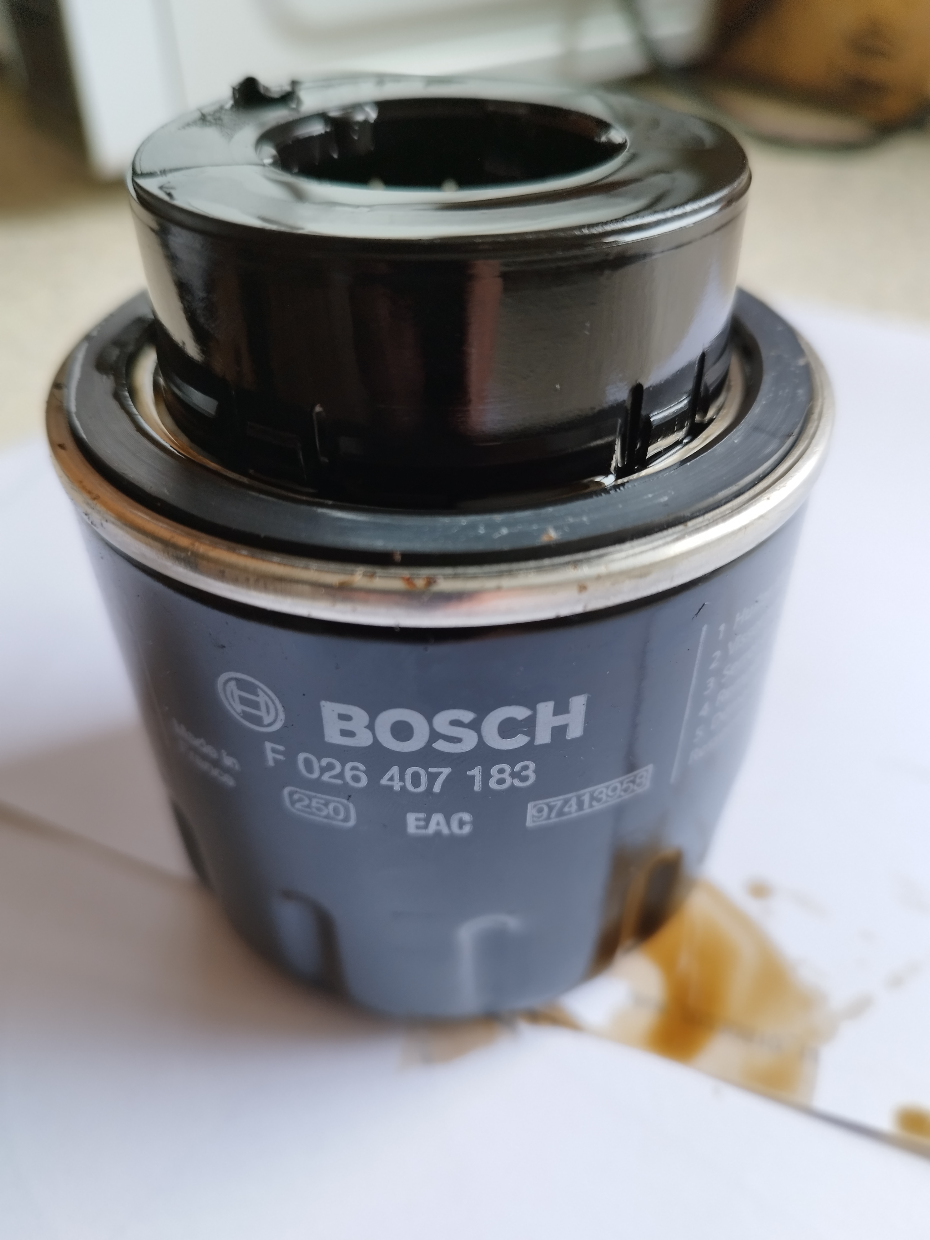

I changed my oil and filter last week and my 1.2tsi CBZA engine has been making a knocking rattling noise occasionally. It starts up quiet and makes the noise when hot and ticking over, a few revs and it quietens down again. It doesn't do it all the while. I've had my head in tatters with trying to figure out what went wrong. Thought it was the oil.
I purchased oil and filter from Micksgarage.com based in Dublin. It was a Bosch F 026 407 183 it indeed has that on the box and printed on the filter itself. So have taken the oil filter out and it is indeed a Bosch F 026 407 181 , incorrectly labelled as a 183, as you describe without the rubber thingy.
I have only done a couple of hundred miles with this wrong filter , just hope no long term damage.
Thank you Xman for alerting us all to this Bosch **** up mess, which could have proven expensive.
Here are a couple of pics of the Bosch F 026 407 183 which looks more like a Bosch F 026 407 181. Am I correct?
Yes that reflects my experience. Bosch are at fault here. I think youll also find that supplied filter is much smaller than either the correct or the incorrect 1.4tsi spec part should be. So definitely not OE spec.

Some info from the parts catalogue that may be of interest to folks with this engine.
Part number for genuine filter for CBZA/CBZB engined mk2 Fabia built up to 08/03/2010 was 03C115561B, which was dropped on 1st Dec 2013 in favour of 03C115561J, currently retailing at £15.86 inc VAT from Skoda dealerships.
For same engines in Fabias built from 09/03/2010, the original part number was 03C115561D, dropped on 1st April 2014, replaced by 03C115561H, £13.56 inc VAT currently.
If you're not sure which side of these build dates your car was manufactured, message me with your VIN and I can check.
Edit: by the way, looking at those two current part numbers, those who have been ill-advised about how VW Group part numbers work might be tempted to get completely the wrong idea and think "J comes after H in the alphabet so that must be the latest, best version to use for the later cars". That is not how VW Group part numbers work, see here: A common error with VAG part numbers - Handy Topics & Guides - BRISKODA
You need the correct part number for the build date of the car, not something 'close'.

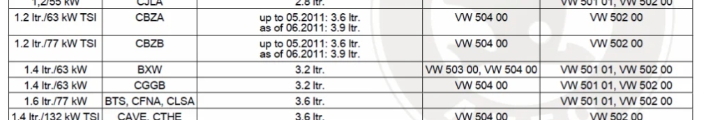

This is the date of the change is it not?
 June 2011.
The information I gave is from the parts catalogue, about (oil filter) part numbers. Yours appears to be about fill volume. Not necessarily any correlation. In fact, judging by your dates, there isn't any.

The part number of the dipstick changed at the time of your info, up to 25/05/2011 it was 03F115611D;
03F115611E from the next day onwards. That seems more relevant to your info.
Looks like you've overtightened that filter and so damaged the draindown seal. That in itself leads to low oil pressure. Hand tight only, don't overdo it! On no account use a tool to tighten it.

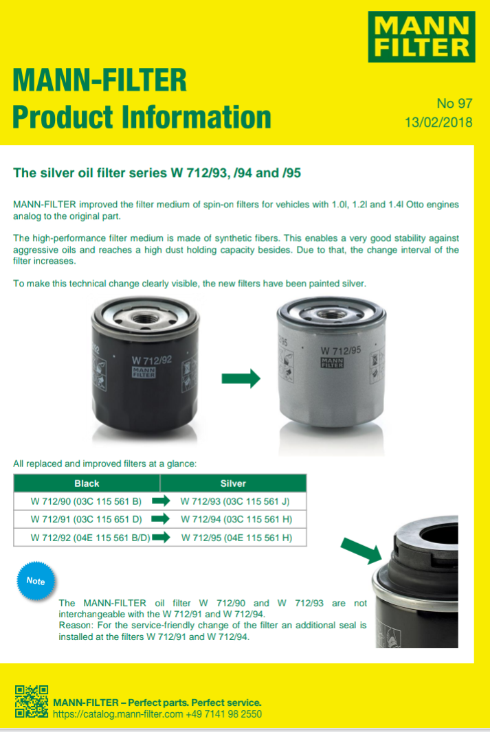

The change to the non drip Silver filters were that summer.
The members that reported issues with dealership services and the wrong oil filters fitted to there 1.2 tsi's were in 2012.
Google images of genuine filters of the two part numbers I've given appear silver in both cases. not sure what the difference is, but there clearly is one, or they'd have the same part number.
Xman, yes only ever hand tighten the oil filter and lube up the rubber seal and clean the metal surface it sits on. Perhaps I'll just tighten it finger tight in the future. But surely that's academic if it's the wrong filter? I've  now ordered a Mann filter I'm done with Bosch.
OIL FILTER 03C115561J New Genuine Part | Deutsche Parts (deutsche-parts.co.uk)
OIL FILTER 03C115561H New Genuine Part | Deutsche Parts (deutsche-parts.co.uk)
The reason they changed to silver is to denote use of synthetic filter media
