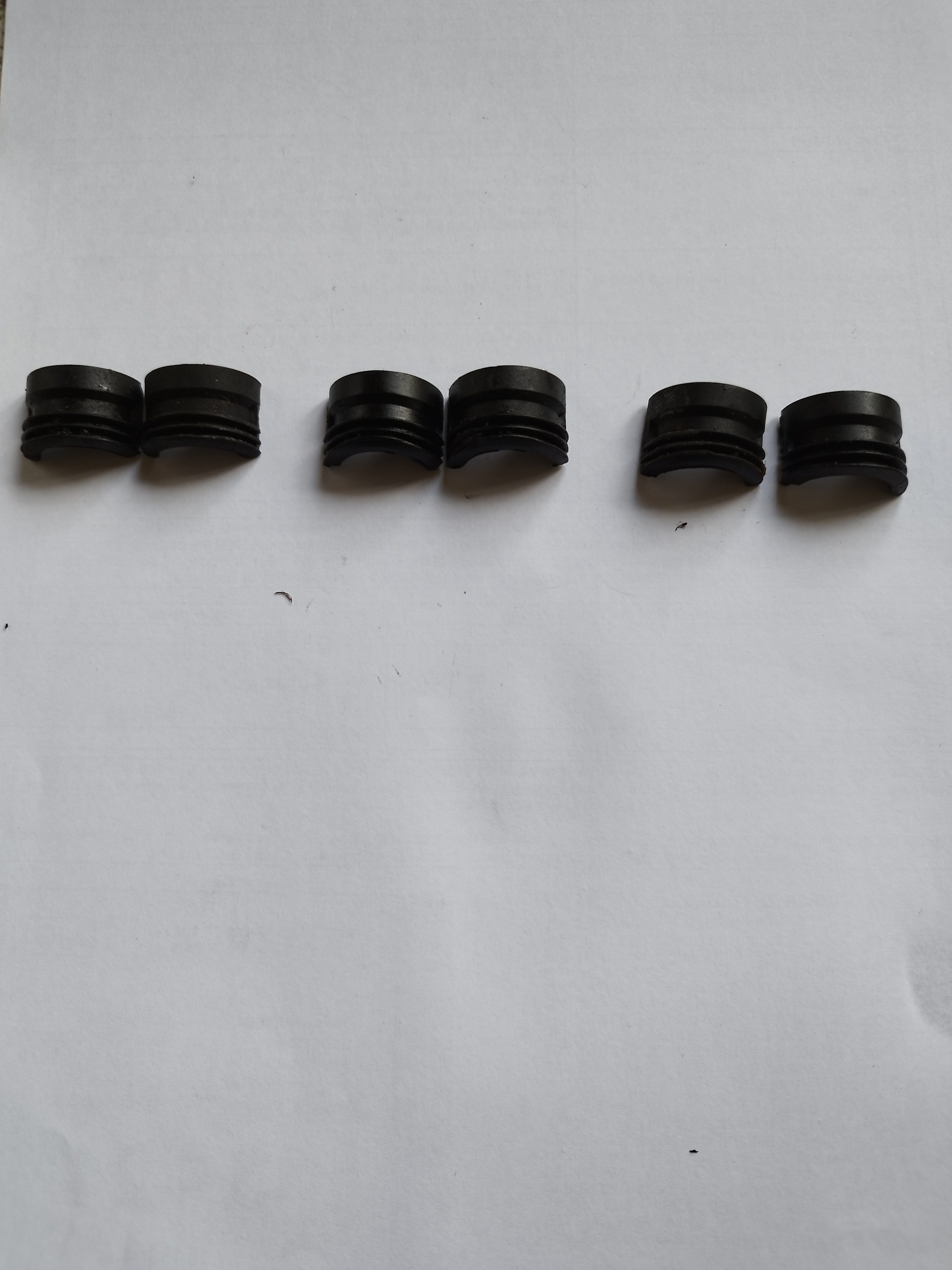

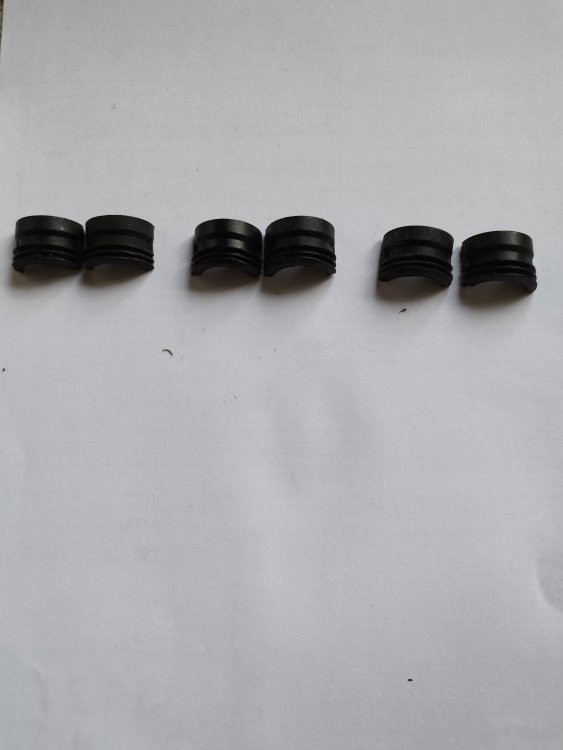

I changed the spark plugs this morning and according to the last receipt there should have been NGK plugs, but by some miracle they had Bosch written on them. Anyway, the little plastic things that are attached at the bottom of the plug lead seem to be broken, well 3 out of four. Started car anyway not expecting much it was ticking over nice and definitely quieter drove off but by the time 3rd gear it started misfiring. So have ordered new leads. Should I order a new coil as well?
Update. Ignition leads changed and it's running like a formula one car. Can't believe what difference new plugs and leads make.
