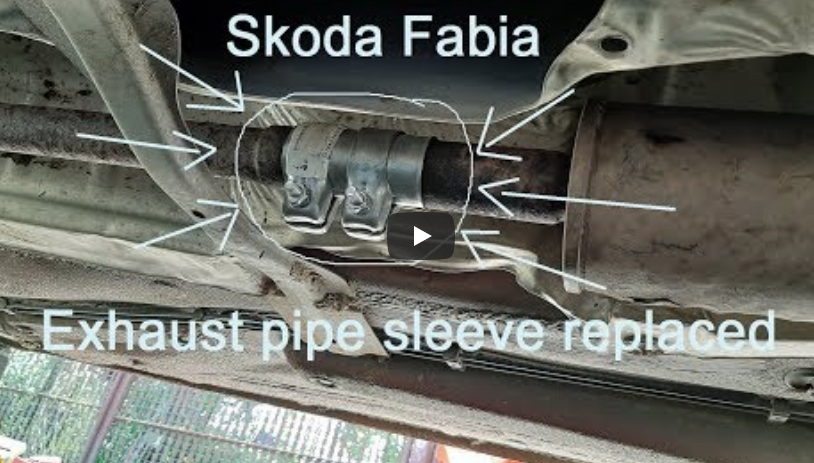

This is the blighter. Apparently they come off the production line in one piece but to replace the back box you have to cut the pipe, hence the join.

At least one of the brackets has rusted through and what with the bloke at the garage doing something to the flexpipe section, it's all come loose and the joiner's knocking and rubbing on that cross member. Looking on eBay there's one for a 2006-2007 6Y5 1.2 estate, will that be ok on a hatchback?
