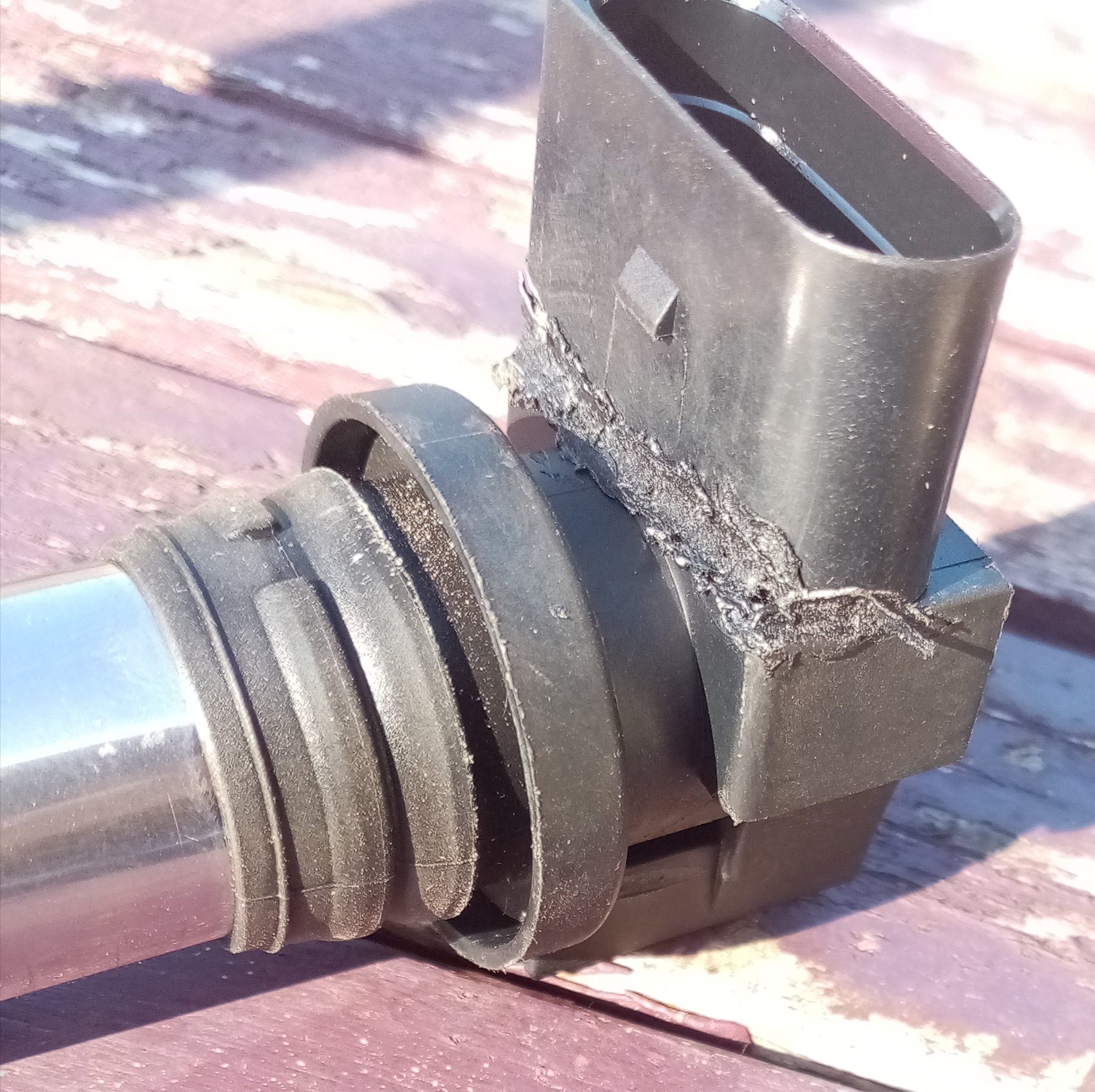

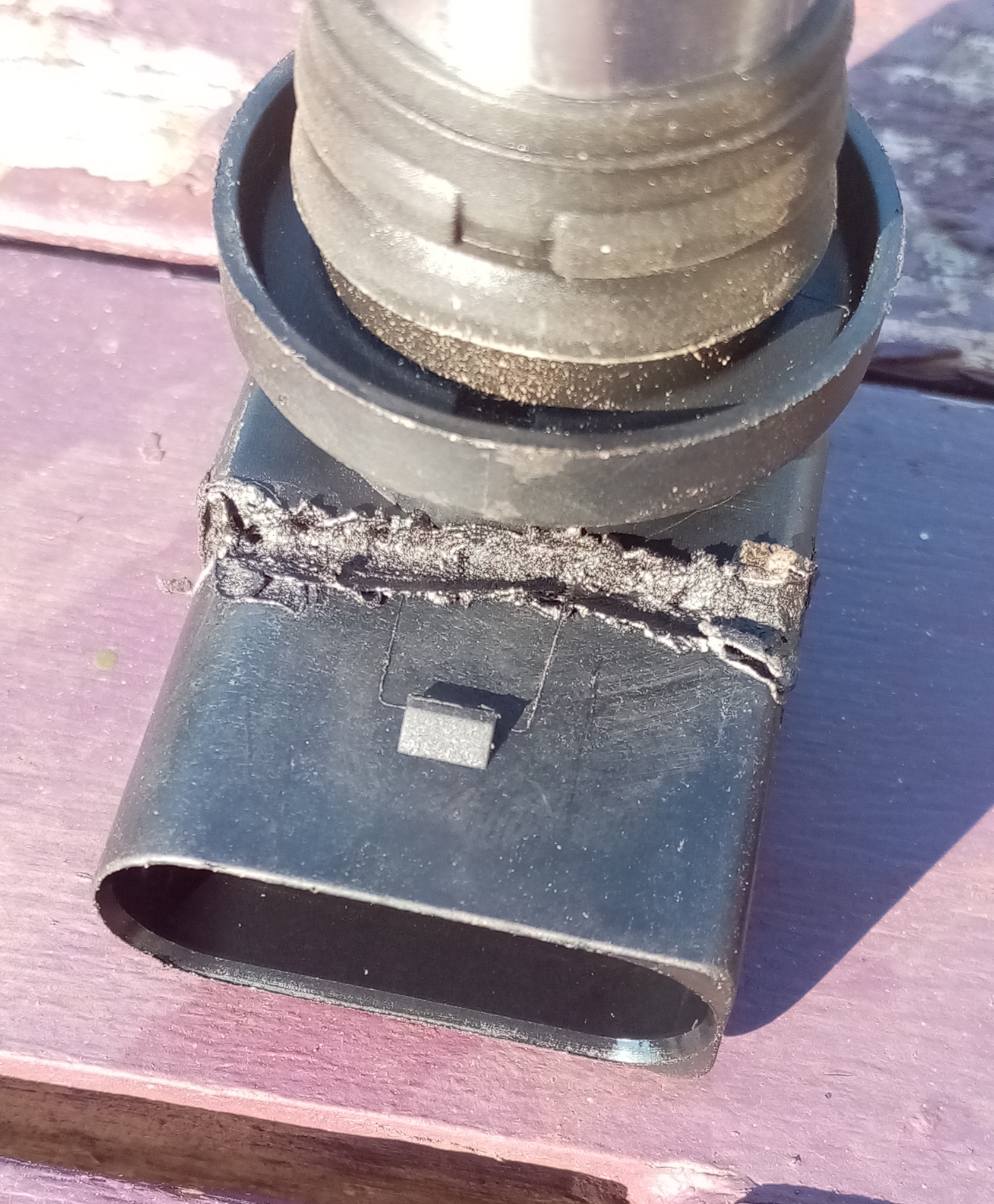

In taking spark plugs out (they looked ok, light brown electrodes etc but gap 0.9mm; replaced them anyway) middle coil looked like either it has been in contact with something hot or something has been rubbing against it. I'm inclined to think the former as the groove is rough not smooth and polished from rubbing. Wondering if it was previously in cyl 1 position and that earth wire crossing coil area has been rubbing in the past? Anyhow, that's the first coil I will swap when the spare turns up eventually.

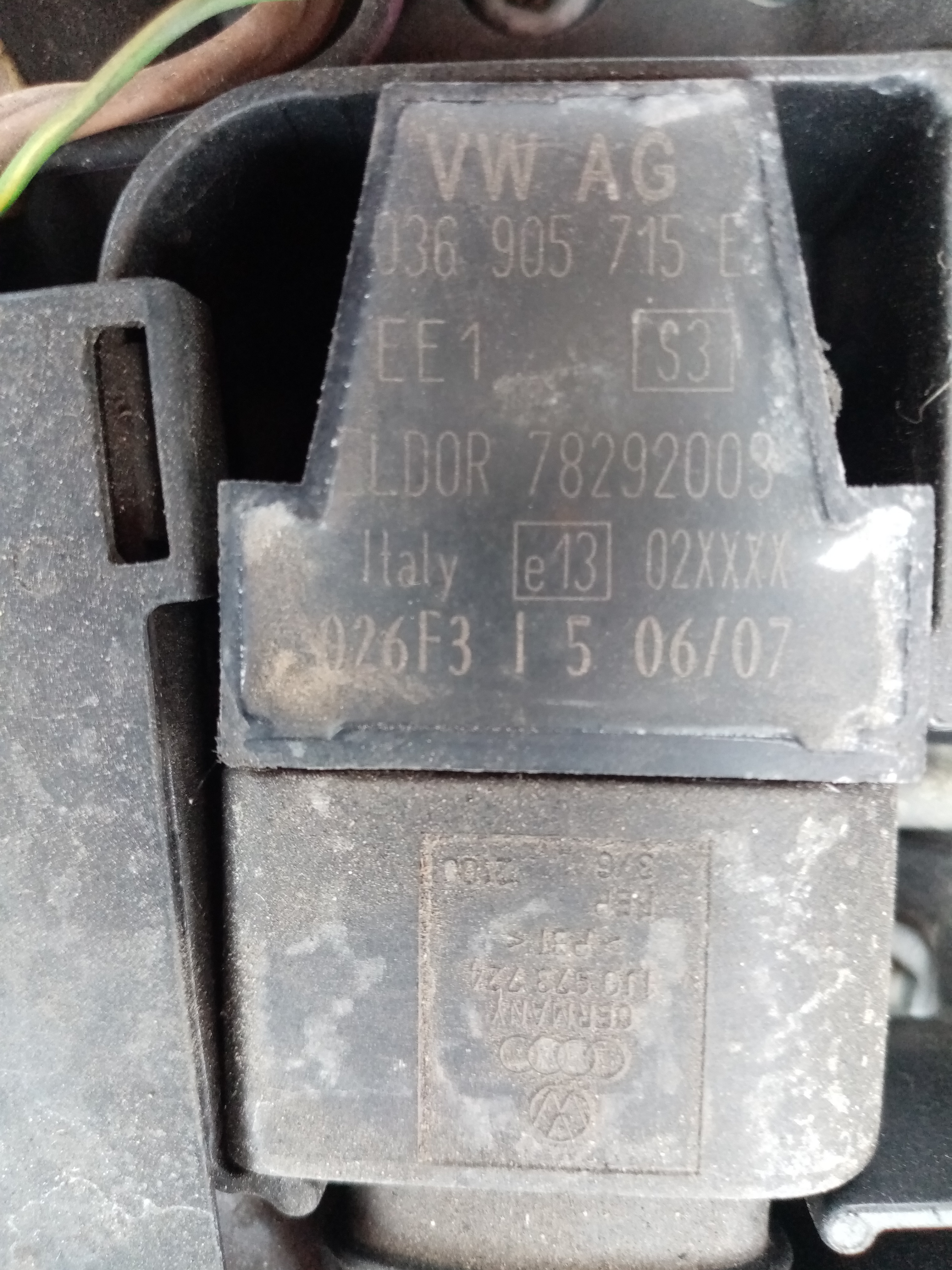

Part numbers all correspond to those listed except the coils, I've got 036905715 E on all cylinders, weird? Should I get F or E?
