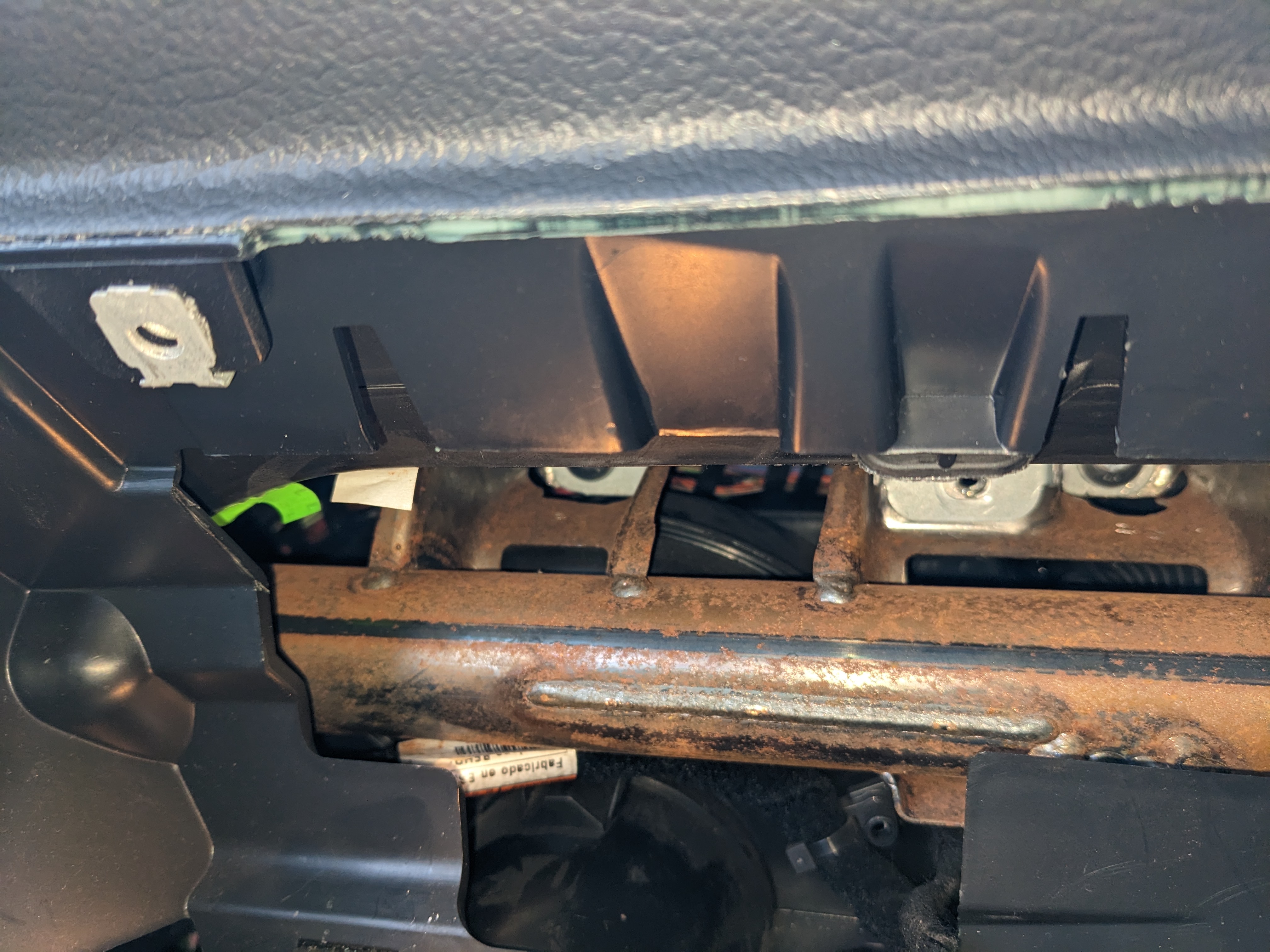

  4. This is impossible 😭 I've removed the fascia panel and the only screw I can see holding the unit in place. Someone's been here before me because the corner clips are damaged. I can't lever the unit out. There are no end of clips holding it in place but even with an extra pair of hands and both of us going at it, it will not come out. Have I missed something? I'm following the schematic and the only thing I haven't got is 2 screws at 3.1 point 5, labelled 7 on the diagram.

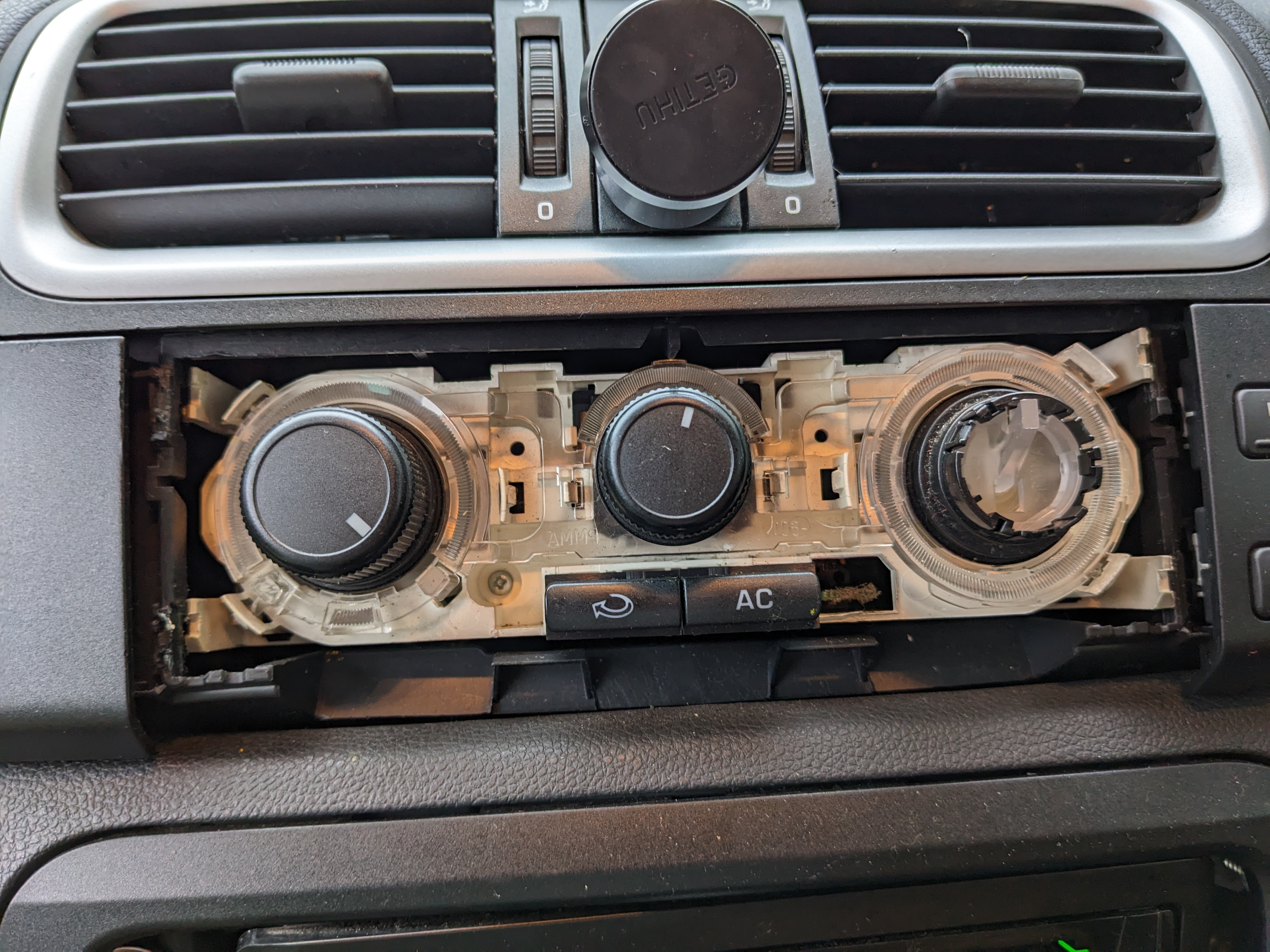

  6. Flicked cover off control panel, knobs flying off as expected. The buttons were never seated properly. Does this unit just lift out like stereo?

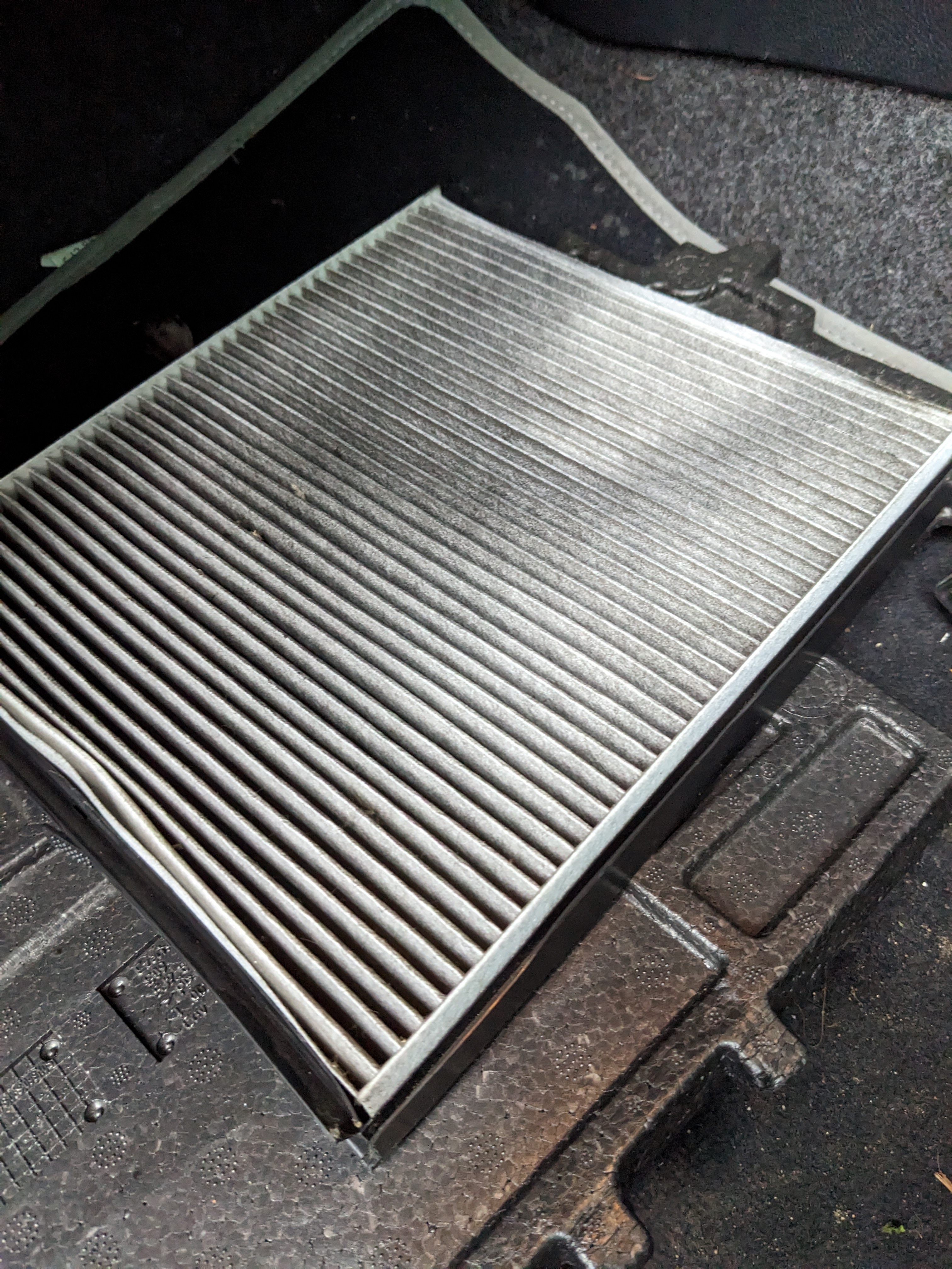

  7. Skomaz and varooom *breaking news* So I pulled cover and wadding away from under the glove box. Located and removed pollen filter, which is black, shoved hand into the fan and it's free spinning. Do I have to/ should I still remove the glove box and the fan cover? I'm hoping that by process of elimination, as the fan is free, I can focus on the switch.

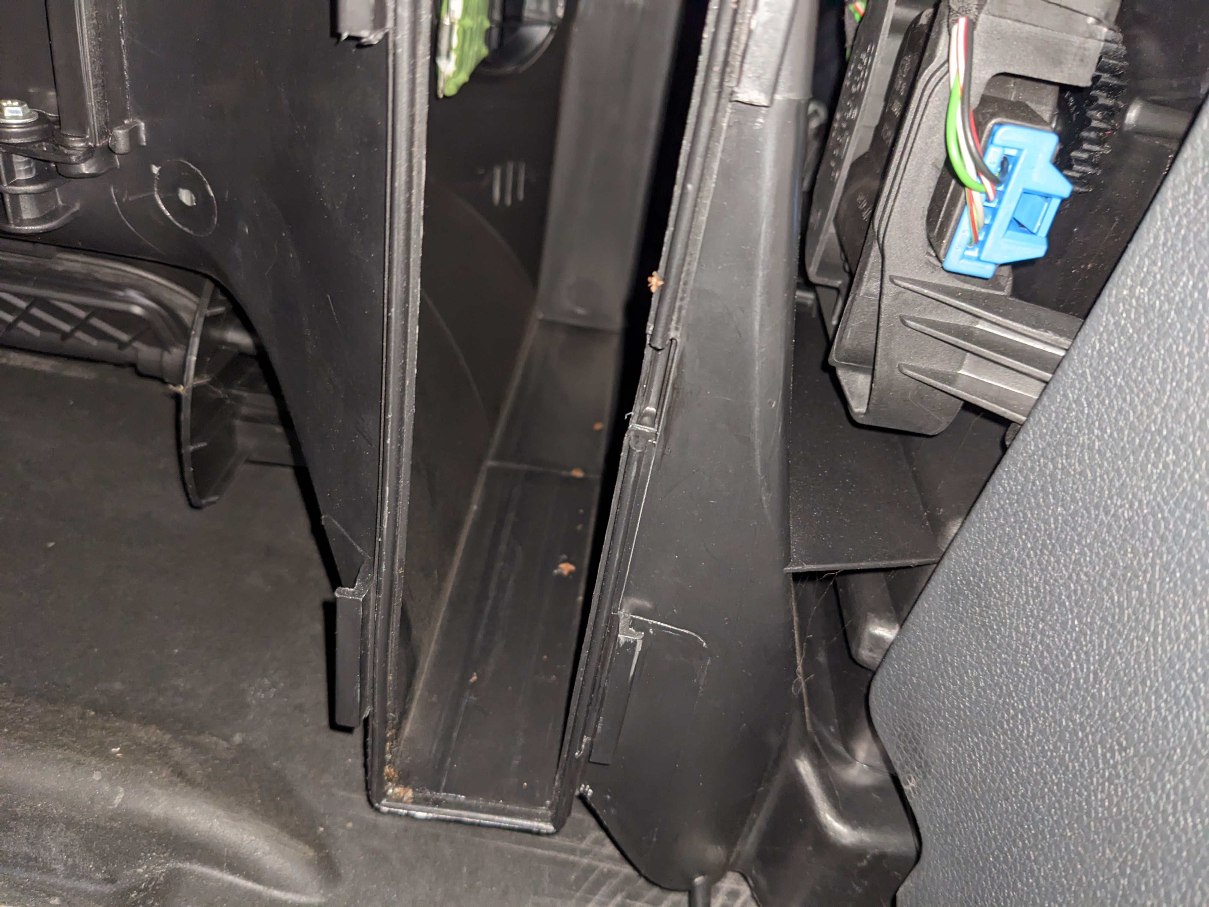

  9. Thanks nta16, from memory that's how the stereo is wired in. I wanted to replace the original radio and have a USB to charge phone. This is Halfords (apologies for swearing) handywork. I was really hoping to get away with doing the bare minimum (I'm not lazy just terrified of anything electrical) and now realise I'm going to have to spend the afternoon in the passenger footwell. I must also confess at this stage that I have only just figured out that I have a pollen filter and it's location. I'm not looking forward to removing the fan housing but can't think of an alternative. Wish me luck 🤞

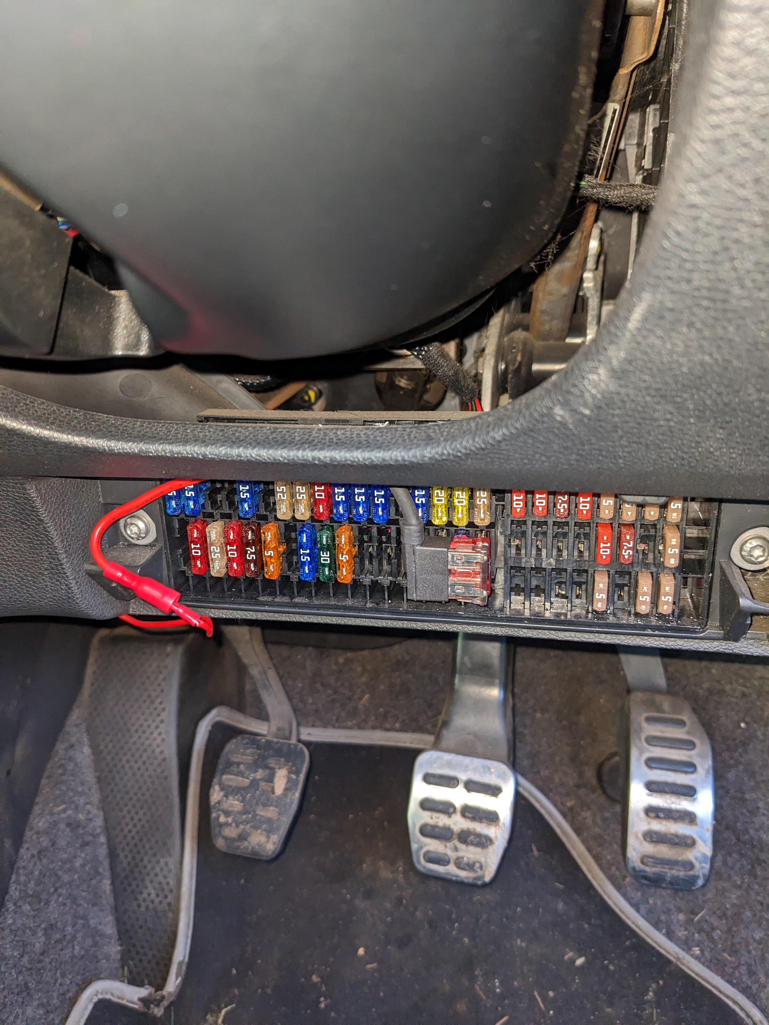

  10. Firstly Skomaz I was just looking at the fuse box for the obvious green or white fuses to try to get my bearings and work my way around from there. I hate anything to do with electrics because it's such a minefield. I've replaced the blower fuse in the position I believe is 39 and I still have no action. I'm going to attempt to follow your advice and locate the fan from the passenger footwell. Does this require removing panels?
  11. Thank you for your response KenONeill. I am aware of the left hand/right hand drive but if you have seen the picture of my fuse box, you will notice that several key fuses are missing or the wrong amp. I think I'm looking to replace 39 -blower and 42 - heated rear windscreen. Going to get on with that this morning and see how it goes. I will report the outcome later 🤞
  12. For some unknown reason my fuses do not correspond to the image on the inside cover of the box.
