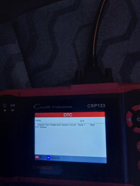

So after looking into this further, thermostat came off and tested all fine. Coolant temp sensors all fine. Rad fan is working fine. There was an issue with the water flow that that's why it didn't get the op temp properly. When the drain plug was released no anti freeze came out and when the coolant was dropped via the bottom radiator hose it was stone cold after running for 30 minute. Right now it doesn't feel like the DPF is the issue, more that the turbo isn't kicking in due to a poor fuel/air mix. The sensors around the turbo, DPF and Cat are getting tested tomorrow. When we disconnected the Lambda sensor connector the car started to read a P0135 fault which I believe is the o2 sensor.

Hi pal. When I took it in the mechanic used his tool and it flagged as Bank 1 sensor 1 which suggests upstream. The car does NOT have working AC. The plan is the keep ragging it around until Tuesday. How likely is this a DPF issue?

Thanks for getting back. The error code points directly to the lambda sensor but its fine it's rules out it being the problem but if I'm honest the issue is seemly starting to clear. I honestly think it needs a forced regeneration as it has just been doing short distance for the last year or so. I'm not sure that the rad fan is spinning either so I will be replacing the temp sensor too to see if that clears up anything

Evening all My car is throwing up the P0546 code and intermittently goes into limp mode when I put my foot down and I loose power. The code indicate the upstream Lambda sensor is the problem so I've had it replaced with an OEM part. Still the issue persists and the code remains. Does anyone have any suggestions what could be at fault? Thanks

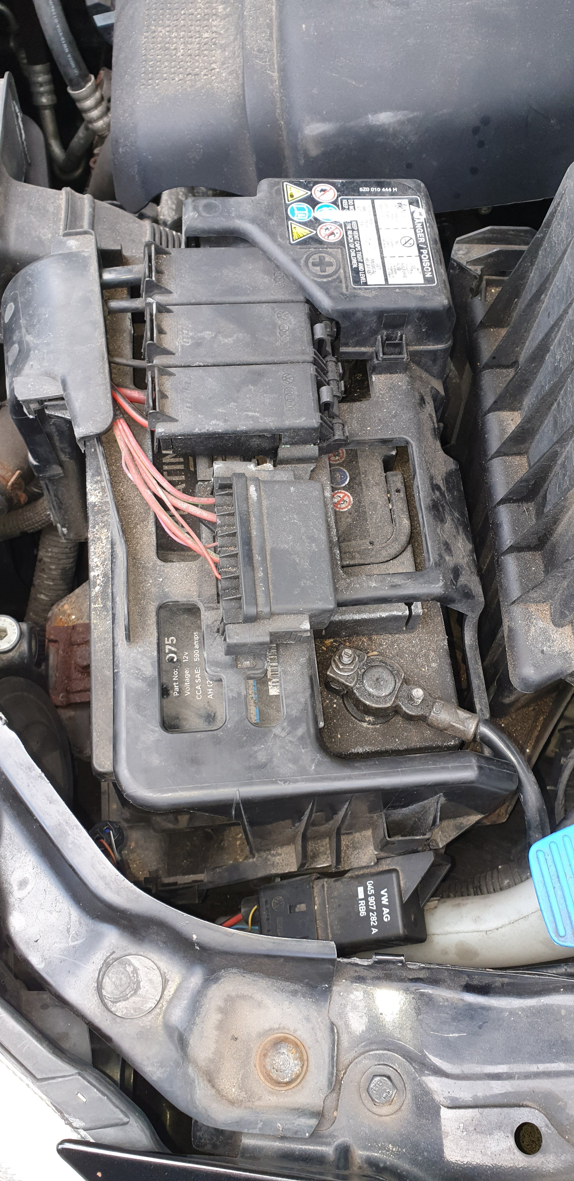

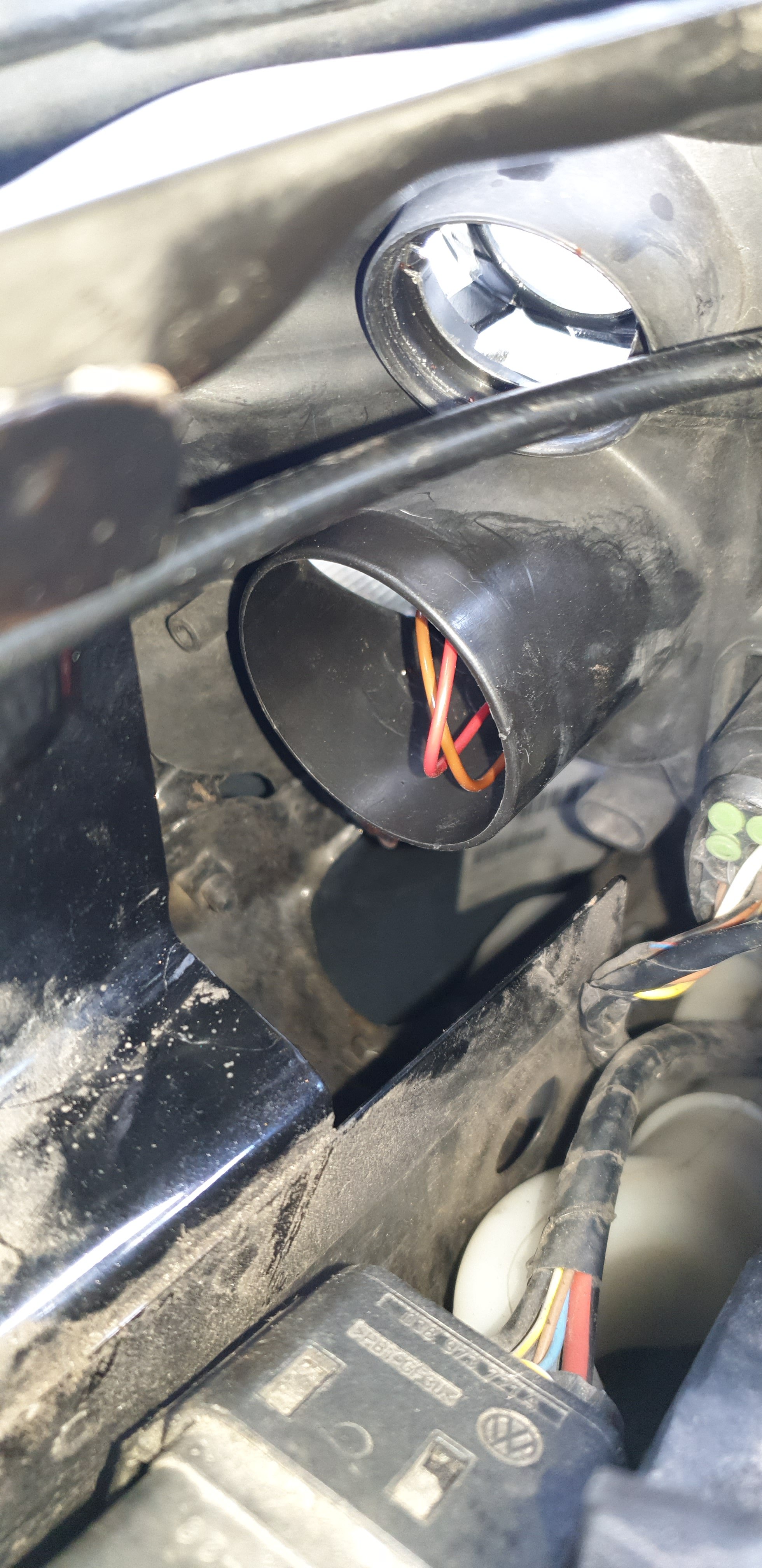

I managed it through opening the mud guard and hooked it but the bulb went into the headlight! 😂 all sorted and replaced in a not so tight fit!

Hi all I am having a lot of trouble getting the side light bulb out to replace it. As you can see I have taken the smaller rubber housing off but can not get the bulb out If it a straight pull or a twist and pull like the headlight bulb? I have tried to remove the plastics surrounding the battery to no avail. If anyone can help me out that would be great
