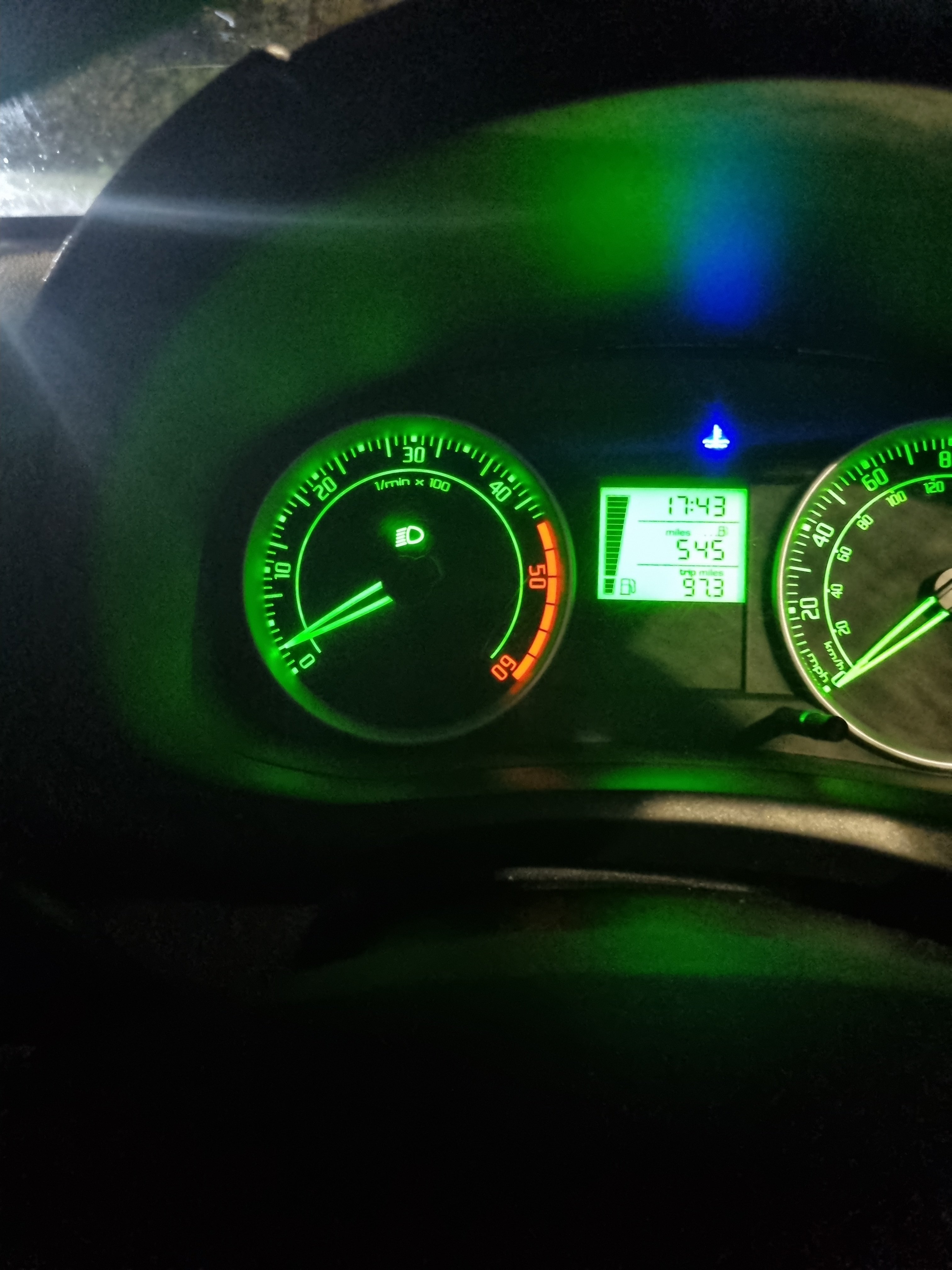

  6. In my opinion it would be easier to do a straight swap with the cluster, however it may be a wiring issue. I'm having an issue with my rev counter that I keep putting off but I fully intend on a swap rather than a repair

  13. Engine is definitely not running slowly at all. Just been out in it now. Whether the fault occurs or not the engine is fine. Could it just be the instrumental cluster being faulty?

  15. Morning guys hope you've all had a pleasant Christmas. I have noticed a niggly issue where my rev counter reads incredibly low. It seems to trigger when I am in slow moving traffic. I am not losing any power and I am fairly sure that the Throttle Pedal Sensor is just playing up. The engine doesn't seem to be labouring at all when I drive or sit idle. Am I looking in the right direction or is there something else I should be looking out for?
