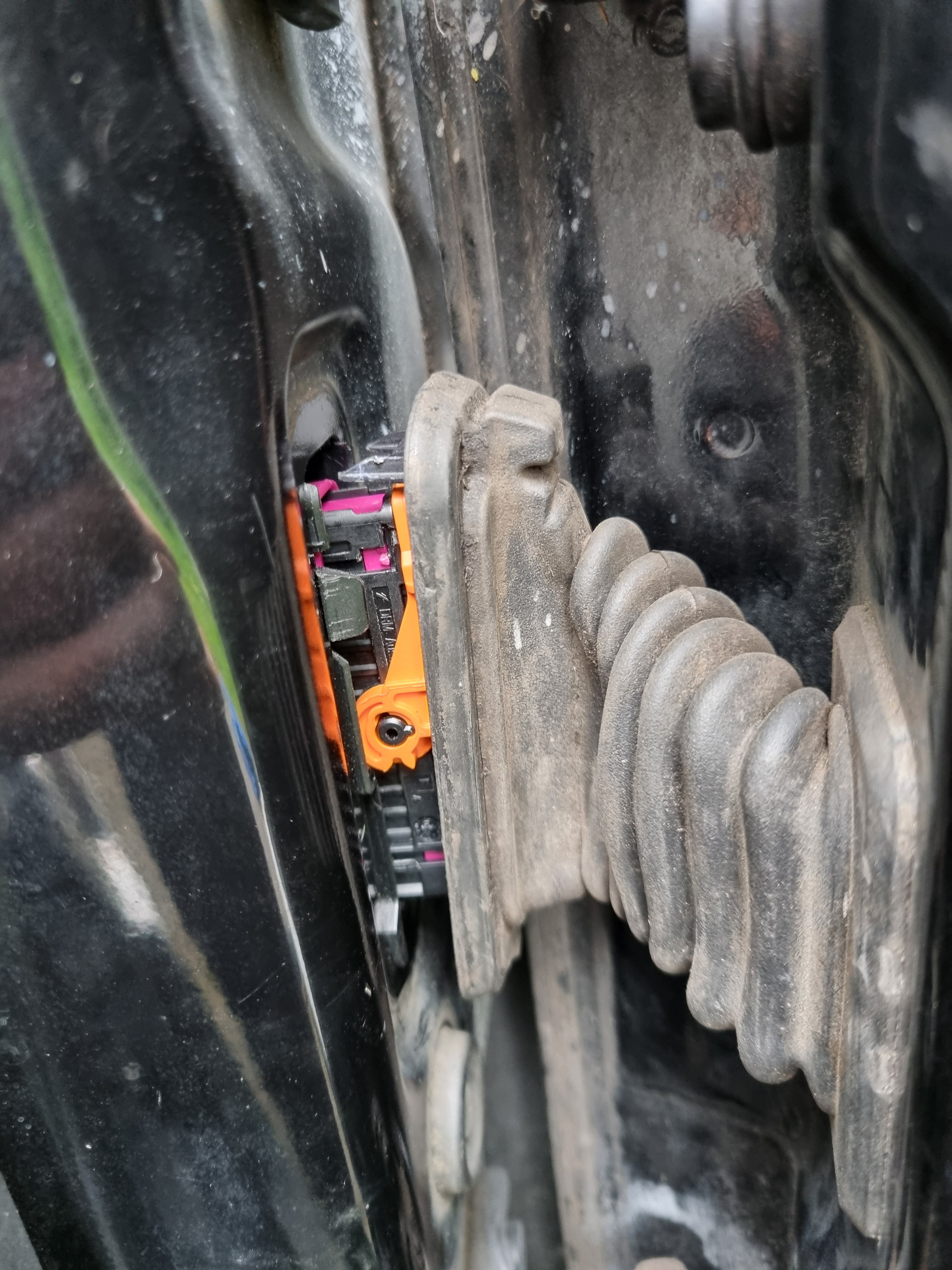

  1. From what I saw there were plenty of brown/yellow but black/yellows was one of the thinner ones and only one of that colour type
  2. I'm not sure how is go about a repair tbh when it comes to parts swapping I'm competent but with wiring it requires a different skills I'm not good at. Any advice at all? I notice the black/yellow wire had snapped which I believe affects the heated side mirrors. That sound right?
  3. It wasn't the rubber I couldn't get in, it was the block connector. I sorted it anyhow, my wife and her dainty hands sorted it. I didn't pull the orange tab far enough back 🤣 While you are hear you don't know the part number or a link for the full loom do you?
  4. Hi guys Was just checking the loom to see if any wires were broken that were causing the heated side mirrors to not work...there is but now I can't get the block connecter back in. Can anyone provide any assistance? Thanks
