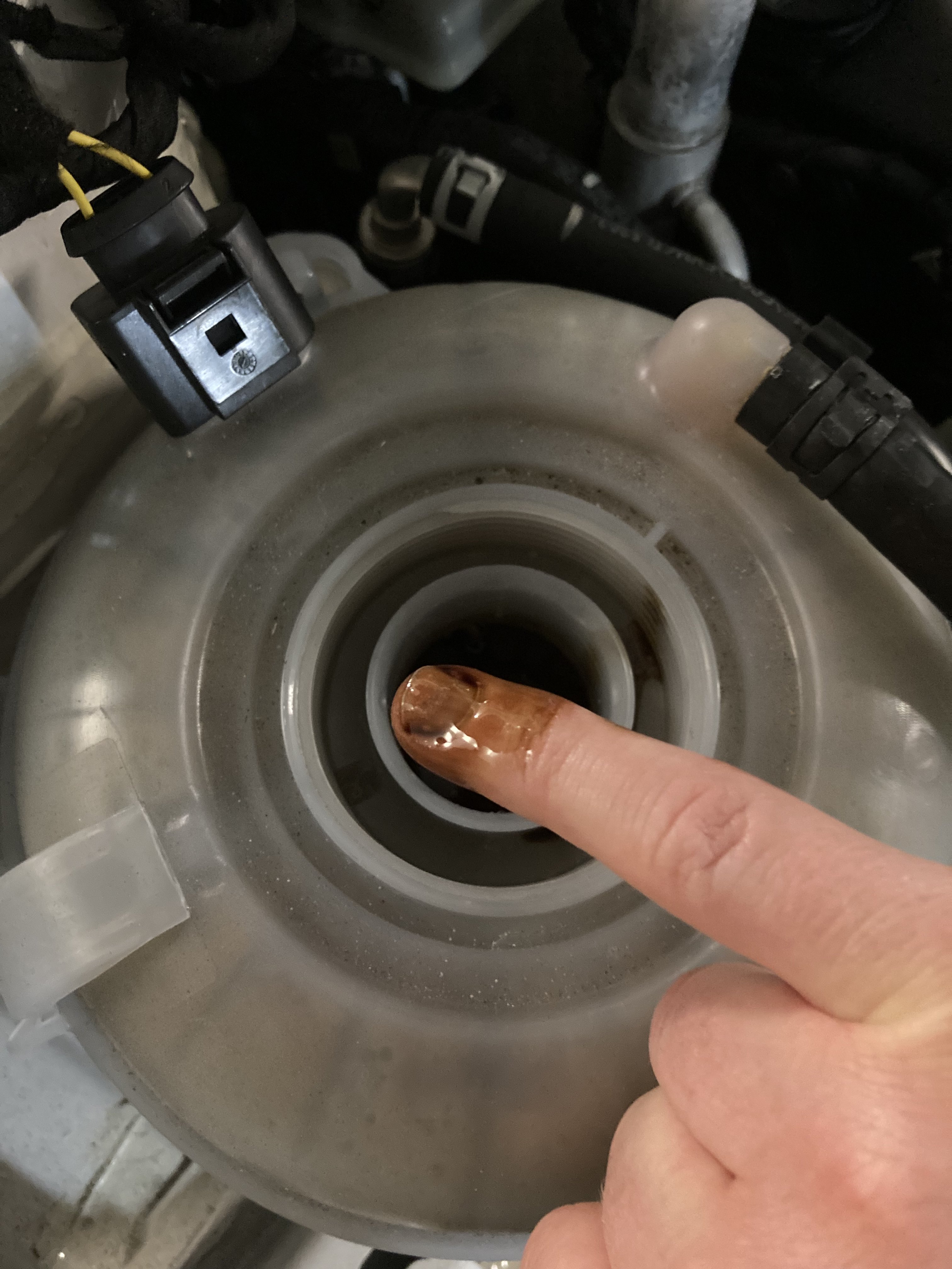

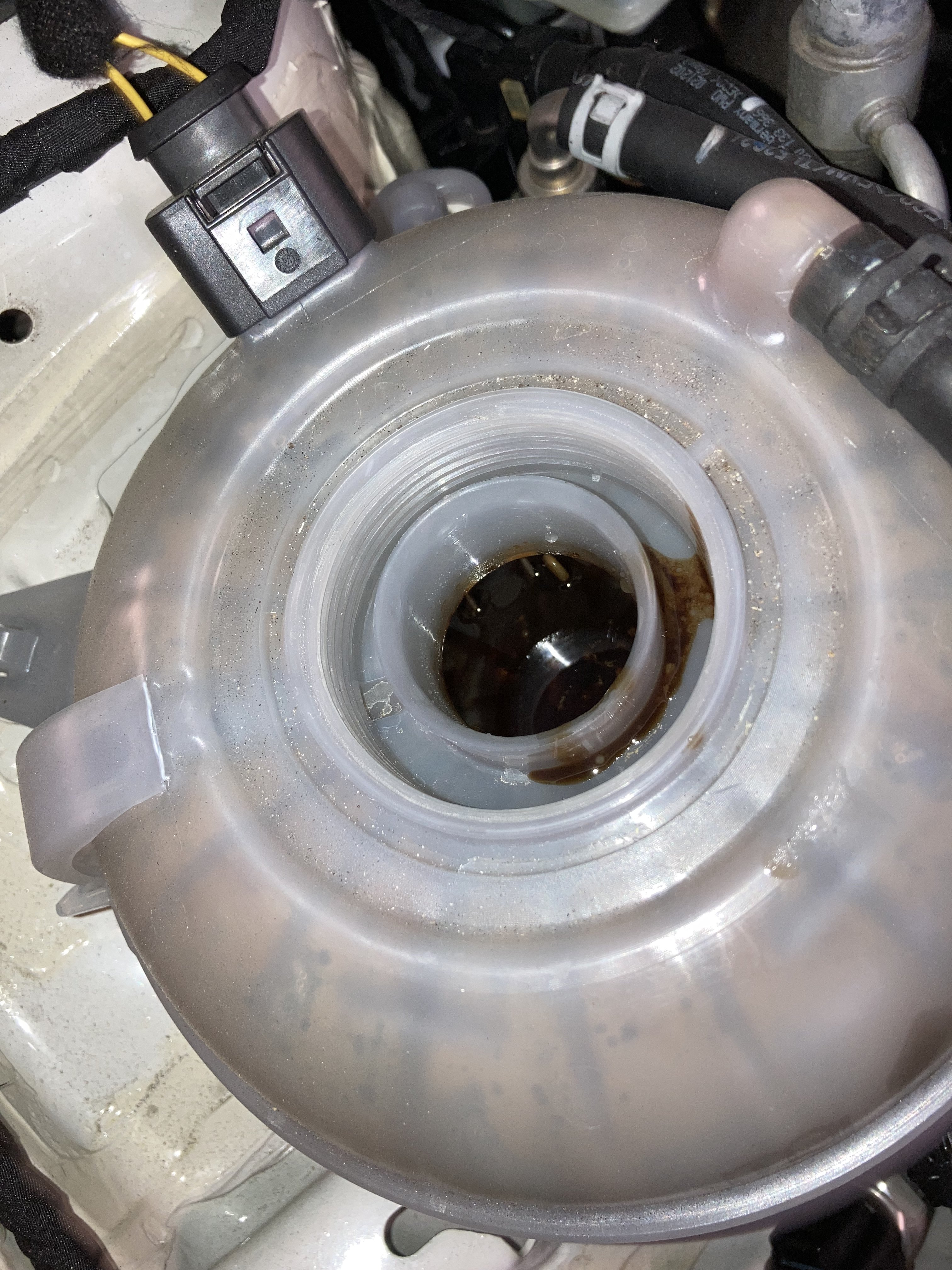

  7. Since my last post.... It's been a month since the car was in getting the oil and transmission coolers changed, everything was going till last week when parking after a short trip there was a weird gurgling noise from the engine, when i got out i noticed that there was coolant all over the road and parking bay... the cap on the expansion tank had failed and 1.5 L of coolant had escaped, bought a new cap and topped up the coolant and all was well again. Took the car in this morning for the agreed 2nd visit to the garage (it was also due a service and it's Rego - bit like an MOT here in Oz), garage called me to tell me that the car has now sprung oil leaks from several spots, sump, timing chain cover, rocker cover etc. they think the PCV valve has failed and the increased pressure has caused a bunch of oil leaks. FML... so that's going to be another $3400 (AUD) to fix the seals, PCV valve, service and coolant flush. I haven't followed up with the dealer, maybe i should but i don't have the energy to listen to their bullsh!t, every time I've spoken to the service manager he has lied to me... parts he had ordered for me but clearly didn't, accessories that he told me didn't exist but i then bought from another Skoda dealer, some nonsense about how the rear passenger door is suppose to let water gather in the bottom of it. I love the car, but it's killing my wallet. hoping this is the end of it now otherwise i might need to consider what i'm going to do with it as that's $7.5k i'll have spent on fixing it this year and i'm trying to save for our first home... 😞
  8. Got the car back this evening my wallet is $3700 lighter, the garage said I should bring it back in 500km to recheck the coolant and probably flush it again. I usually drive like a granny and only do short trips but they said I should try and do a longer drive (but not too long)… Will be keeping my eye on the coolant each day… I hope it’s all sorted but we’ll see.

  10. Took it to the garage this morning, they can’t say for sure if it’s the head or not but think it’s unlikely, they’re going to swap the Oil cooler, and the transmission cooler… and as the water pump was the original that will get swapped too…. My wallet will be a lot lighter… and still can’t say for sure it’s not the head… 😕

  12. Checked again this morning, I don’t see any bubbles or anything in the reservoir while the engine is running, but it’s definitely oil in there as it smells it feels oily. I did also notice a puff of white smoke this morning after the engine was warm and when under Harder acceleration… 😞
  13. There wasn’t any milky residue around the oil cap either… I’ve seen head gaskets go and it’s a much more ‘rusty’ sludge that ends up in the coolant, but as you say might be just happening now… although the car only has 96k Km on it and I usually drive pretty gently as we have a baby. 😞
  14. 2015 Octavia Rs TSI As we’re coming out of lockdown now I did some general checks on the car (last service was 10 months ago), oil looked good and the level was fine but when I checked the coolant it was disgusting. It had a kind of oily gunk floating on the top that’s got me a bit worried. Could it be a water pump issue? The temp never goes over 90, but it only does fairly short journeys for the last few months, just to the shops and back usually 10-20 min tops. included some photos… keen on folks thoughts?.. think I’m going to book it into the garage regardless….
