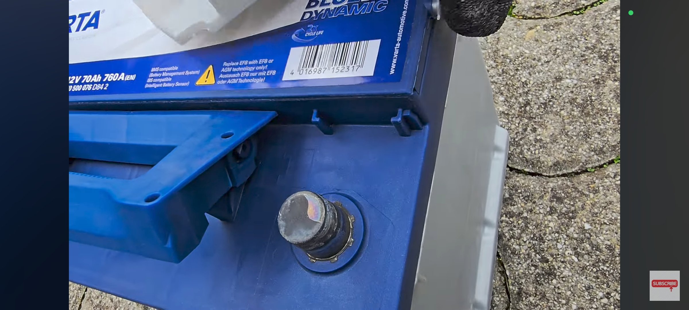

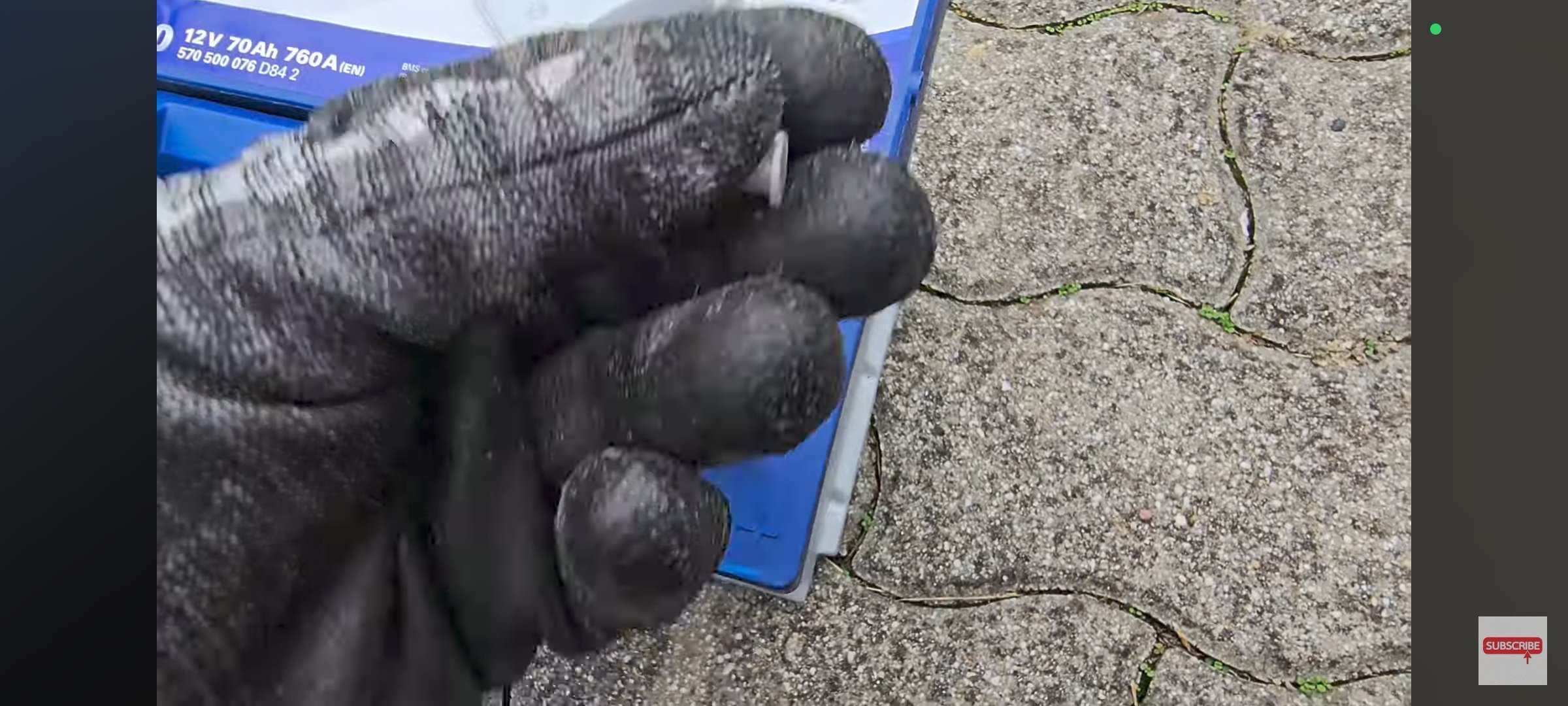

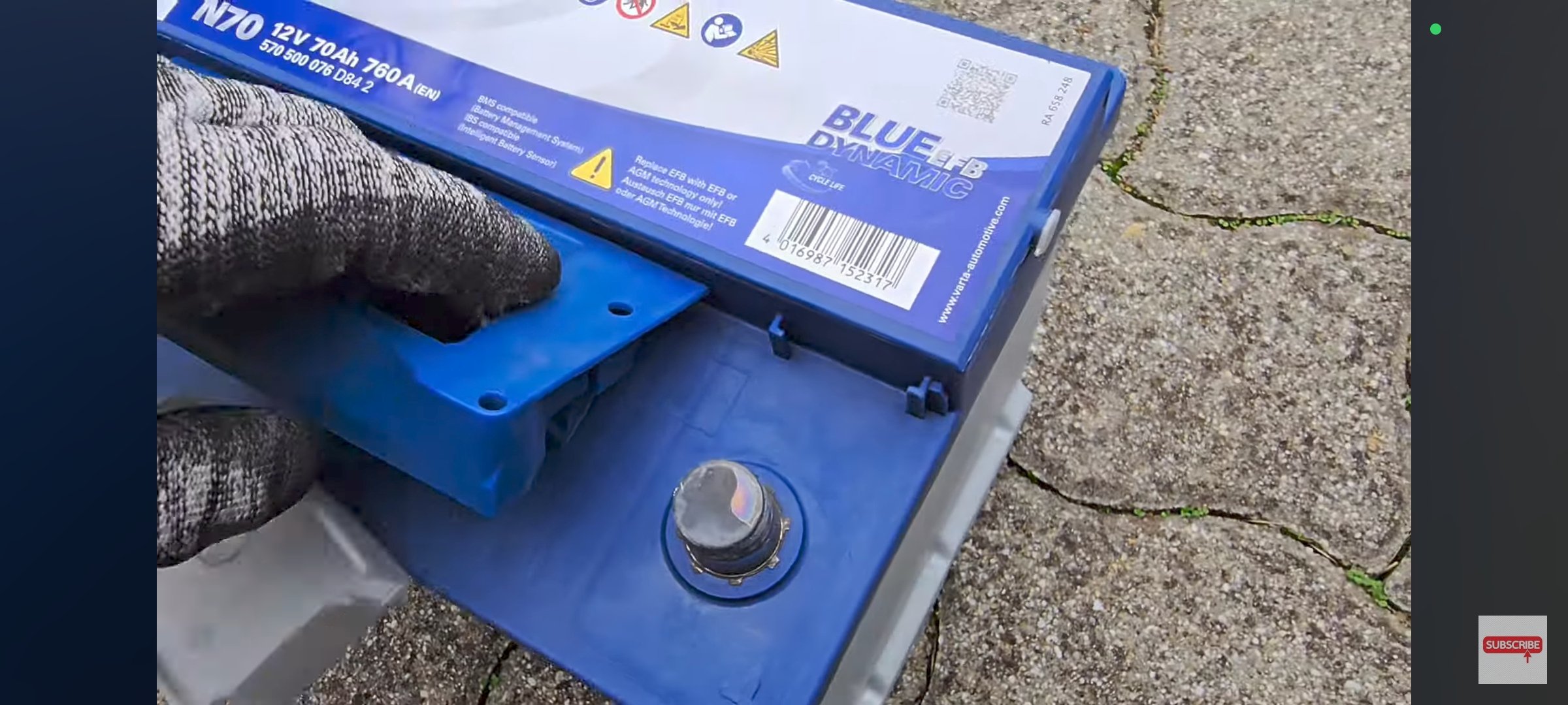

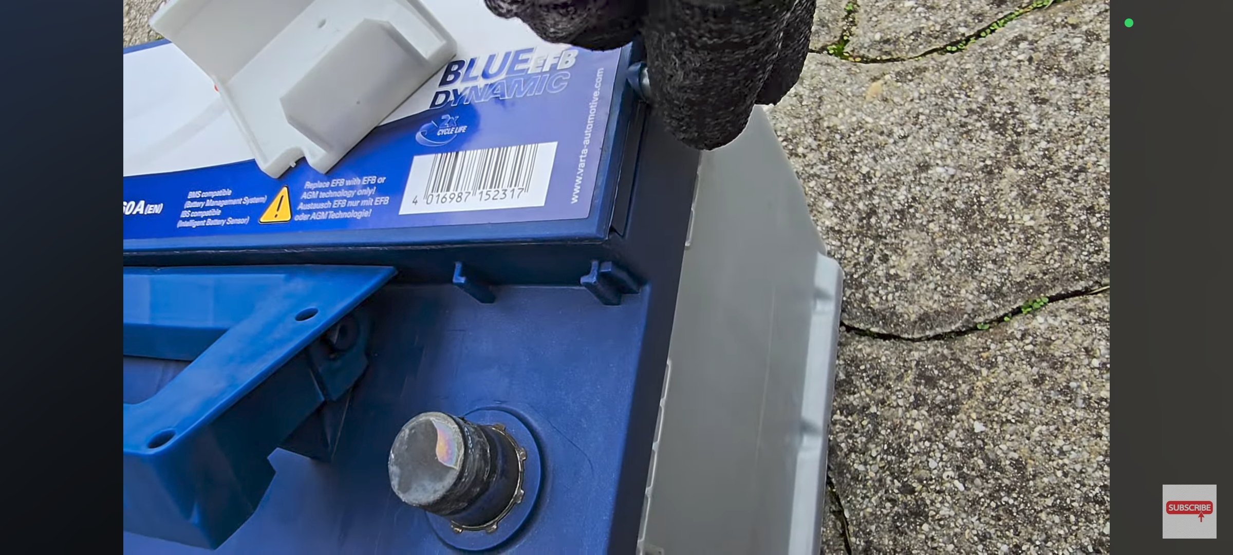

  1. Are you meant to put the grey plastic cap back in after install as shown in this video at 4:30, thought that was for transit only.

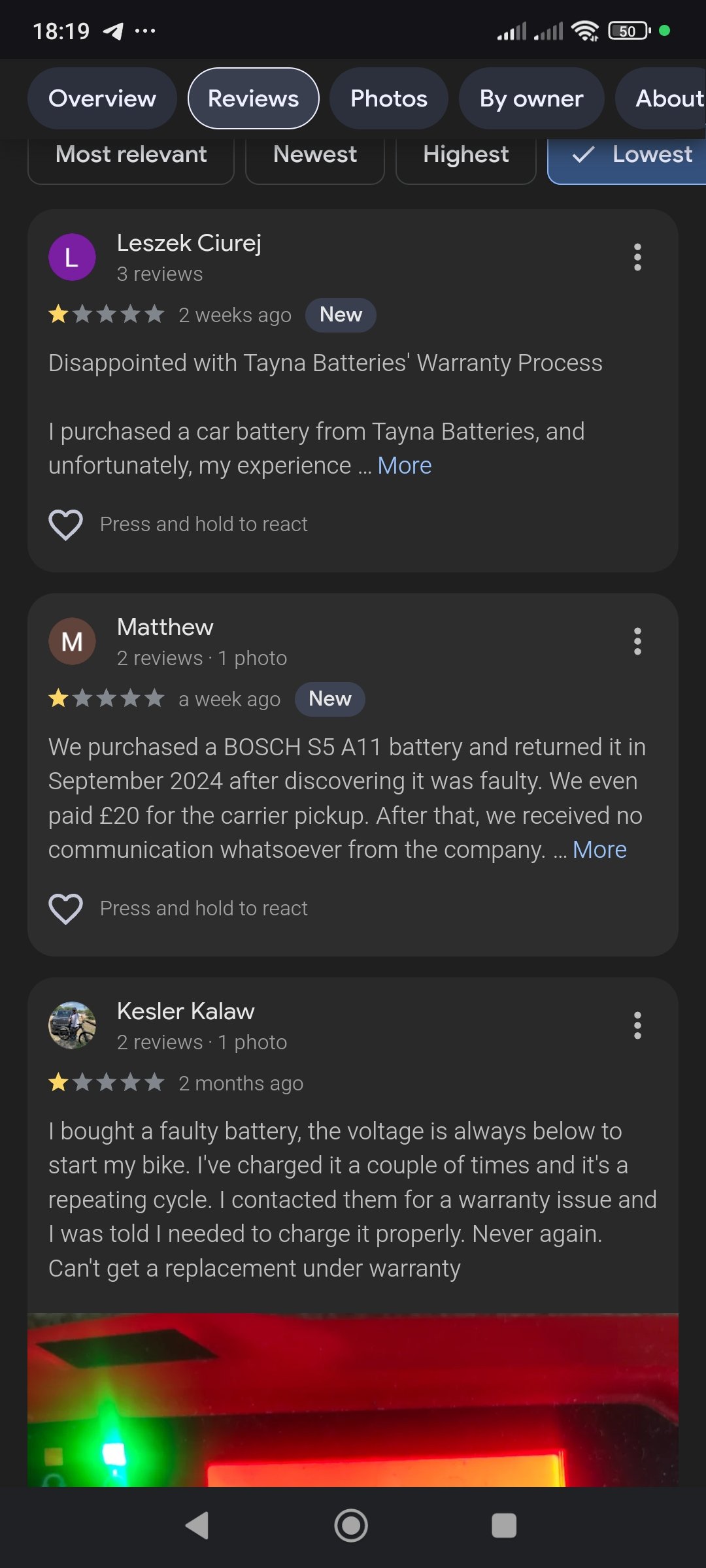

  3. Thanks all One thing to note, I know Tanya batteries is a favourite on this forum but before ordering I noticed they have alot of negative Google reviews when things go wrong so ordered from Amazon instead. Just something you may want to be aware of.
