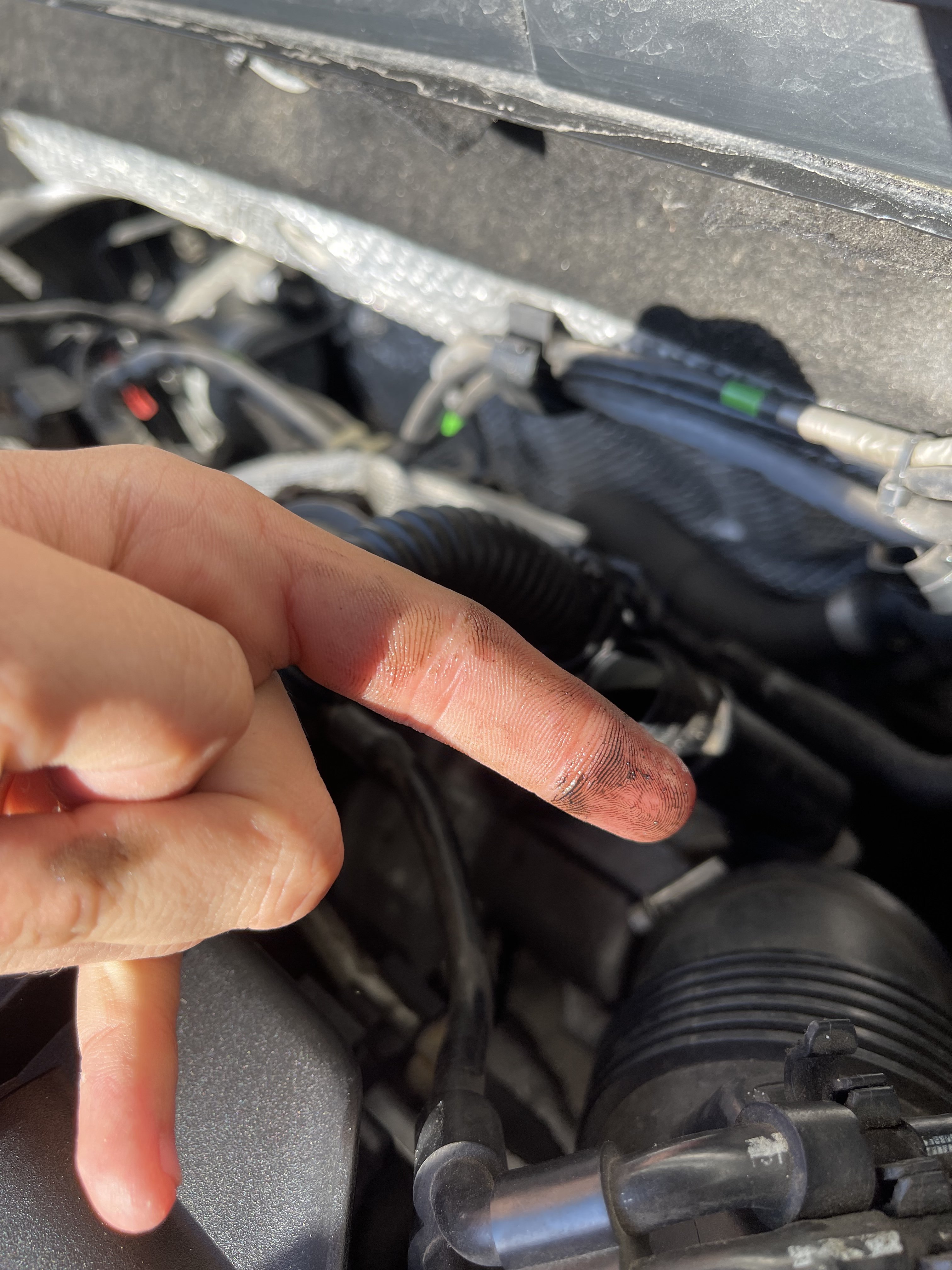

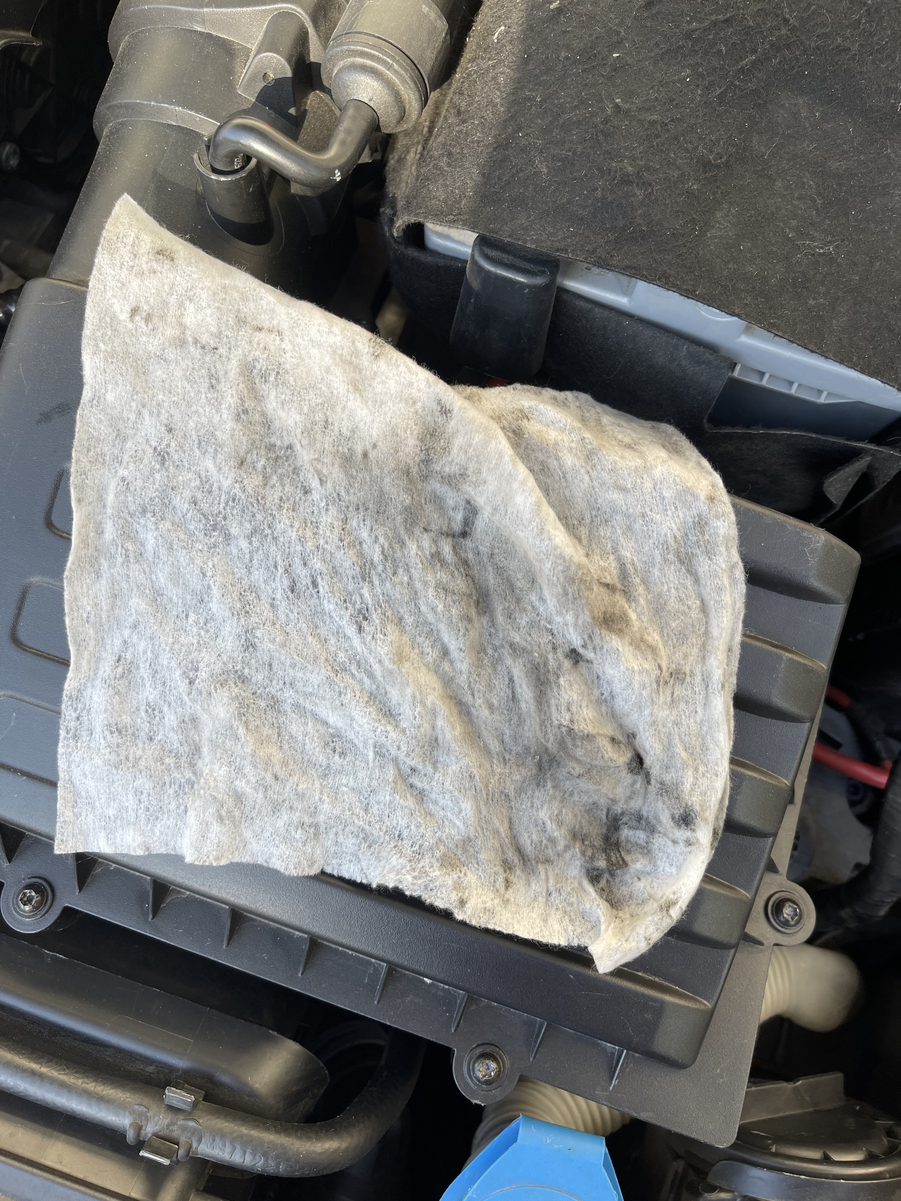

Update: I checked better as Bogdan told me and I have oil inside ... not much, but it's still there.

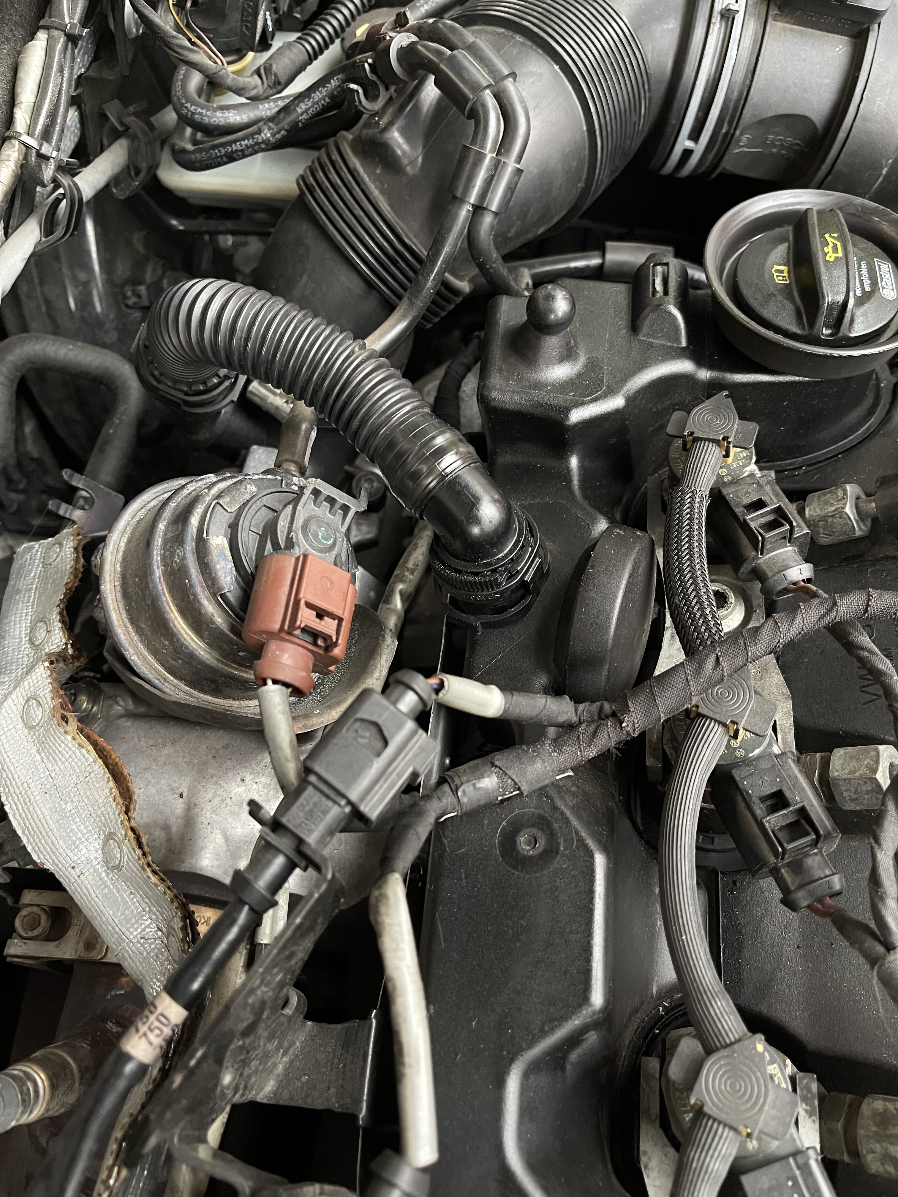

Hi again, I checked the expansion vessel, more precisely the antifreeze and it has no oil film on top. I did what you told me and I also checked the pcv valve, and it's okay, it has no oil, everything is clean. Now, as a conclusion, I still have time to do a compression test. What oil do you recommend for this consumption of oil? Now I use Liqui Moly Top Tec 5W30. Should I try to use the Ravenol?

I don't think it's from there because the engine is clean, it has no traces of oil. The oil bath is clean, I changed the gasket on the rocker cover and the engine has no oil stains.
