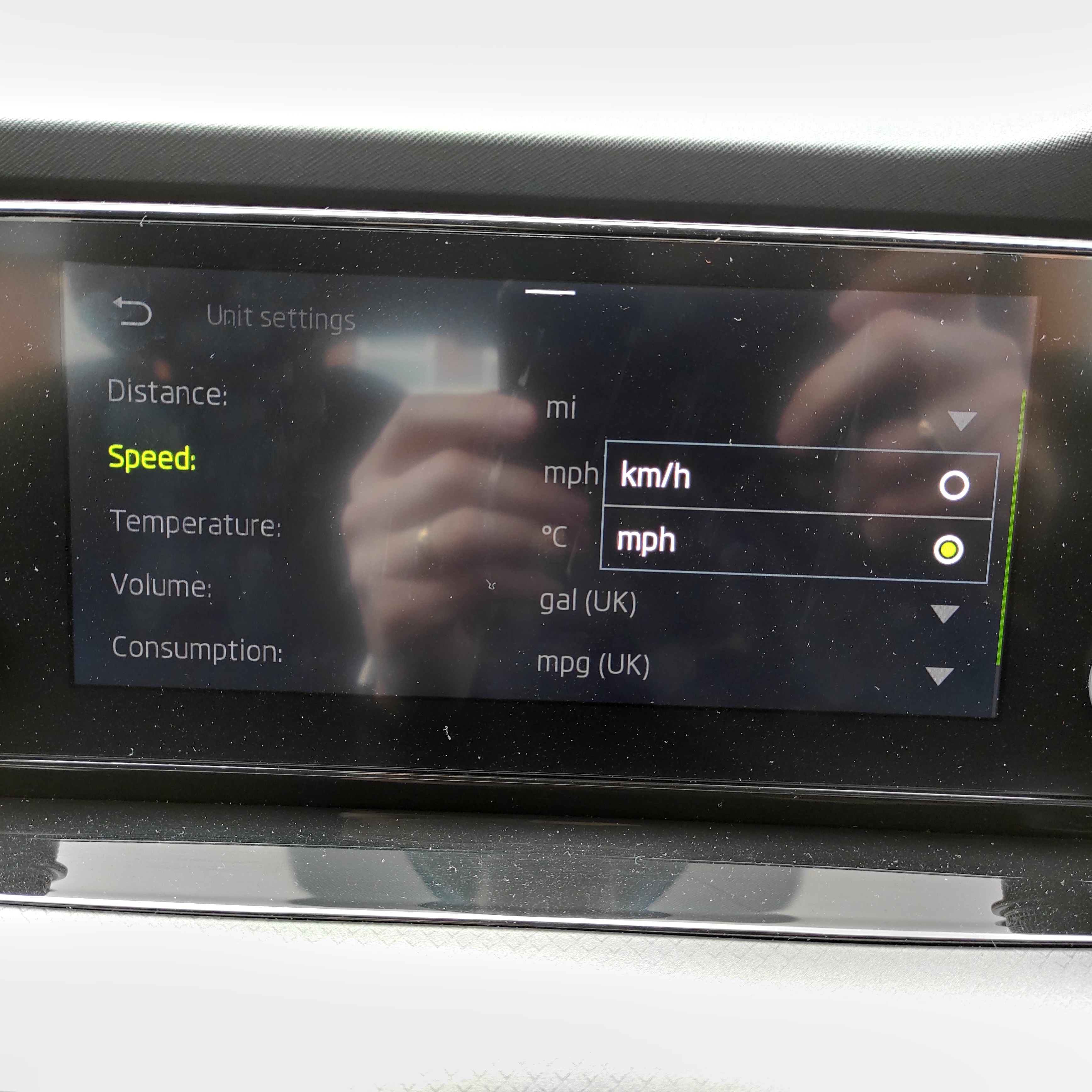

KPH/MPH

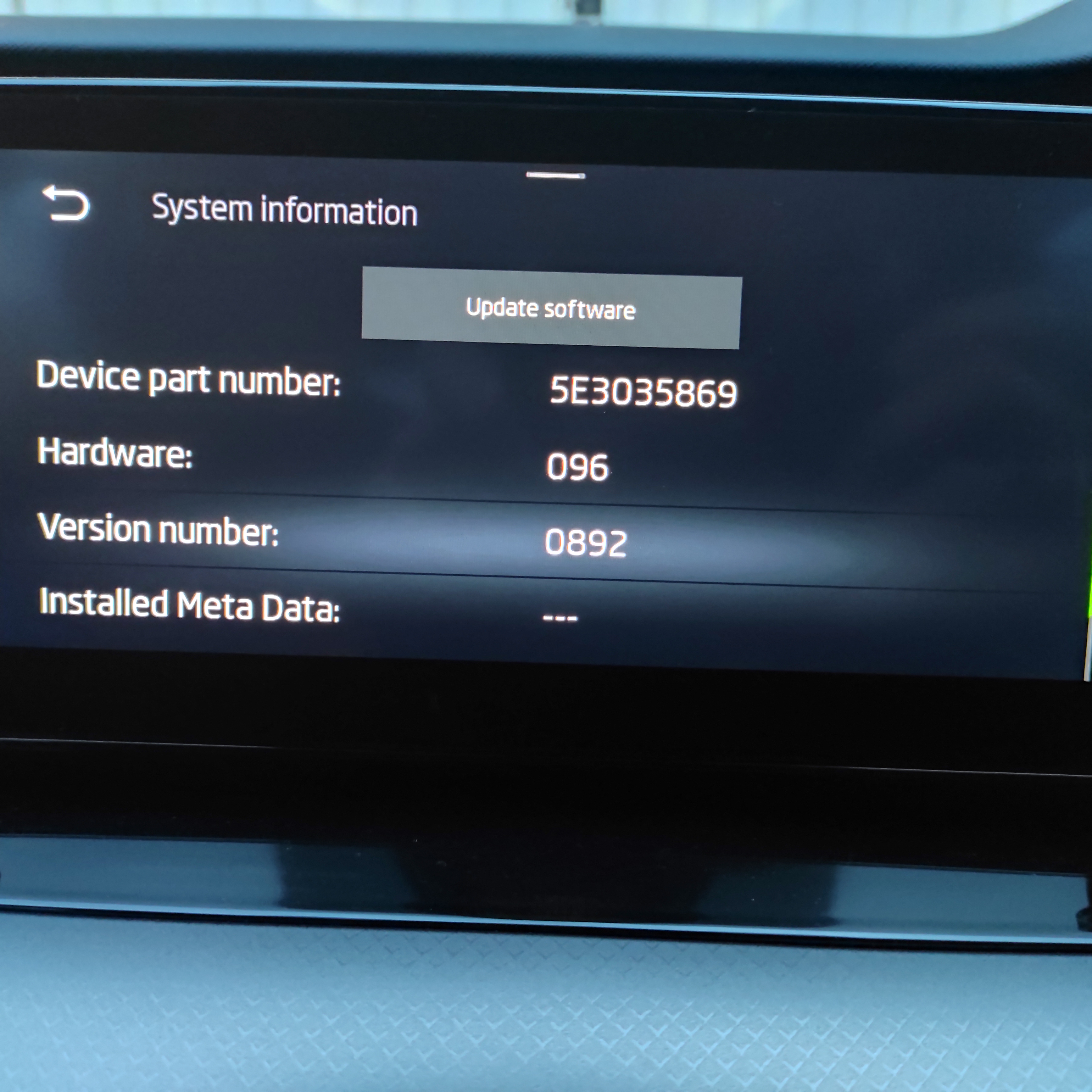

I hate to put a downer on this but my car was delivered with version 0892. After driving to work in the cold this morning and not being able to use the heater I decided to book the car in with the dealers for 27th April. The issues I've raised are: 1) Touchscreen not working (at least three times a week). 2) When the touchscreen isn't working I get a message saying manoeuvre braking not available. 3) When touchscreen isn't working the rear parking sensors don't work.

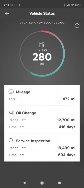

Just looking through the MySkoda app and it is showing an oil change is due in 12,700 miles/418 days and service is due in 19,499 miles/634 days. When did Skoda start seperating oil changes and services like this?
KPH/MPH
It's the 8.25" in the SE First Edition.

@Gax my car shows similar information to yours, device part number but no mention of software version.

Newbie question, where do I find the software version? I have been into the system information screen and can find a hardware version but can't see a software version.
