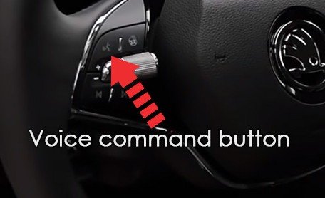

  4. I had this on my Octavia before they applied an update which resolved the issue, to get round it I pressed the voice command button on the steering wheel (not sure if the Scala has this button though).

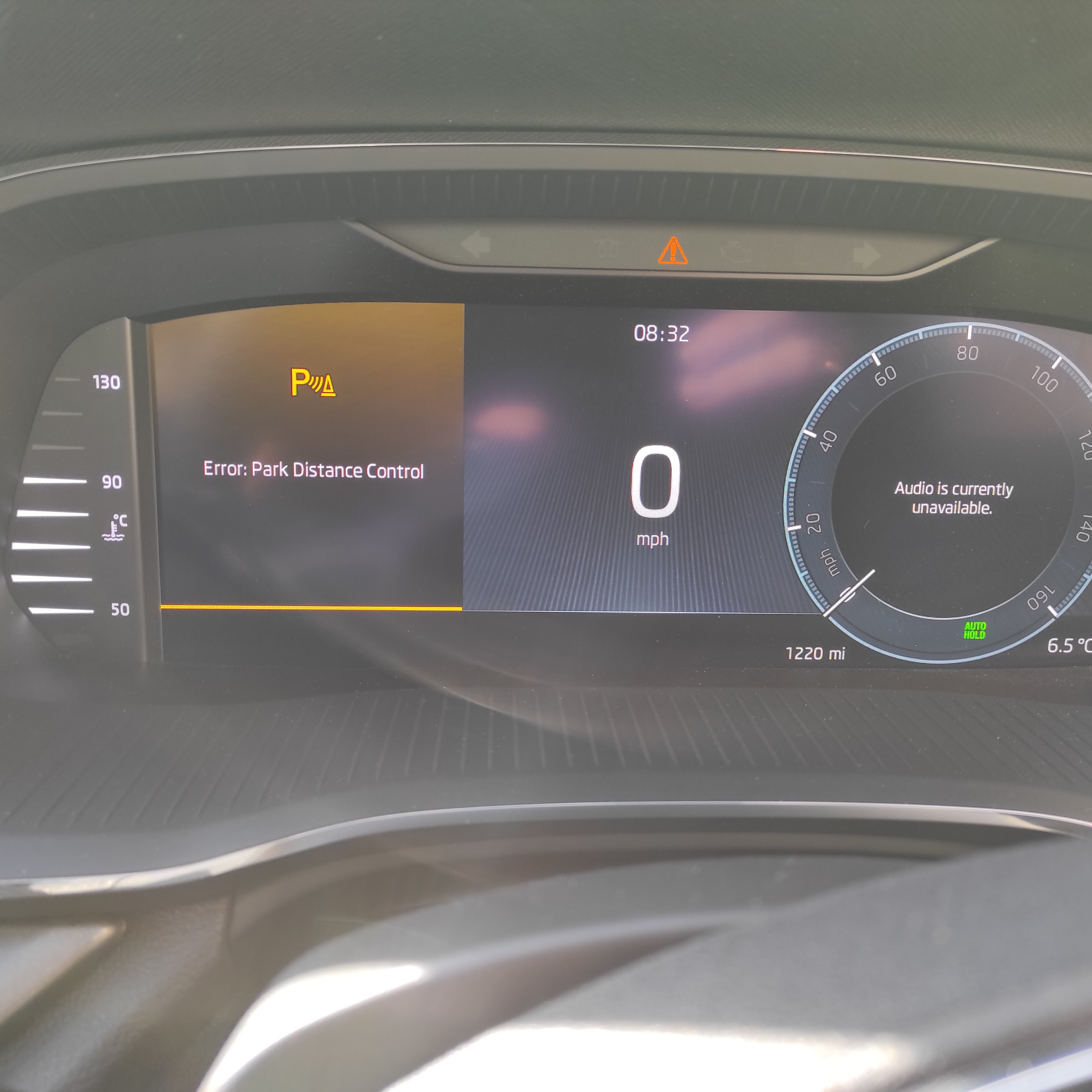

  17. My issues have resurfaced with a vengeance, 3 days out of the last 4 I've had journeys with no working touchscreen. I've started taking photos of the dashboard showing the errors so I have a record. I tried loading the My Skoda app to see if the errors showing on the dashboard appeared in the app, they don't.
