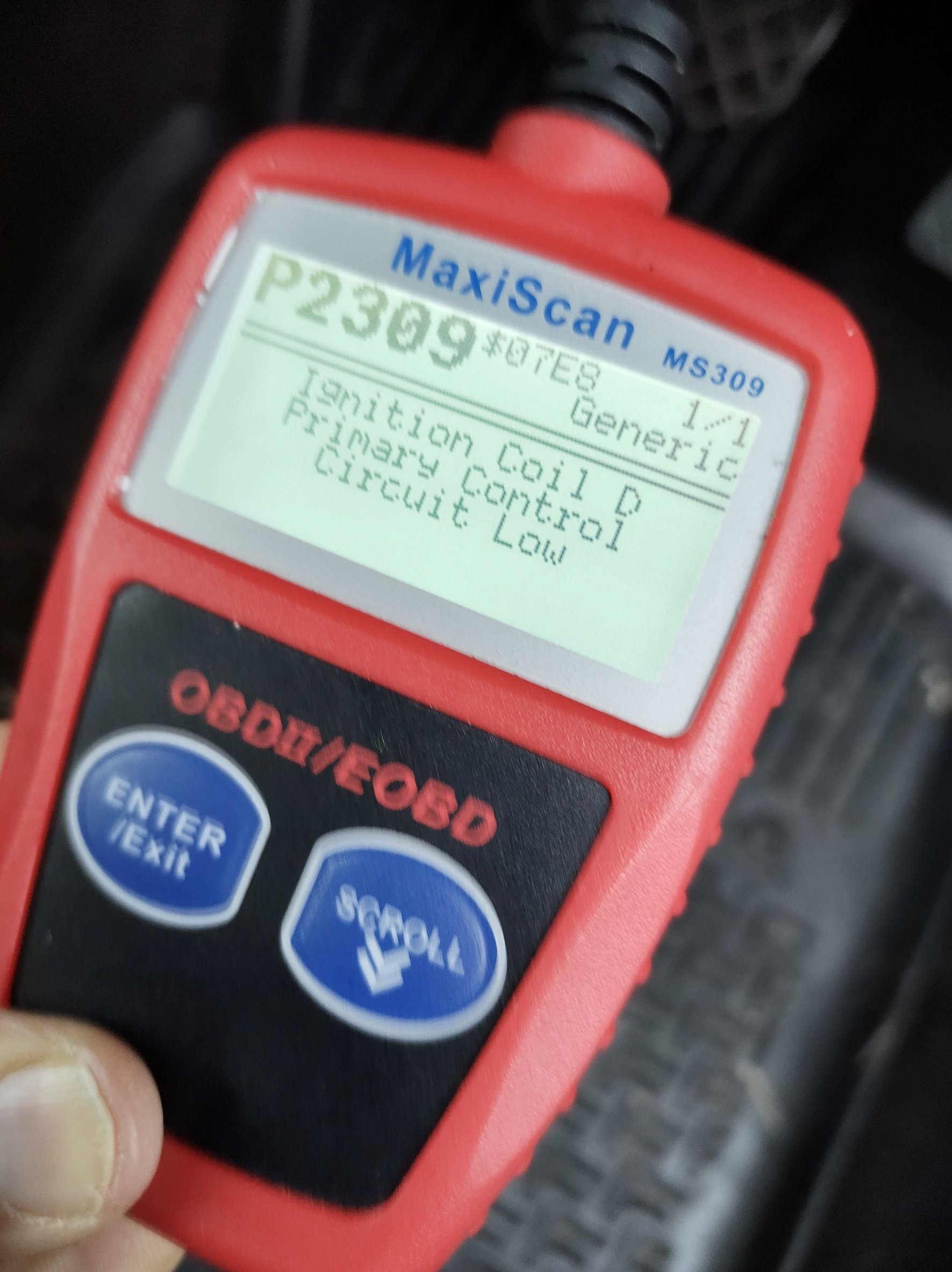

  1. Not only did my reader not show any stored codes but neither did the Skoda all singing and all dancing diagnostic machine The only code I have got was PP2309" IGNITION COIL D PRIMARY CONTROL CIRCUIT LOW" when I scanned with the engine light on. If I scanned again that code would not be there as when I turn off the engine it clears the codes apparently. Skoda said that to be able to diagnose a problem on my car the engine light needs to be on so they can connect up. If there is no engine light on then any codes would have been reset when I turn off the engine I don't understand why when the engine is turned off it clears codes

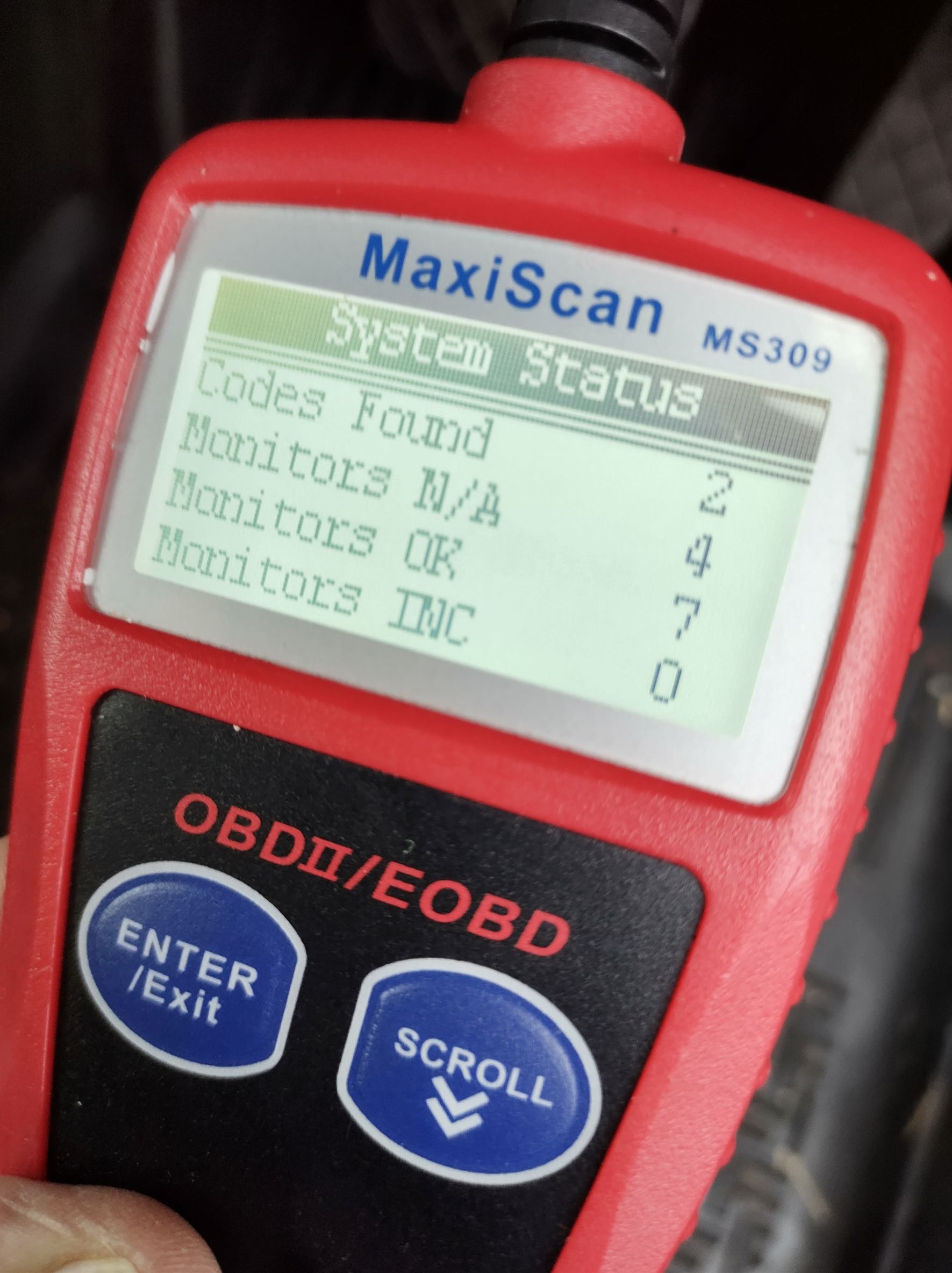

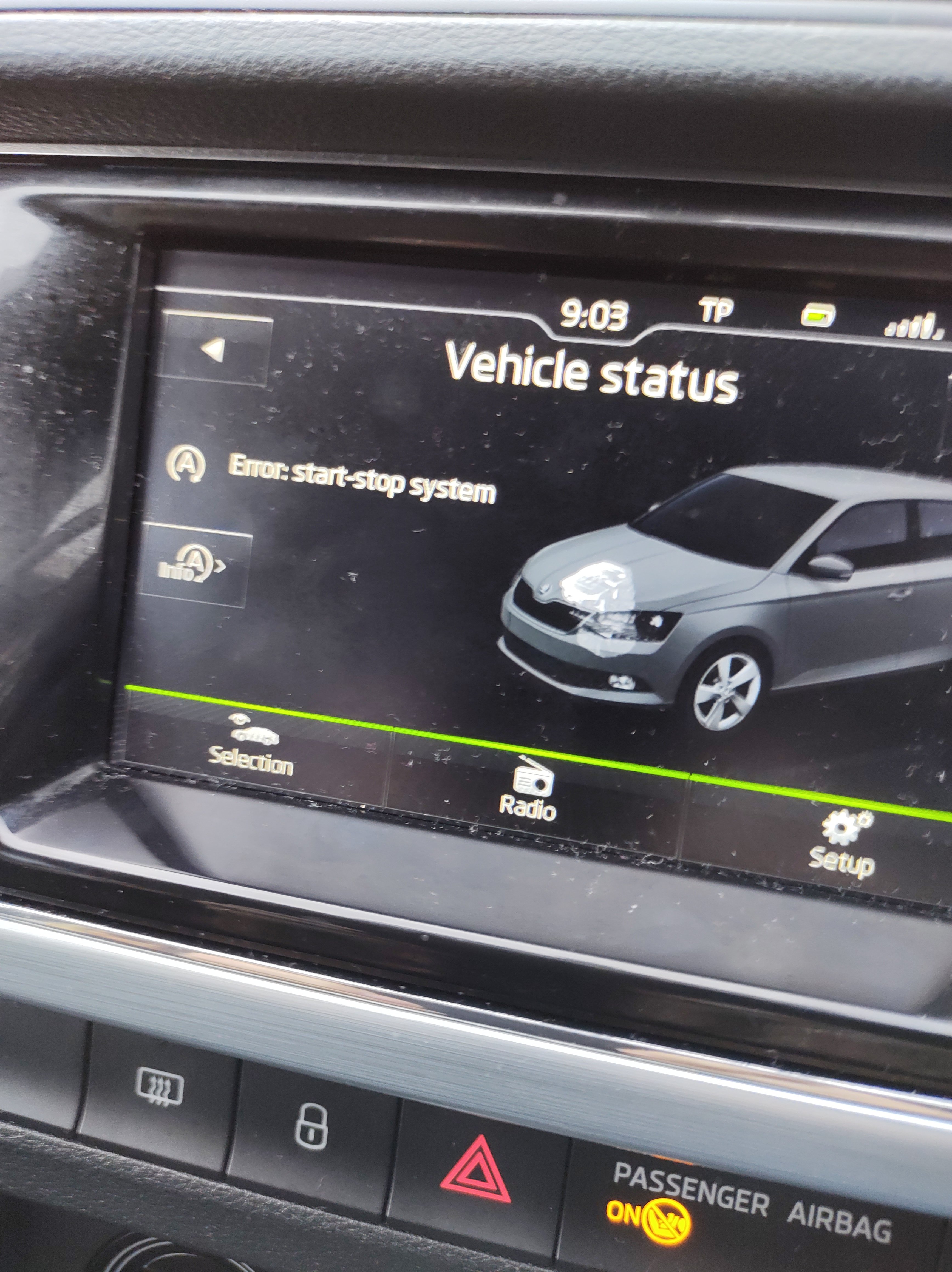

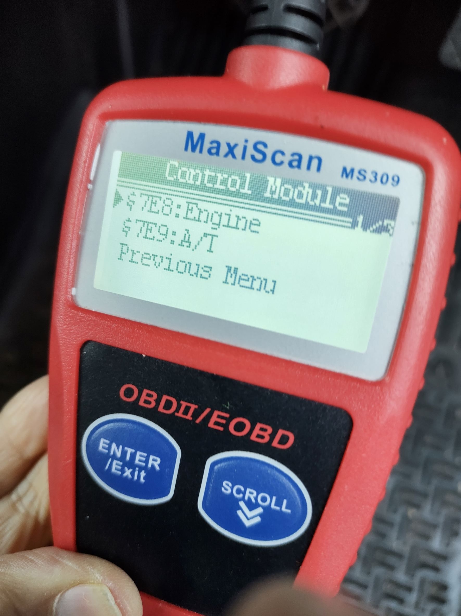

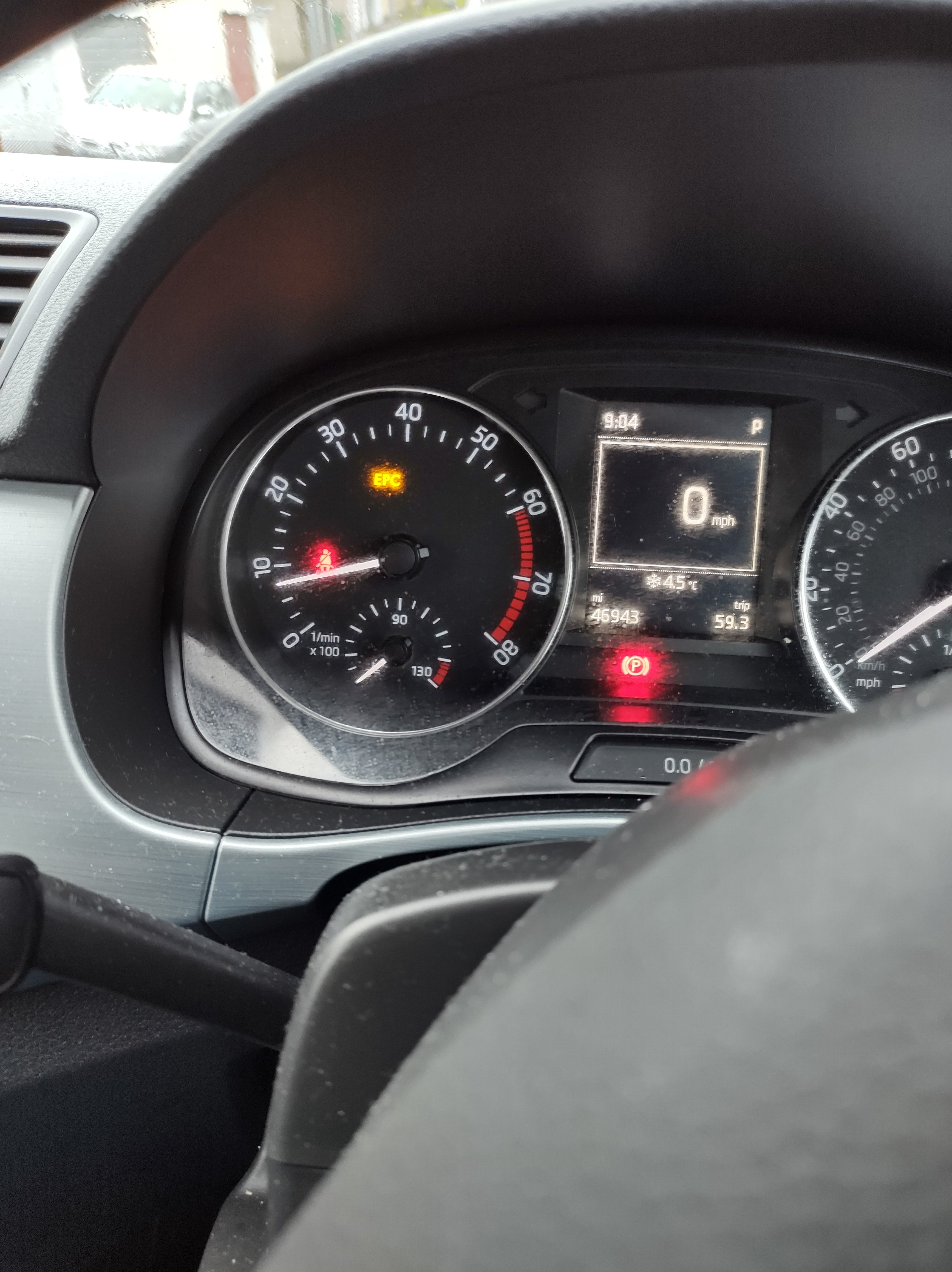

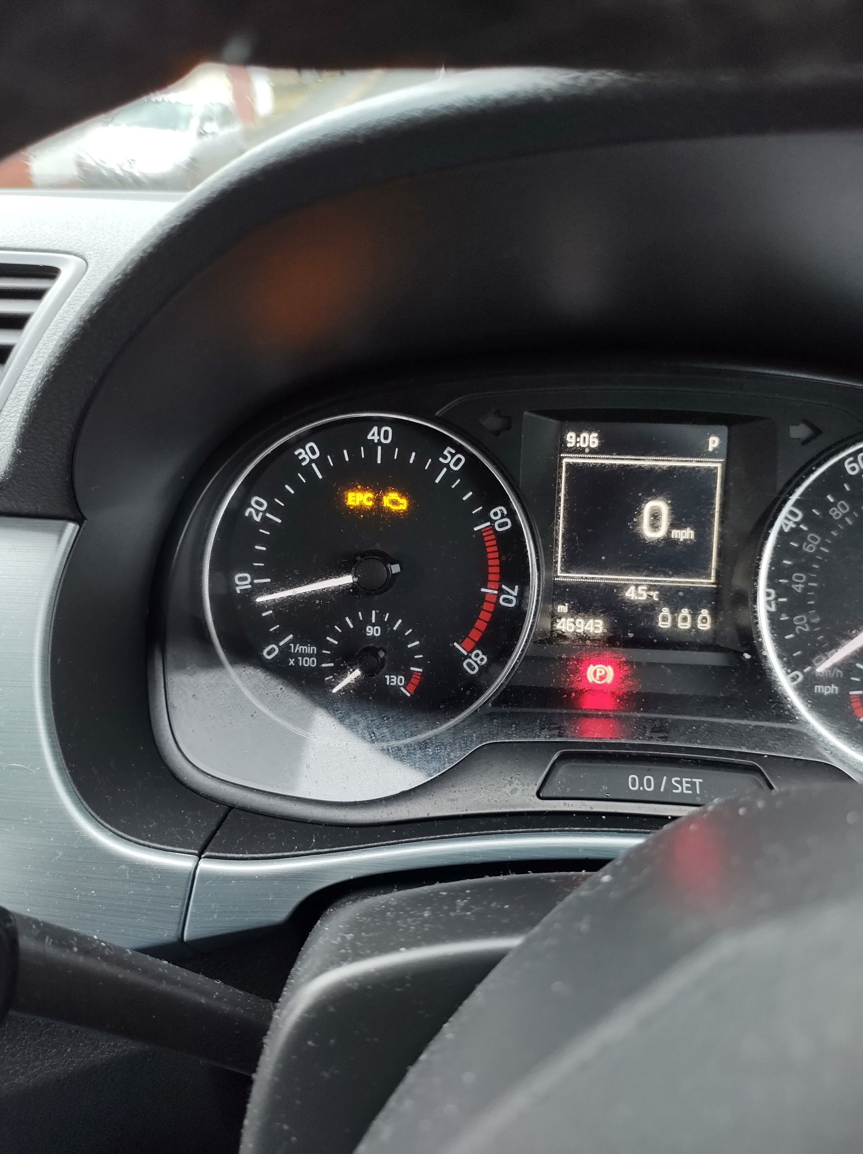

  17. The saga continues. This problem has happened twice while my wife was driving over the last couple of months at this point ignore the photo's. Both time Skoda could not find a problem on their Supa Dupa diagnostic machine. They told me to monitor it. Anyway this morning I start up the car and the EPC stayed on (photo 1) and it started to shudder (coil I thought to me self). Anyway I went into vehicle status and it said (photo 2) Error stop start system. I tried to press the button underneath for info but nothing opened. Just at the time the engine management light (photo 3 ) came on. Then the EPC light went out but the engine management light stayed on. Great I thought I can now attach my reader This is what it brought up (photo 4) 2 codes found although only one showed up. I pressed the enter button and this popped up (photo 5). I then pressed enter for the top message 7E8 Engine and this error showed up (photo 6) I turned the engine off to stop it vibrating and when I turned it back on again both the EPC and engine management lights stayed off. I went straight to the Skoda dealer who told me that they could only scan it when the engine management light was on and that the code meant nothing as it could be one of many things. This happens about every 6 weeks and they wanted me to leave the vehicle with them to see if the fault occurs while they have it. I declined as I need the car so I booked it in at the garage I usually use. Any Thoughts please.
