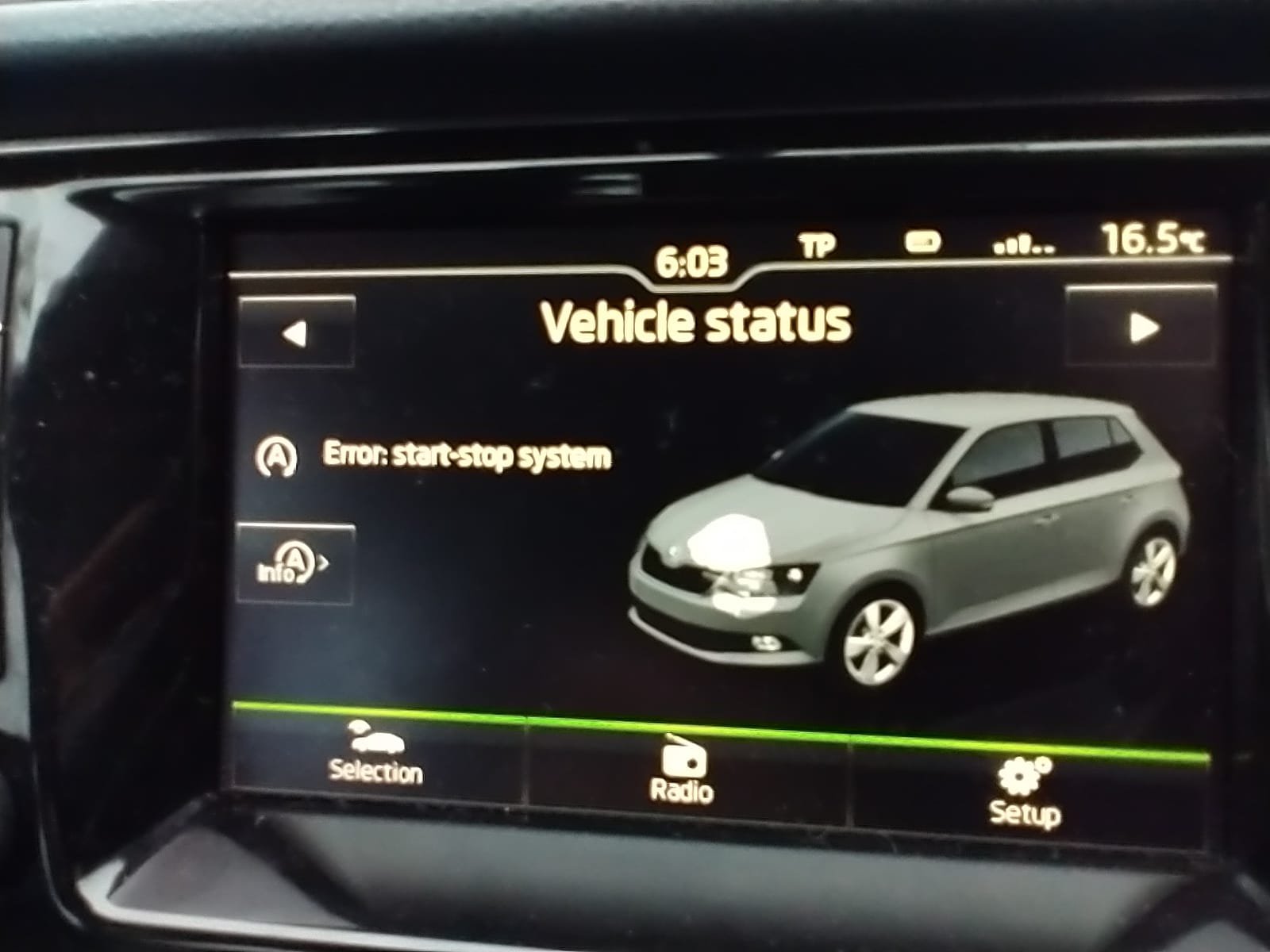

  7. Yes, it is very frustrating. I assume they have the best diagnostic equipment money can buy and they still cannot diagnose the fault. They just tell me to monitor it which I did and even gave them the error on the vehicle status. I wish I knew someone with the expertise to diagnose this problem.
  8. They can not diagnose the fault that is the problem even though I took a photo of the error message on the vehicle status ERROR: Stop-Start System.
  9. Just got the car back from Skoda, just like the first time it went in a couple of weeks ago, there Diagnostics machine did not pick up any fault codes or historic codes. Was told it was not a good idea to disconnect the stop start function. from the battery. Just have to keep pushing the A button instead. No solution.

  14. This is the 2nd time this has happened in three weeks. I am pretty sure this error code would have come up the first time but my wife restarted the car before calling me. I didn't get a code on my scanner and neither did the Skoda dealership on there diagnostic equipment. I will call them tomorrow. I will also disconnect the connector on the battery.
  15. Yes, the battery was coded. Wife still at work so will disconnect at the battery tomorrow. When you restart the car the next time the EPC light goes out as normal and the error message is not there. If I disconnect the connector I will only know if that has worked if it doesn't happen again. I took almost 3 weeks for the problem to re-occur. Doesn't disconnecting the connector permanently disable stop start?
  16. Had the battery changed and alternator checked. It has happened again car started juddering. After the Skoda garage said they couldn't find anything wrong, I got my wife to take a picture of the Vehicle Status and it came up ERROR: start-stop system. Any ideas? will have to con tact Skoda garage tomorrow.
