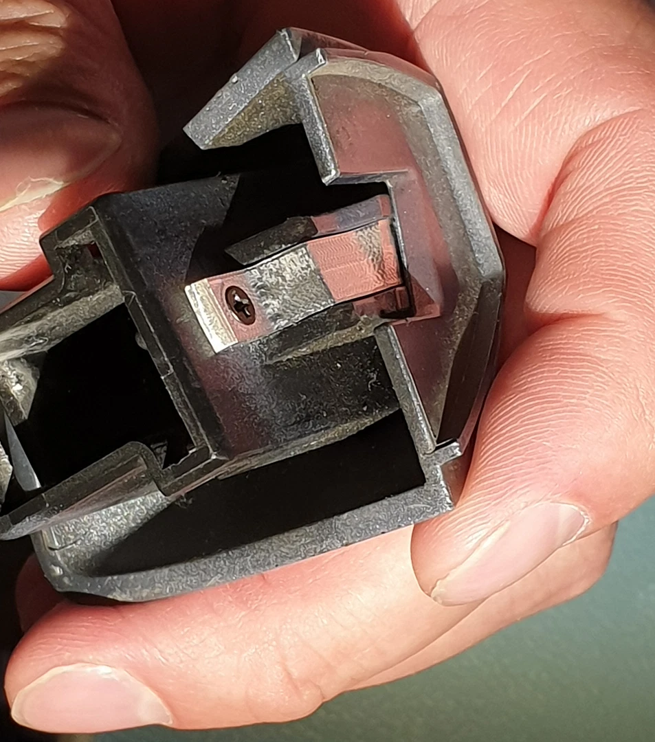

  1. Spoke too soon. Did not work. Handle stays in, but does not pull the lock open. Will try adding more to the stack and then maybe heating and bending. Chap in Scandinavia seems to sell a mod / metal plate which is the same intended effect as the glued and stacked plastic addition but in metal. 50 dollars is a bit steep... https://www.ebay.com/itm/157210800201
  2. Thanks for this. After another pop out, I have copied this. Cut an old credit card up, glued with gorilla glue and refitted. Hopefully that will sort for the foreseeable.

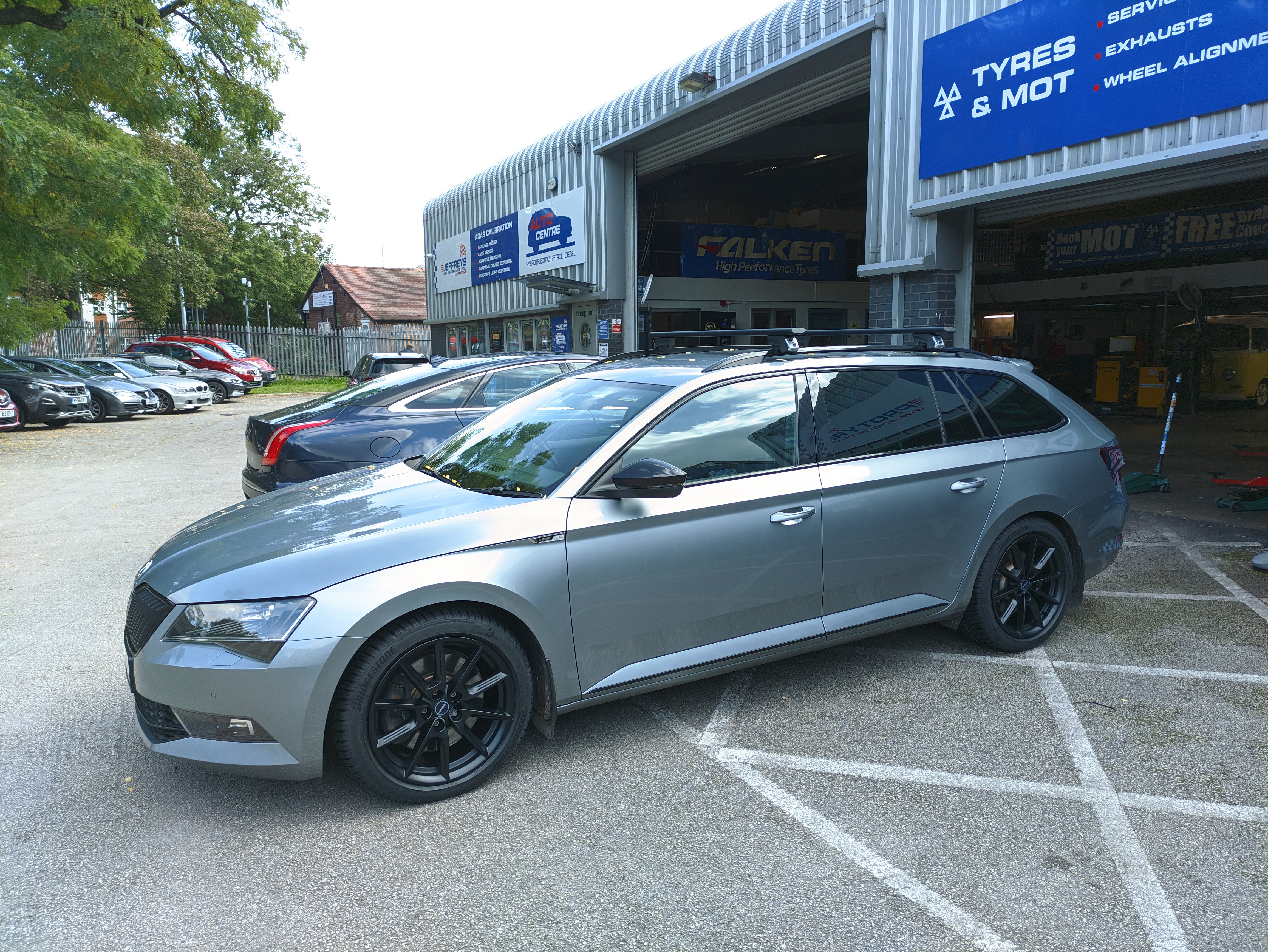

  7. digging this one out again. Michelin, my independent, blackcircles, others recommended their primacy 4 tyres for my 280 superb. RAC insurance have ok'd them also even though they are the VOL homologated version.

  12. dealer was very helpful and adjusted / fixed for free. will see how long it lasts...
  13. thanks, looks like this video to me from your description https://www.youtube.com/watch?v=mDYTALYbUtc
