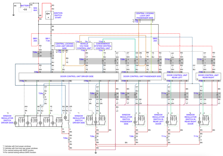

Im getting more and more confused =) That wiring info is the one I found for my car (Haynes-) I look again. Also found out just now that this part is used on vw Polos as well. Don't know exactly which year polos but now I have to look into that as well.

ah now I understand the difference. Well that wasn't a happy surprise. Yes and that one is good. I replaced it anyways Justin case but it did nothing. Everthing seems to be working as It should except the "DOOR CONTROL UNIT DRIVER SIDE"

04/1107? I thought I at least had until the new production started in 2010 =( I had my brother look at the car who is an electrician and he was also talking about that wiring underneath the rubber cover but he didn't find anything wrong there. Think ILL go over everything once again. Take everything of, inspect reassemble it again before I pay 250 quid for a new one =(
