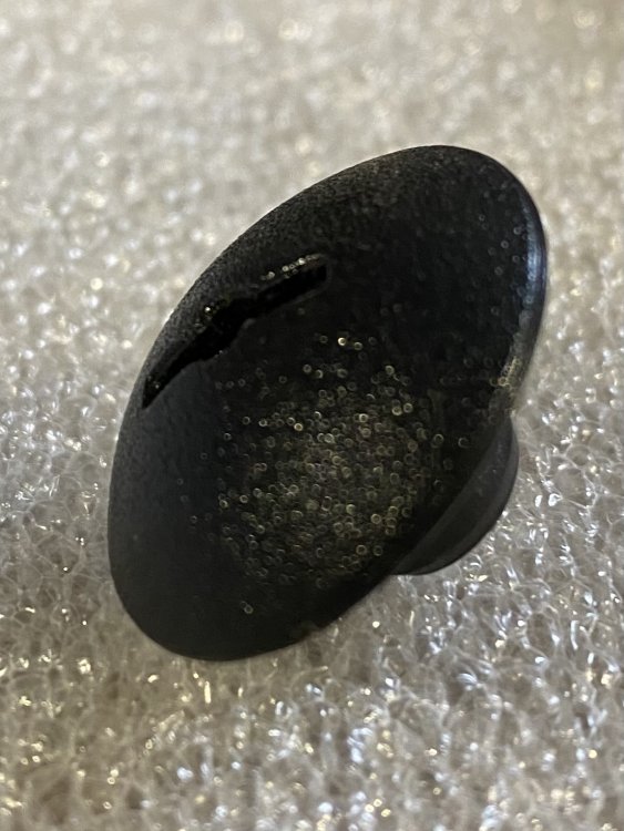

  10. Had a good message exchange with ATD today as well and I have the same trim tool kit. I’m currently looking to source these to get the carpet under the pedals plat and in place. I’ve got a few orders in for other trim clips and various generic spares from other projects. But these are hard to find.
