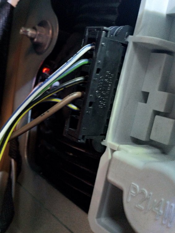

hi, im new to the forum and sorry if the topic is in wrong category but i need information about that which color are the wires for reversing light on octavia mk2 2010 fl. i want to connect my reversing camera on reverse light so if anybody knows which wire is positive and which is negative on reverse light?
which of these?

Brown on pin 3 is earth, black/yellow on pin 4 is reversing light.
Might well upset the BCM by doing it though.
Others that have tried this approach have found black lines running up and down the picture due to rf interference.
The solution is to use a small relay connected to the reversing light wire that then switches a clean 12V supply from another source to the revering camera.

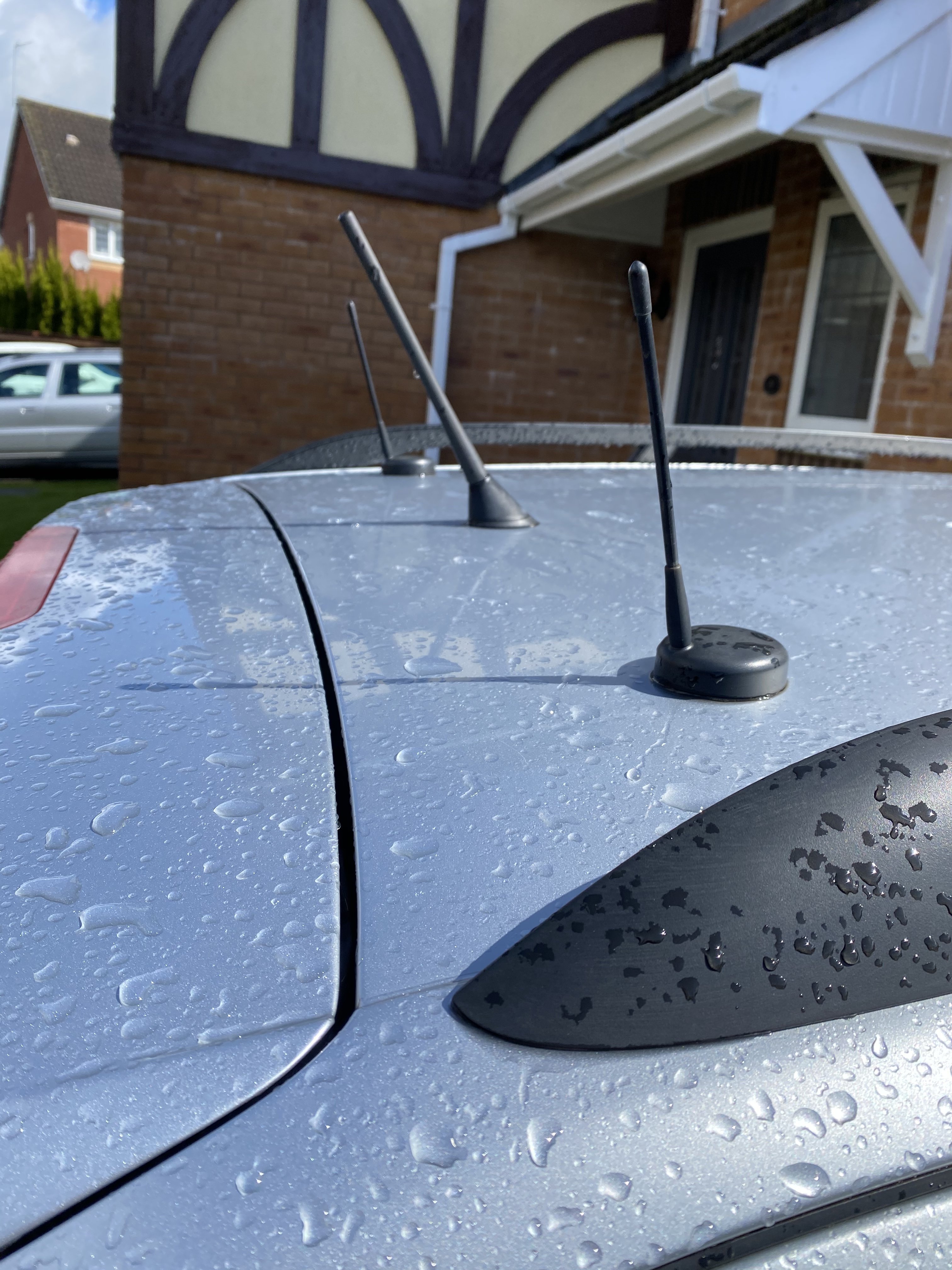

The Car is an ex RRV - keeping a bit of the house 12v system to use when biking with my lad. So I have these that I’m looking to wire for GPS and DAB - will need to change at least one SMA terminal for the DAB USB which came with the stick on antenna. The antennae also have the N Type coax which needs to be rewired to run a signal to a 4g router. All in hold until head unit arrives to determine if it’s all going to fit behind the dash.
Ok. Are they dedicated GPS and DAB aerials then? Or passive?
So long as the aerial doesn't have a filter or amplifier in it then it should work for DAB.
The window mount that my USB DAB receiver came with was appauling and barely worked.
I’m not expecting much from the dab Antenna. The online specs for antennae for Tetra setups don’t stipulate passive and I can’t tell from looking at them. Going to be trial and error and a hunch that the ambulance system would’ve had some form of GPS linked to either of them. There was also a glass mount tucked away on the new a pillar but there’s no info and what and where things were connected to.
Well if it doesn't work out I can highly recommend the Alpine KAE-DAB1G6 kit.
It replaces the amplifier for the rear side window antenna for a passive one.
Then has an active amplifier that sits behind the stereo and splits the signal into AM/FM and DAB.
Signal is crystal clear and no need to run new wires from the back of the car.

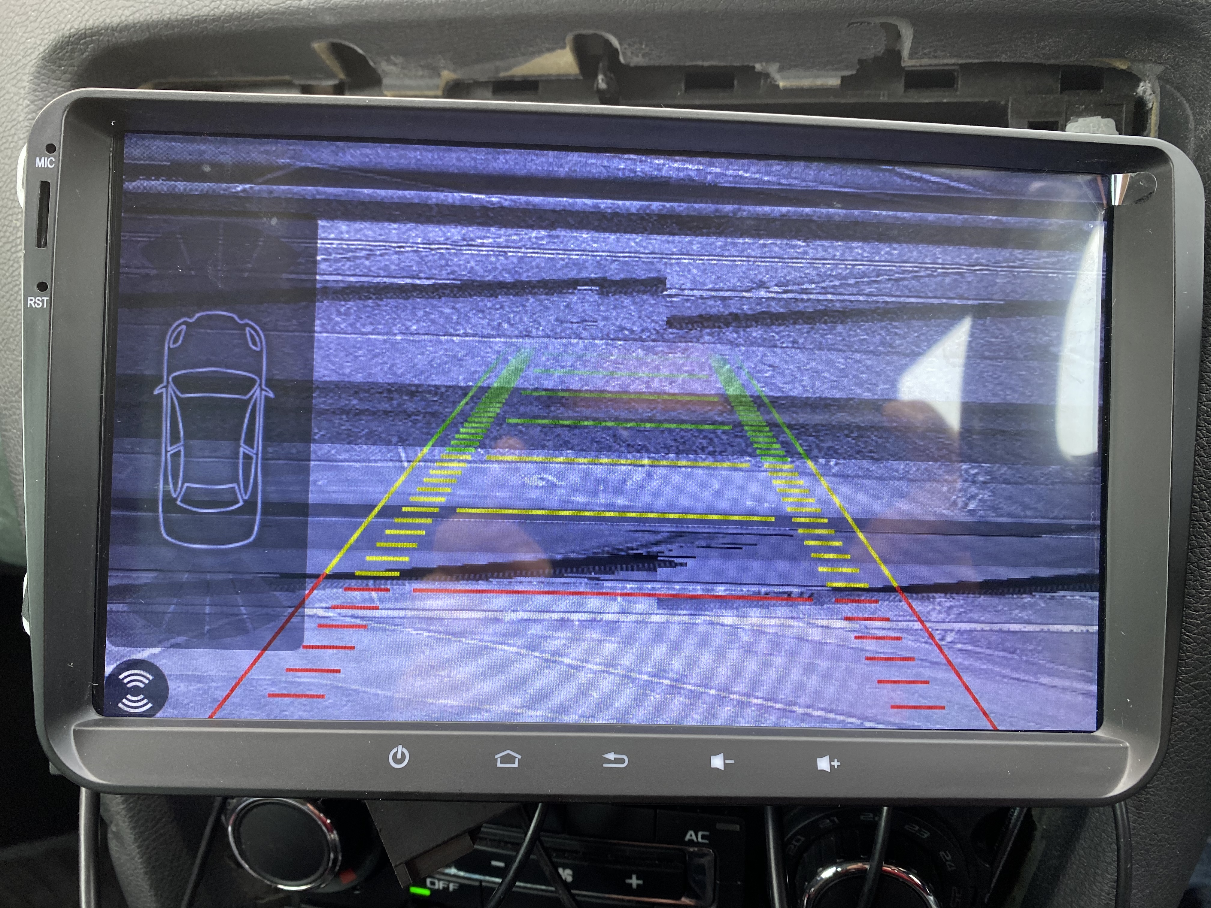

And yup wires worked out ok and head unit is in but this is the rear view .... any thoughts anyone?
Engine off - bad vibes when on!
Did you pick up the reverse signal from the reverse light?
Is there any reverse signal wire on the stereo loom?
Actually. Looking at the listing it doesn't come with a canbus decoder. Is that correct?
In which case it won't have a reverse signal wire.
You'll need to use a relay in that case then and use the reverse light as the trigger for the relay.
It’s got the reverse wire in the media unit - I think I need to redo my connections and also check the extension cable join - it’s crystal
clear when the engines off!

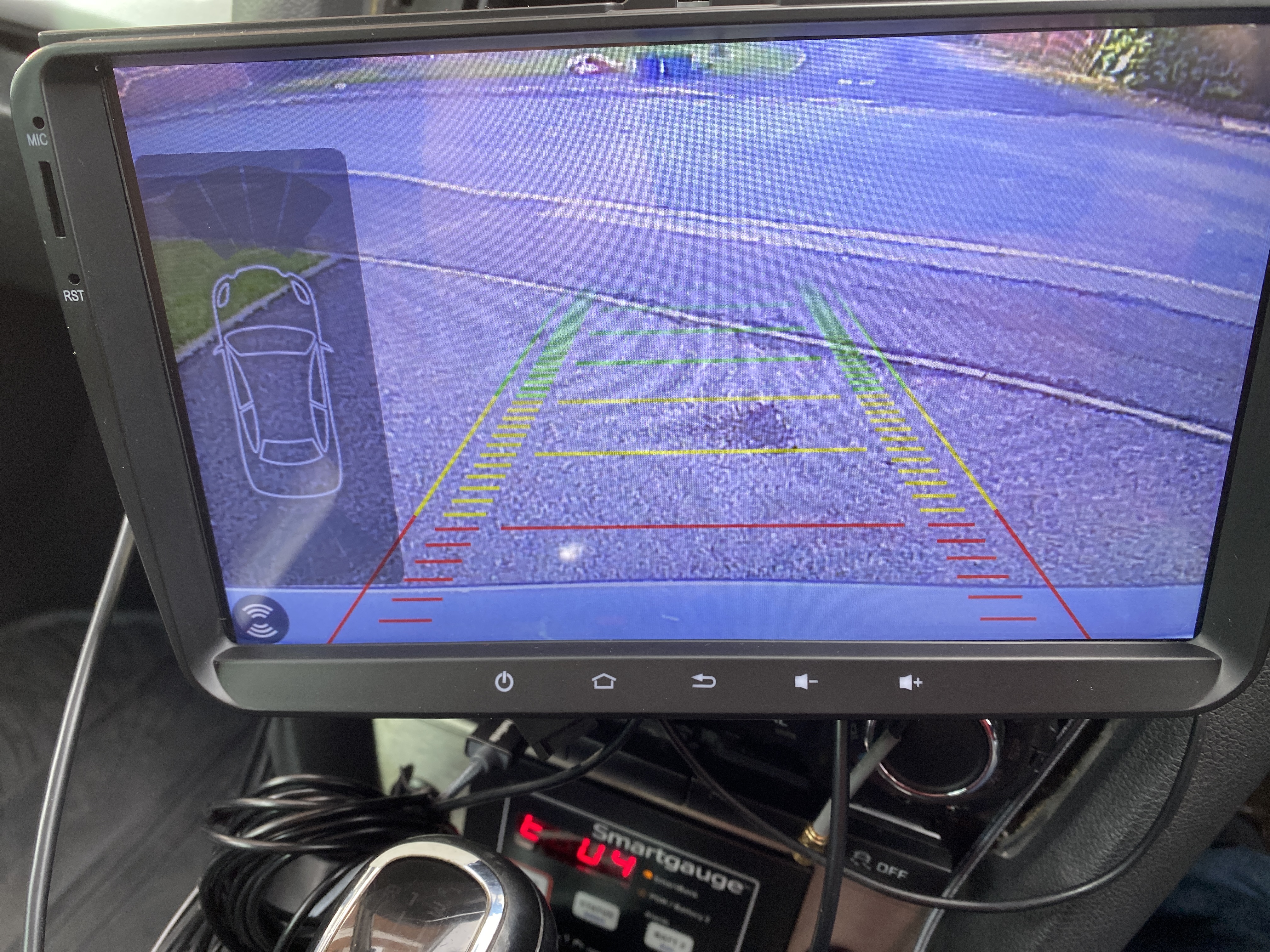

For completness, bought a cheap rectifier from Amazon and no interference

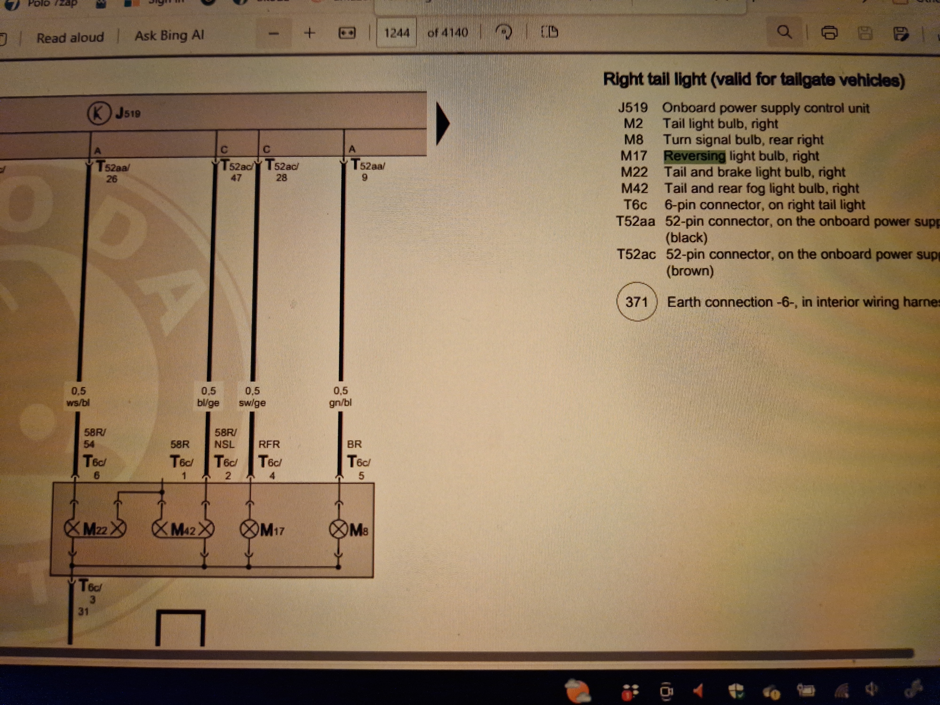

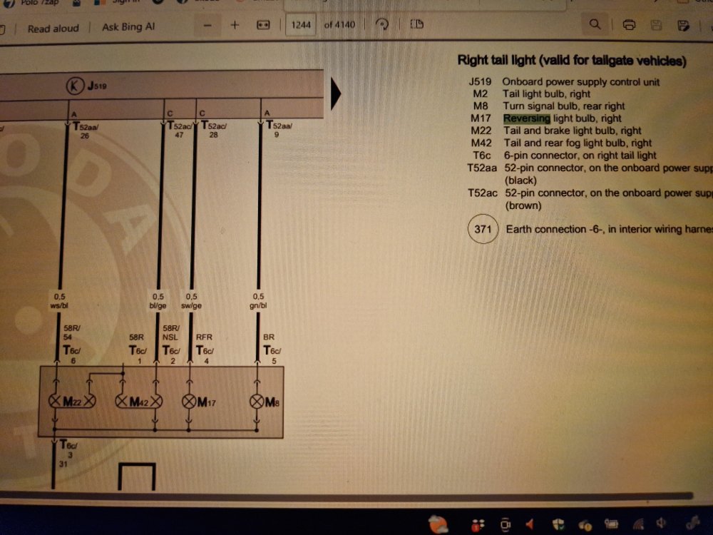

This is incorrect as I discovered. The correct wire for the reverse light is black/blue on pin 2. Using the black/yellow caused the relay I used to buzz incessantly when the lights were on, only stopping when the brakes were applied.
Just a warning for anyone who wants to hook up a reverse camera trigger.
  • Sponsor
Thanks, but there seem to be multiple versions of the wiring, which I clearly didn't realise at the time. One that I looked at, on page 109/21 of the Octavia2 from May 2007> does indeed show it as what I wrote. Shame I didn't check for other, different versions.
