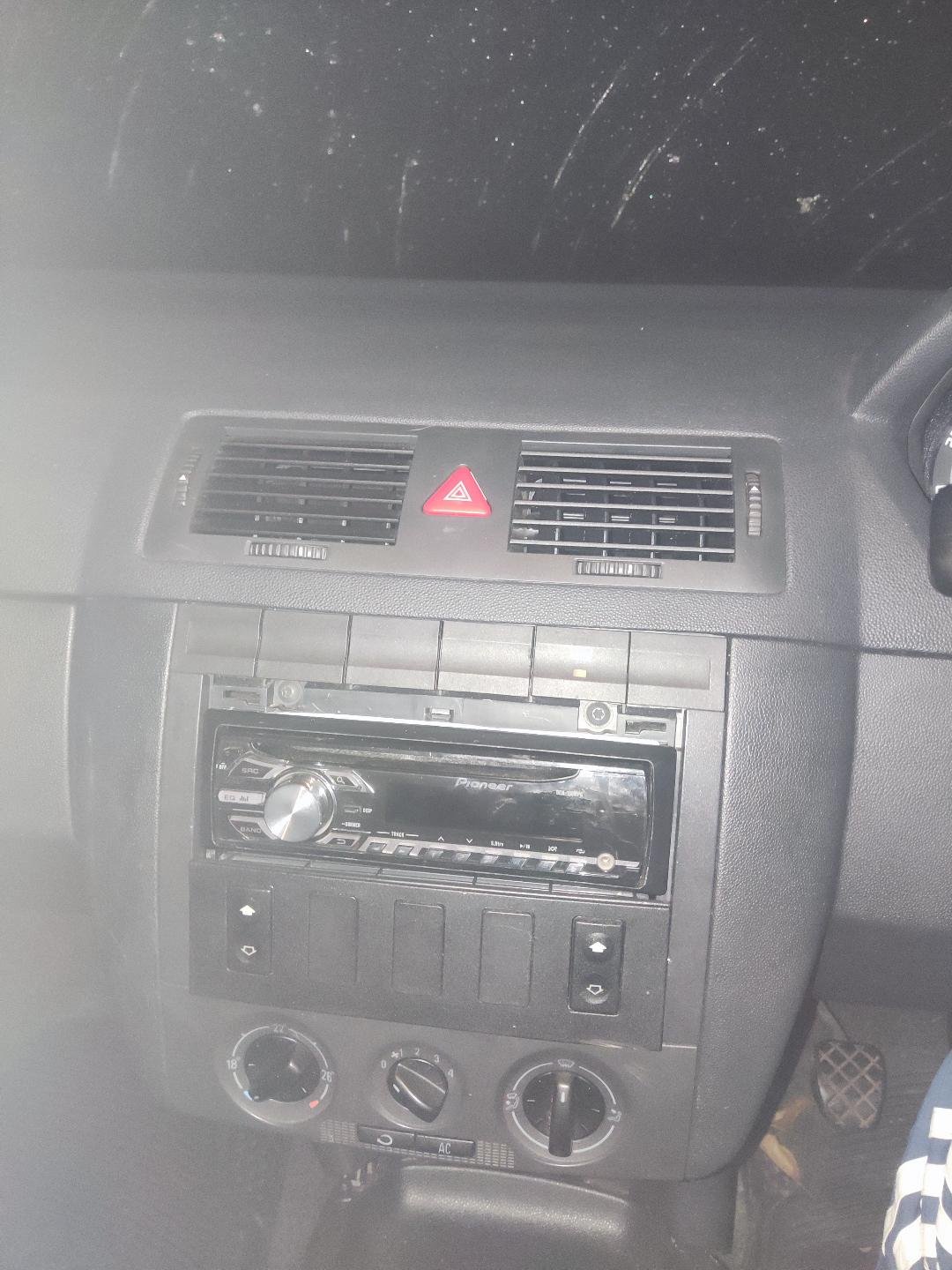

You know your stuff š, Its a sport version. Has weird window switches that have been put in the centre console of the car under the radio. I presume this isn't standard as I haven't seen it on any photos. What's the reliability like on these engines?- Skoda Fabia Mk1 1.4 MPI 16V Exhaust
