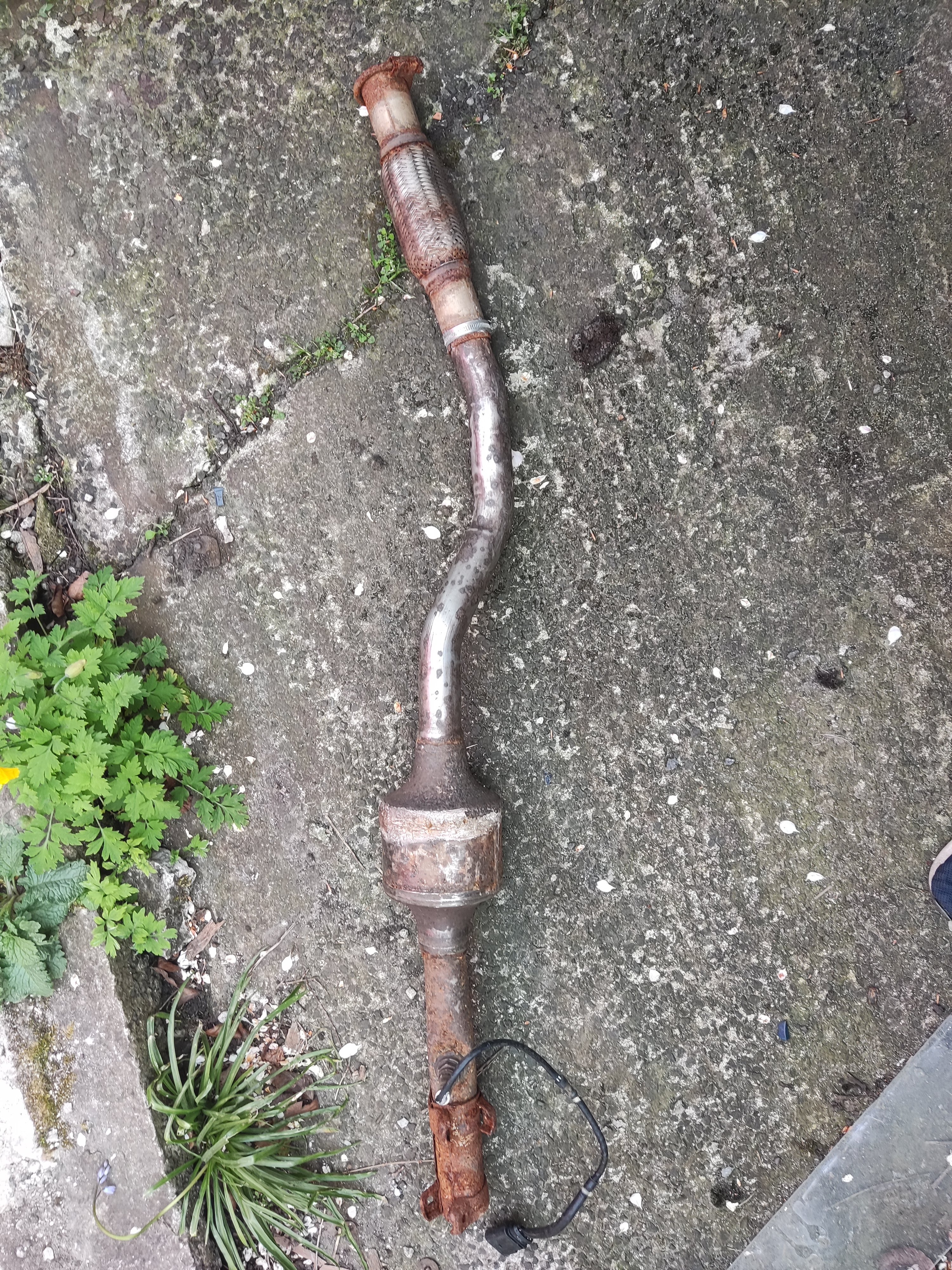

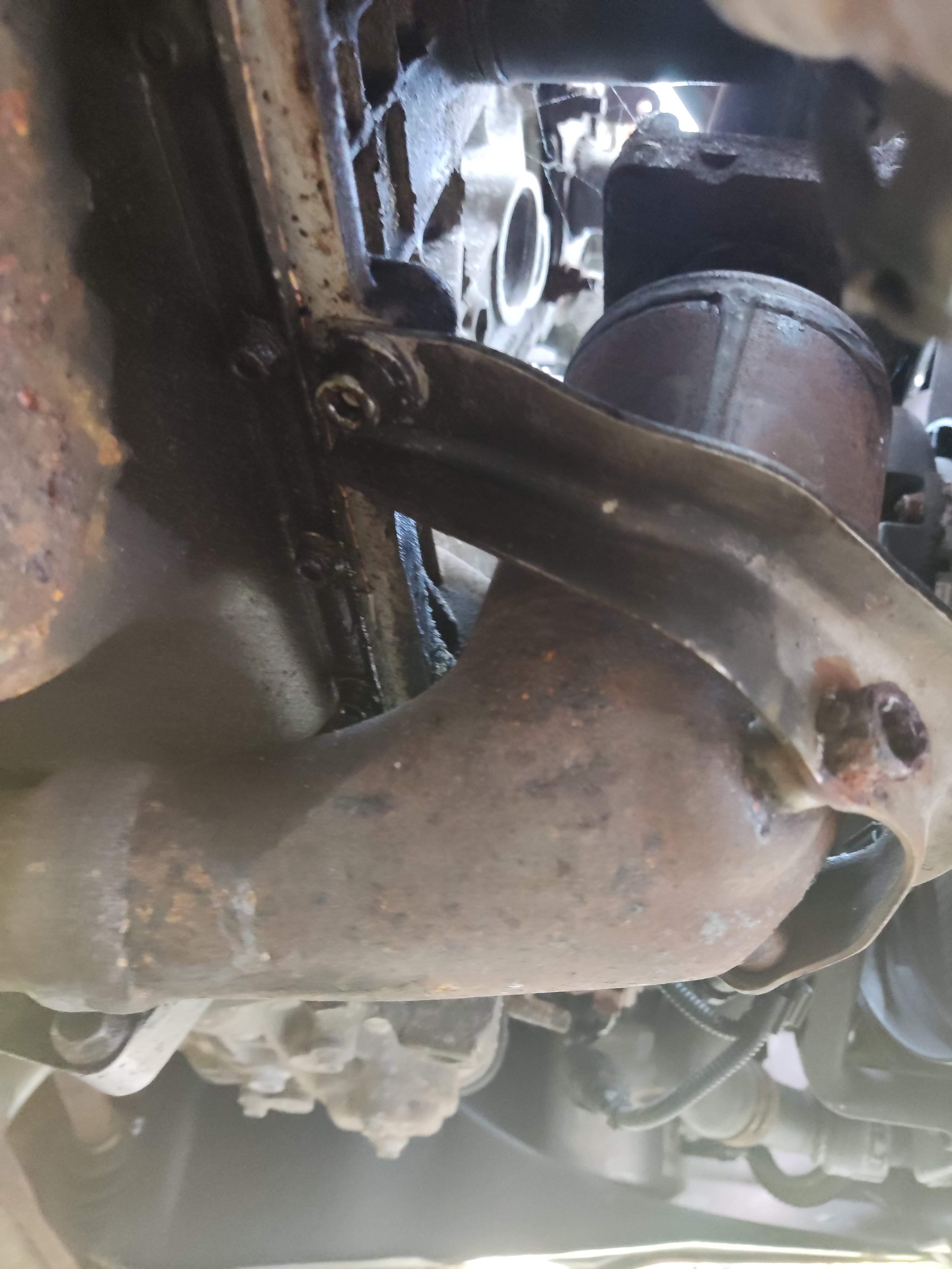

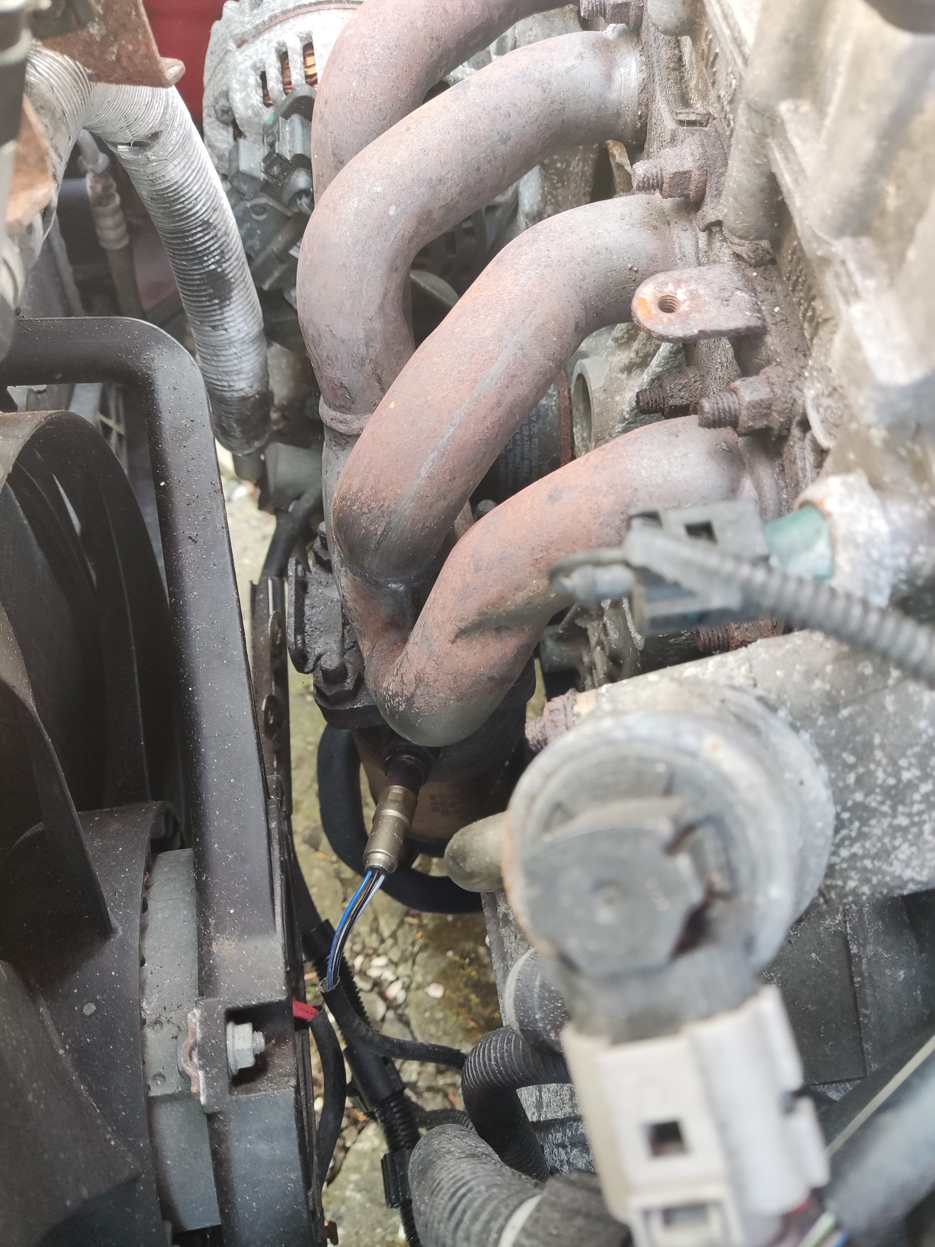

I can't seem to find the same type of catalytic converter or converters as it looks like there's two. One after the exhaust manifold and the other further back in the mid section of the exhaust. The current one is past it with the honeycomb inside being loose. Any help to find the correct one would be great, thanks all!
Picture of the mid section:

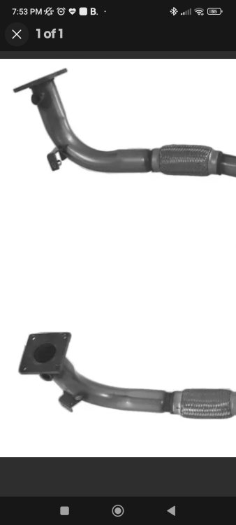

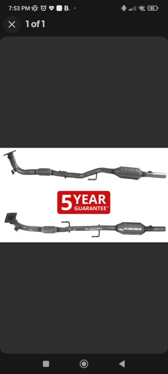

Can find this on eBay but dosent look to have the first catalytic converter.

I think all the aftermarket ones will just have the one, main cat. Should still be OK.
BKY engine, right?
Thanks, yeah it's a BKY engine 75hp, so the lambda sensors will still work as they should with only one cat? Thanks
  • Sponsor
Yeah, I think so. Advantage of the precat is faster action from cold start, but MOT works with warmed up engine, so no problem.
