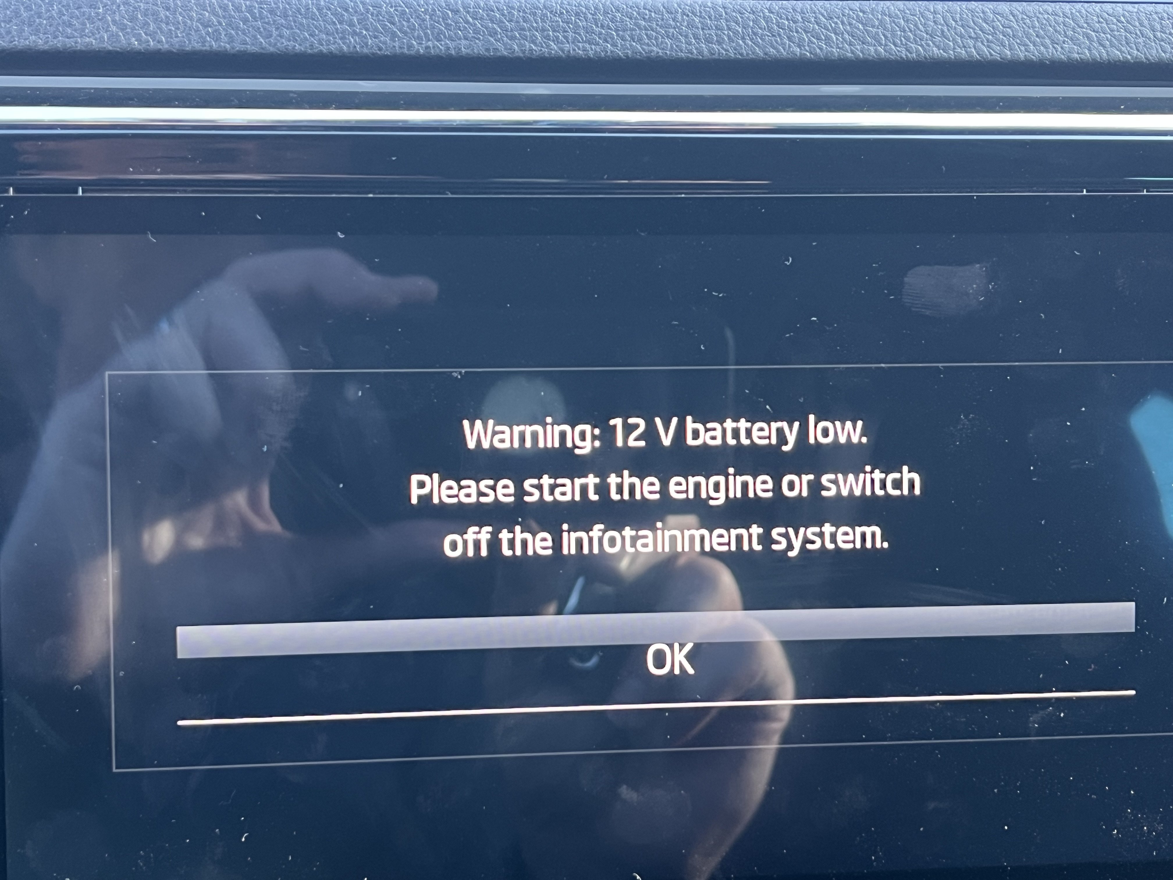

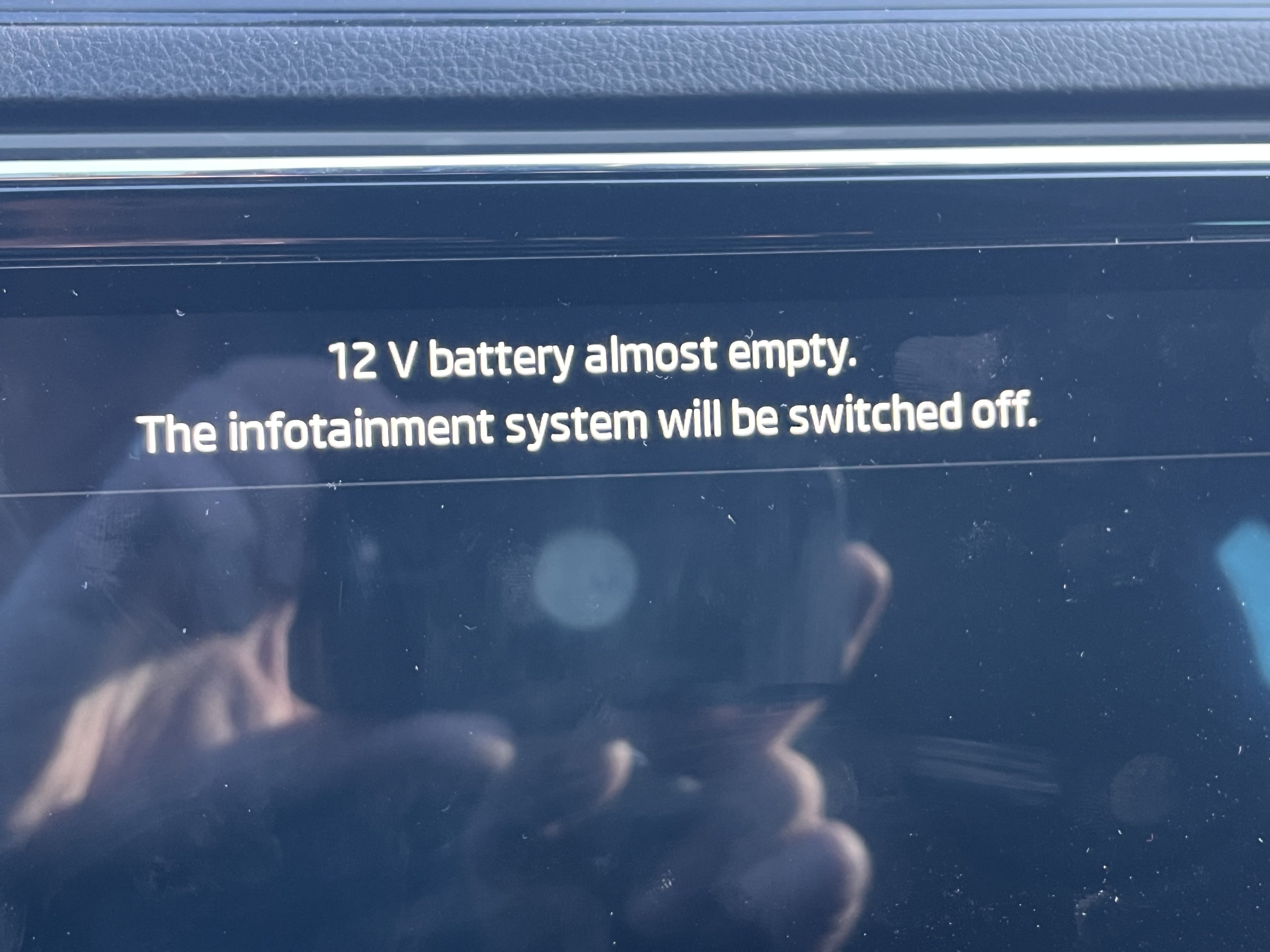

  10. Thank you, new to Skoda and new to forums so appreciate your responce. I've borrowed a 'CTEK' charger and I'm happy to leave as long as it needs - so fingers crossed it should get 100% charge (If it is still capable!). Or should I try the "Reond" setting? 🤷‍♂️ I shall sit and read the attachment - thank you - with a cuppa. What's really frustrating is that it's just had a (50K)Oil/pollen service & MOT!!! Not so sure they checked the battery. I think - according to the Skoda website - battery check should have been done. Anyway not at all happy, but given that it's 6 years old and I haven't treated it 'correctly' I may just have to bite the bullet and buy new - and start a proper regular charge regime !!!! Fingers crossed. I may even update later if all goes well. 🤞🏻 Cheers nta16 👍🏻
  11. Wow 😮 this gets very technical. I started searching about battery problems and found this. It appears my battery is flat. Should I remove it from the car to charge it? Or at least remove all connections and charge it or is there some sort of ‘re-set’ I’d have to do? Is it possible to whip one out and drop a new one in?? If so any experienced advice on which one? 2020 superb est sportline plus (TSI S-A) 190PS. Is an ‘AGM’ worth the extra money for stop start feature? Thanks
  12. Yeah, shoddy to say the least. What compounded it for me was the next day, trying to put the navigation updates in and the display shows ‘battery low’ !!!! Despite driving it for an hour it was dead flat the next morning. I have written (email) asking for an explanation but yet to hear. I had all this dealership stuff (lies etc) with Harwoods landrover Crawley years ago! Thought skoda would be better. Very dissatisfied. Waiting for the “How did we do email” ……….
