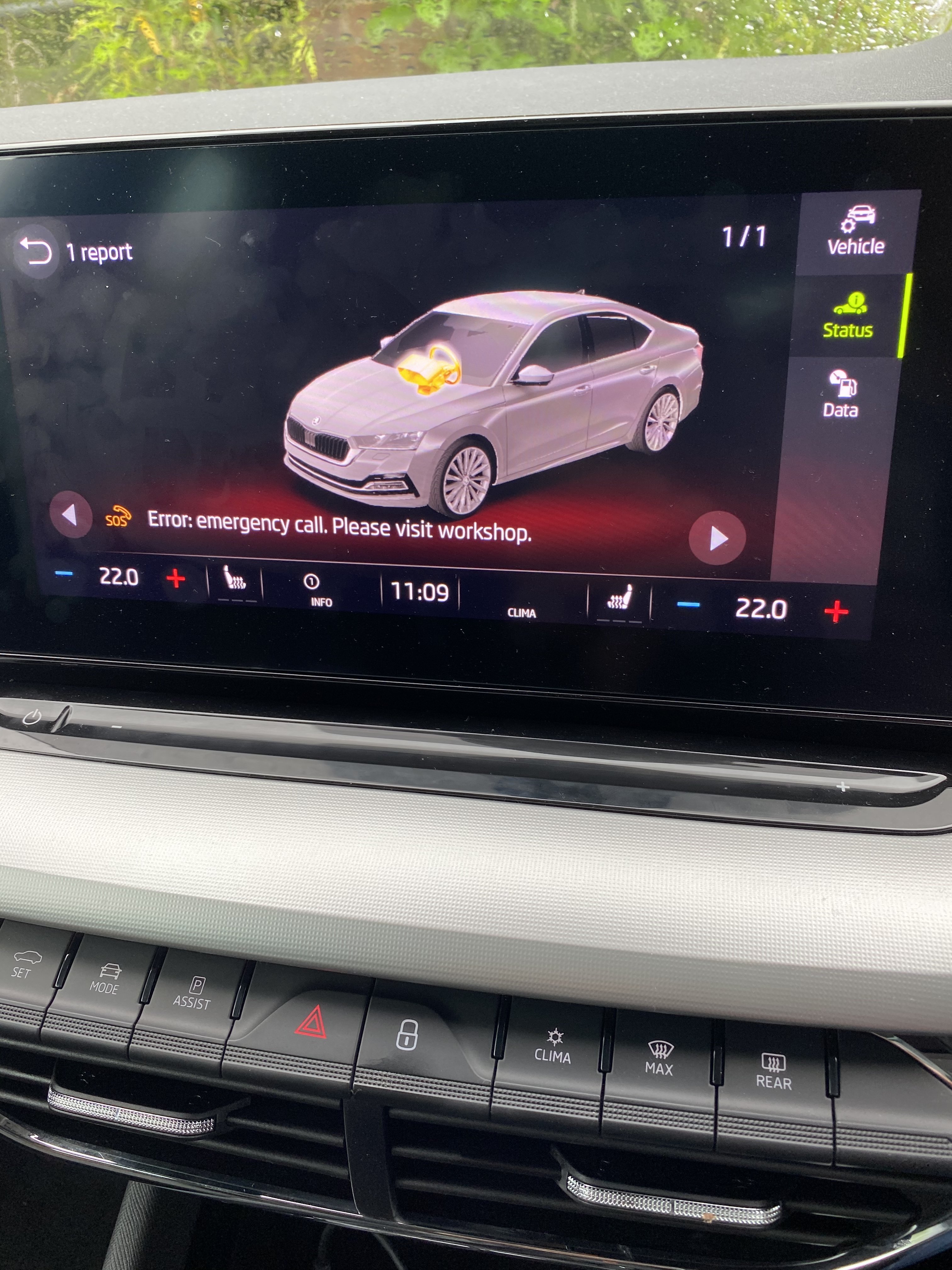

My car went in for a specific software fix to deal with the popping /SOS fault. No change recorded on the software versions listing but my car has been problem free for several weeks since the update

I hate to tempt fate but yes my car was booked in for a specific software-only update to solve this problem. So far it hasn’t happened again since the update

Ah that’s bad on Skoda’s account. I would report that back to the service/repair centre. I can only presume that’s there’s a specific software module for this fix and that wasn’t part of the upgrades they did. Hopefully they can fix it with another visit 😬. No recurrence for me since I had the software fix. Good luck.

This is what shows on my system screen which I believe is unchanged. The guy at the service centre said it was caused by the switch over to 5G masts by some service providers. The double click was caused by a control unit that connects with Skoda central not working properly due to these changes. That’s why lots more people are reporting the sos system fault.

Ok so I had my software update on Friday. 300 mile round trip yesterday fault free and no problems today on 2 journeys. I’m hopeful that the SOS fault issue is fixed. 😀- Weird clicking/popping sound O4, vRS Estate Petrol DSG

Hi everyone. I am a new Octavia owner 2.0tdi 150hp SEL manual hatchback. The car is 1 month old c 1000 miles. I love the car but have had a few issues in the last few days. 3 reported faults 1x oil sensor fault, 2 x error emergency calls. Also my user settings temporarily lost along with some digital display features. After a few hours these faults disappeared when the car was next started up. The first time this happened I booked a service visit, then cancelled it when the fault warning disappeared. Also, I have noticed sporadically a couple of loud cracks in quick succession. Sounds like a stone hitting the roof or windscreen, or maybe the door locking activating (it isn’t this) Does any of this sound familiar or has engine else experienced these issues? As the car is new I’m not sure if these are just software related bugs. One image example attached Any thoughts appreciated. Thanks - Weird clicking/popping sound O4, vRS Estate Petrol DSG
