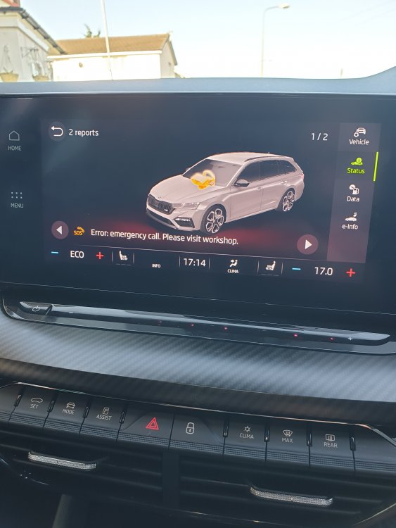

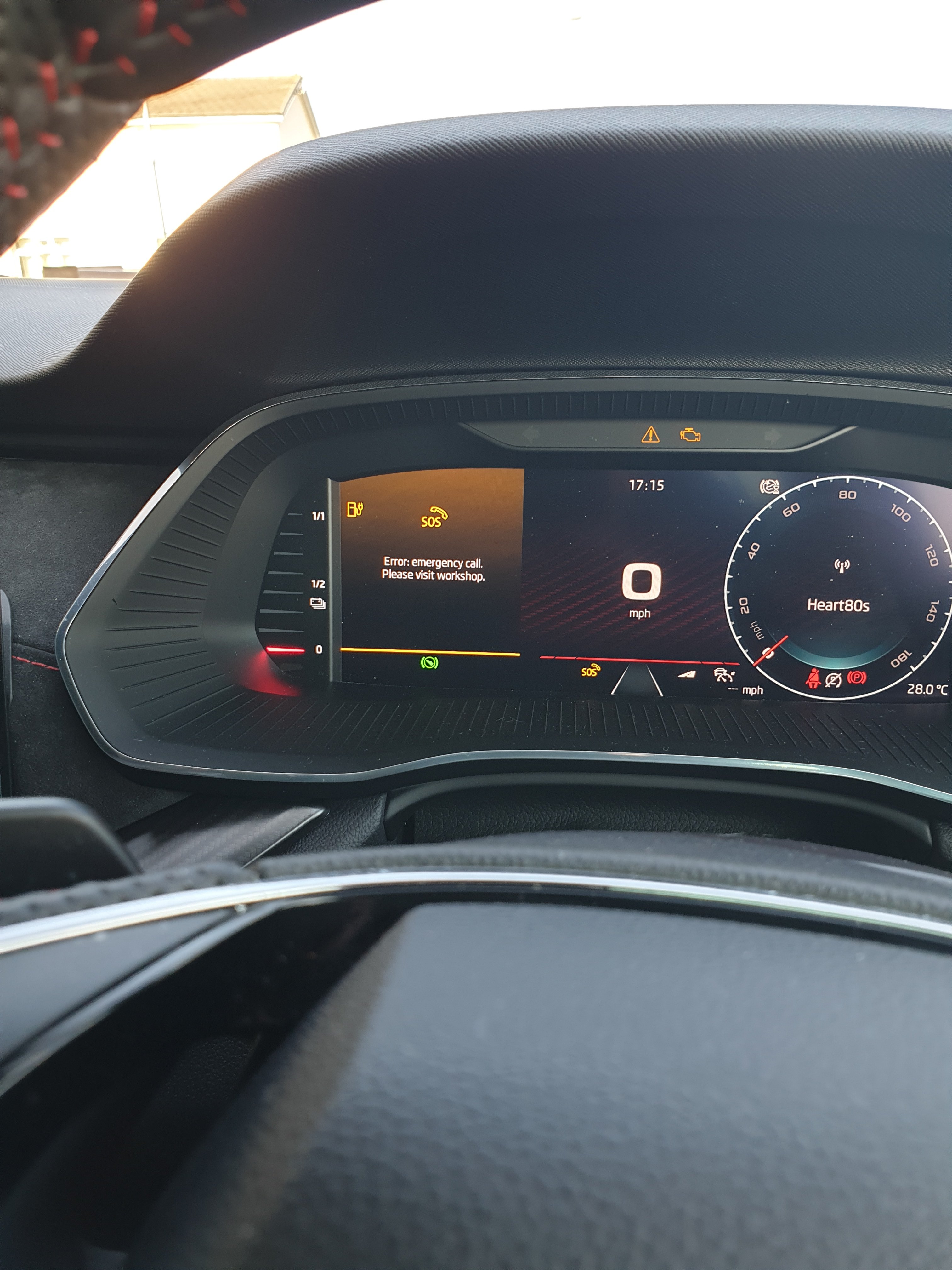

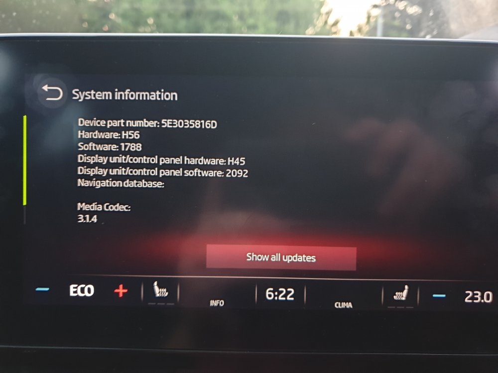

Any idea what the latest update is and how far mine is back? Keep having issues that are discussed on this forum like popping, SOS issues, user going onto guest mid-drive etc.

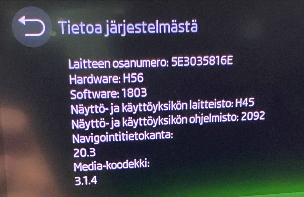

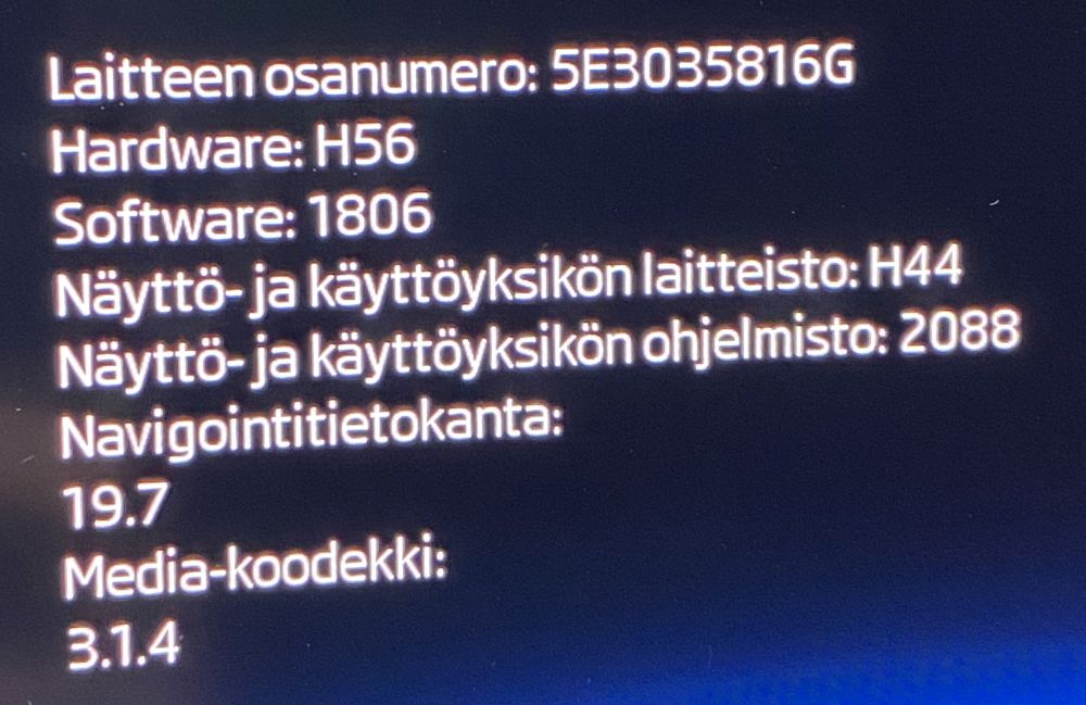

    You can get the list of PR Codes by signing up to Erwin and spending 7 Euros   https://erwin.skoda-auto.cz/erwin/showHome.do   Also take the opportunity to get hold of as many usef
There is 1803 and 1806, but I don't know which hardware revisions get which versions, it's all over the place.
Also worth remembering that there are many components that get updates which aren’t reflected in the version number displayed/photographed.

I have the same infotainment software version as You do. My vehicle went in for the SOS fix (All day) last week. Whilst there was a software update loaded, this did not impact on the infotainment software version, that remained unchanged. However,  whilst still early days, I used to get the popping and sos faults at similar points on my Portsmouth to Gosport commute. So far no popping or SOS faults despite several commutes. Interestingly I did get a message on the infotainment this morning advising of a new headlamp main beam upgrade installed?

My car went in for a specific software fix to deal with the popping /SOS fault. No change recorded on the software versions listing but my car has been problem free for several weeks since the update
Just as comparison. Two weeks old Style iV
About the same age RS iV
Our 2020 Octavia had it's first service yesterday and had 5 software upgrades due. We had the same SOS problem and the parking sensors were only working intermittently. We also had it emergency brake for no reason, which is downright terrifying.
Since picking it up, none of those faults have been rectified (time will tell if the emergency brake has been fixed) and we now have:

Our dealership said today that there is no known fix for the SOS fault. For all other faults we need to contact Skoda directly. We've had Skoda Octavias for 14 years and this has really put me off buying another one!

My dealer in Fareham had my car in for a software update back in June (all day) My screen was locked following the SOS glitch, they did state at the time that this update was unlikely to resolve the SOS issue but it did clear the locked screen and updated some other systems. They advised that a fix was on the way and I would be contacted when available, although I did have to prompt them earlier this month. My Skoda went in for a specific SOS fix 10 days ago, whilst I still have the occasional minor infotainment glitch, I have not had a repeat of the SOS issues, I used to get these quite regularly at similar points on my commute, but none since the fix, fingers crossed that this remains the case. I suspect your dealer is trying to pass the buck here. There does appear to be a fix.

My dads Octavia 03/21 got the 1803 before our holiday to Scotland we did 1600 odd miles, SOS issue definitely fixed.

For your car you have 1806. So let them update of Update it for yourself.  It solves a lot of issues:

Not sure if you meant that to be a suggestion for me but mine was upgraded from 1788 to 1803 only two weeks ago and the infotainment control unit was replaced, after waiting over 2 months for the parts. That cured several faults that I had been having.
I will wait a while before looking for further fixes. Updating yourself to 1806 is, as far as I know, not possible here in Australia.
