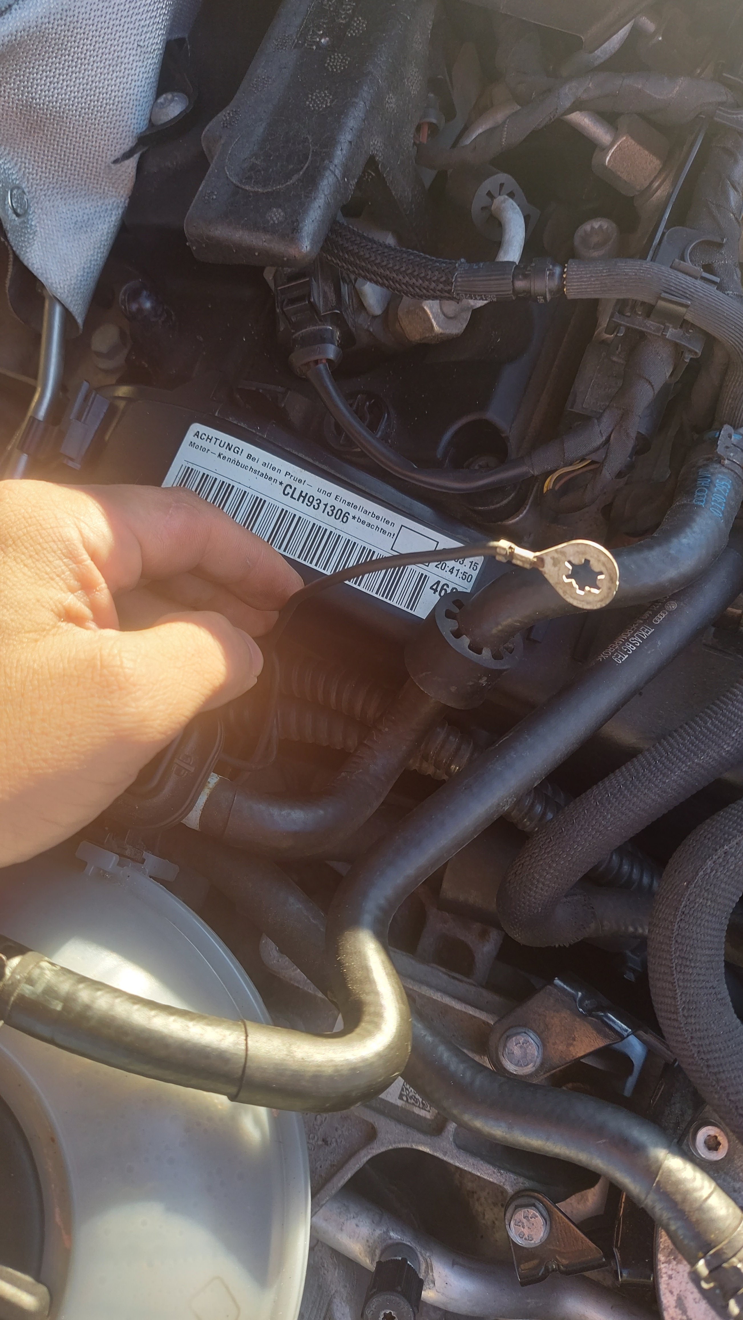

A Dingling Cable, What is it and where it is supposed to go???HELP!
20230810_082003.heic20230810_082003.heicHej Guys! I was at the dealership today and the technician grounded the cable. It was a ground cable for the block heater ( oil sump). Thanks for the help! 20230810_082003.heic 20230810_082009.heic
I should thank you guys. I have read some comments on swedish forums about those external heaters shorting and causing seirous damage to people, hospitalizing people. I will not plug the system until the mechanic grounds it, i can assure you of that.
I made a video about the cable , so you can see what I mean https://youtu.be/Rxpebjj9g5A
Guys, I really appreciate you. This forum has been a fantastic place for me to learn and share. We all want to help each other. I am almost sure that the cable is from the external heater and I would ground it today but I was unsure where to bolt it to. There is a very visible ground point that i can see the vw brown cable is bolted , beside the expansion tank. I am unsure of bolting it there or another spot. I will ask the technician next Wednesday when I am the dealership. I have plenty of time until November, I usually start to use the heater in winter.
Thanks for the concern ,i appreciate it. After seaching for those oilpan heaters website, i found out that it looks like their gound cable. I measured it with a multimeter when the engine is on so it is not a cable that is active. So 99% sure that it is the ground cable to those external heaters. But i booked the car for a brake fluid change at the dealership in two weeks, i will definitely ask them.
What do you mean?
I use them in winter time when the weather starts to get colder than minus 10 or minus 15 Celsius. They worked almost without problem each time, but sometimes the earth fault breaker on the wall would pop... Now i have some guess about why it did that 😃 My guess is when the dealership did the cambelt and the waterpump, the mechanic unfastened the cable, because it was on his way , then he forgot to fasten it back .
Thanks for the replies and help. The cable is coming from the same cable harness as the aftermarket oilpan heater and cabin heater so it should be the earth cable to those components. I compared some pictures of the engine bay with other Skoda Mk3s , VW Golf 7s and none of them had those cable harnesses beside the expansion bottle and timing belt cover, except for the swedish ones with motor heater units installed . There is a hole in the chassi behind the expansion tank and I am planning to make a ground connection there with that cable, just a bolt and a nut to fasten the ground cable. I can attach a picture when i am done tomorrow.
I should add that I live in Sweden and my car is equidded with auxiliary oilpan heater and cabin heater . Can it be the ground cabel for those components?
Hello Guys! I wasjust checking the engine bay casually and came across a black cable just hanging around loosely beside the timing belt cover . Where should it go? Where do i fasten it? Car runs fine and no issues.
