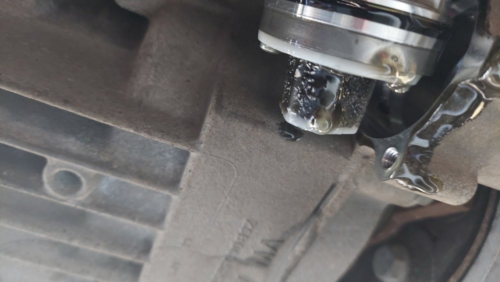

  17. Hi guys! Just did my first haldex gen 5 service . The pump was changed 27000 km ago. And as you can see in the picture , the little filter is full of ****. So glad that i cleaned it, in with the new oil, pump the motor with vcds and fill it again. I managed to fill about 700 ml . The oil that came out was about 550 ml. I guess they didnt bother to fill again after priming the pump .

    Hi from Sweden! Just did my first haldex gen 5 service . The pump was changed 27000 km ago. And as you can see in the picture , the little filter is full of ****. So glad that i cleaned it, in with the new oil, pump the motor with vcds and fill it again. I managed to fill about 700 ml . The oil that came out was about 550 ml. I guess they didnt bother to fill again after priming the pump .
  19. Hi from Sweden! Just did my first haldex gen 5 service . The pump was changed 27000 km ago. And as you can see in the picture , the little filter is full of ****. So glad that i cleaned it, in with the new oil, pump the motor with vcds and fill it again. I managed to fill about 700 ml . The oil that came out was about 550 ml. I guess they didnt bother to fill again after priming the pump .
