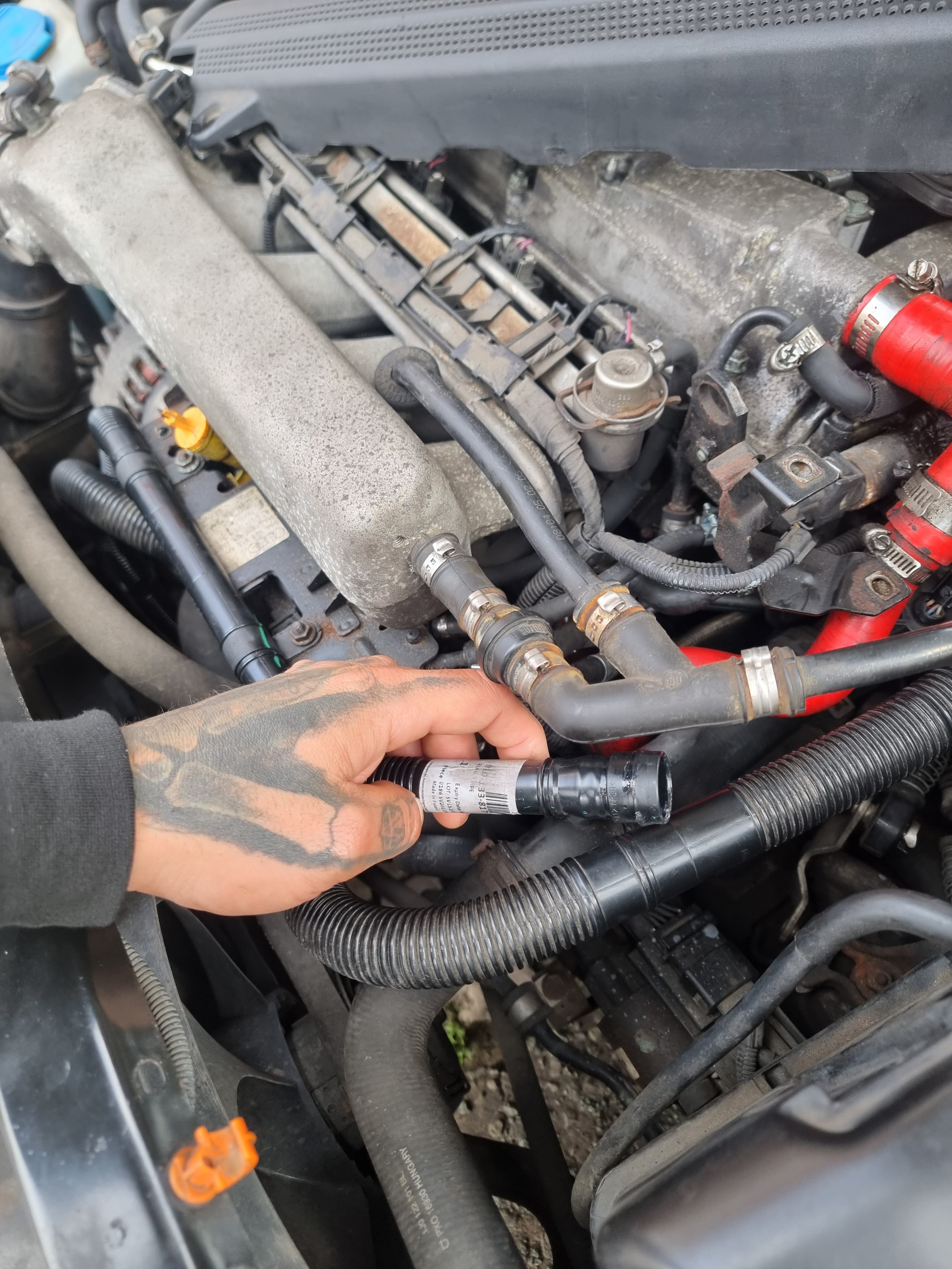

  7. I've done some research since and yes the pipe in my hand is the pipe running from the sai... then between that and the combi valve is a smaller pipe and that was the one that was brittle and cracked so I've orderd a new one.... I didn't know whether that would cause running issues but when I filled the whole in the combi with my finger while the engine ran it then ran quiet and there was no shake anymore so I'm thinking it's got to be that!!.. I didn't realise how much the sai system can effect the engine!

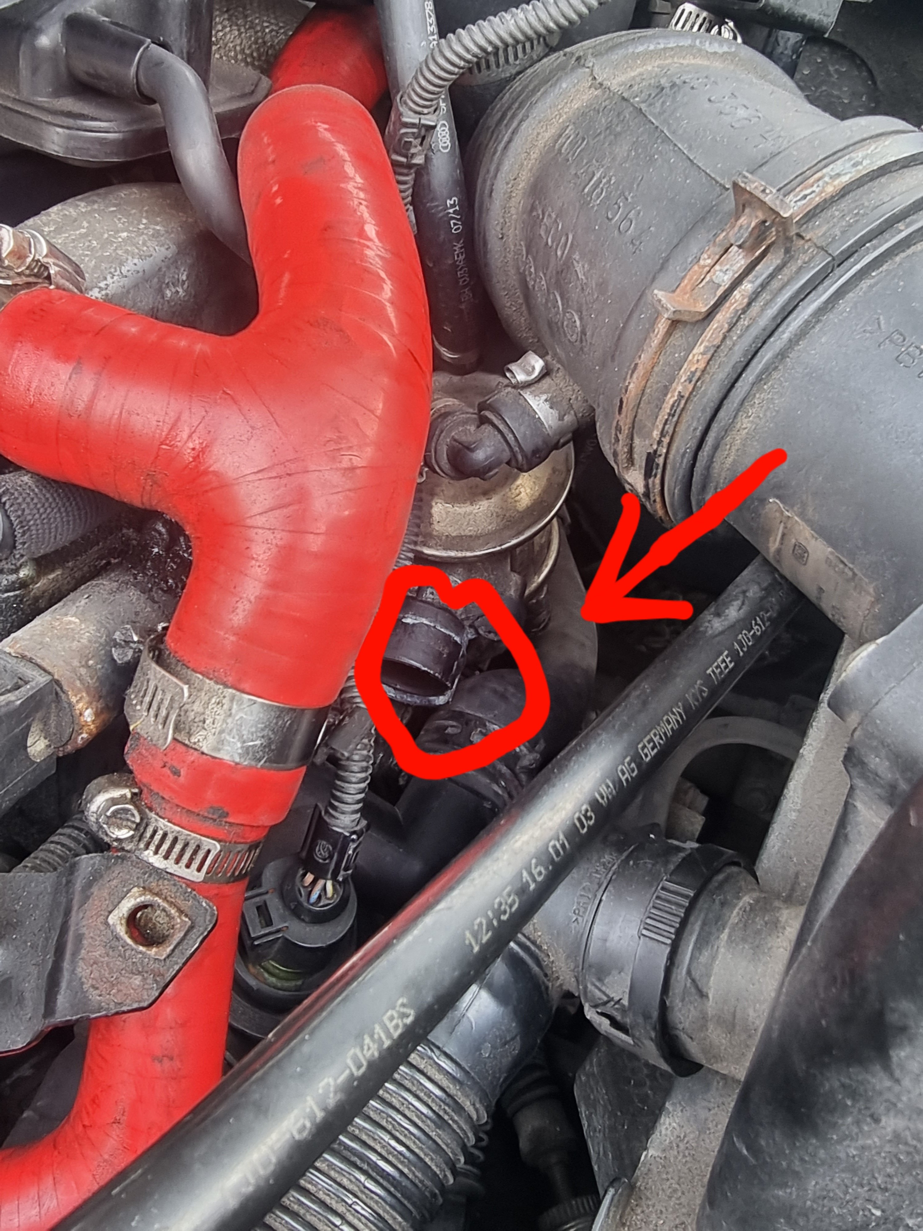

  9. After more inspecting today we found this pipe and the smaller pipe connected was cracked!.... could you tell me if this pipe not being connected via a smaller pipe to the hole in question (circled red) would cause my issues??? When i put my thumb in hole the engine seem to run better straight away!

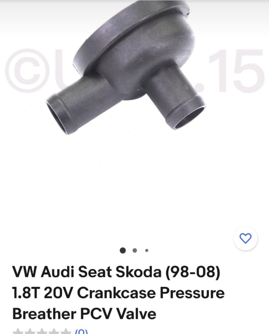

  12. I've read that about throttle body.. that's the next thing we will be trying too I've attached a pic of the pcv valve ive ordered... hopefully it does the trick. The first garage I went to seem to just give up... he got those 3 codes and said it could be 100 things and lost interest. It's frustrating to say the least

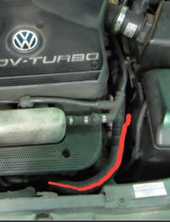

  13. Hi mate.. sorry for late reply.... my car is on a friend's drive so I've taken a pic off Google to show you which pipe was replaced...its booked in to vag car but they can't look at it until the 13th of July as they are so busy so it's a looooong wait. a friend of mine is suggesting it may be the pcv valve so I've orderd one today.. I'm hoping that's the culprit as its a cheap easy fix... I'm dreading the bill from vag car but on the other hand I'm ready to pay it as I miss the car so much 😔
