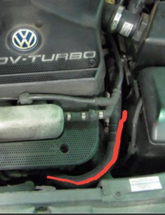

Hi mate.. sorry for late reply.... my car is on a friend's drive so I've taken a pic off Google to show you which pipe was replaced...its booked in to vag car but they can't look at it until the 13th of July as they are so busy so it's a looooong wait. a friend of mine is suggesting it may be the pcv valve so I've orderd one today.. I'm hoping that's the culprit as its a cheap easy fix... I'm dreading the bill from vag car but on the other hand I'm ready to pay it as I miss the car so much 😔

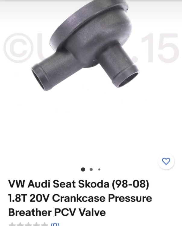

I've read that about throttle body.. that's the next thing we will be trying too I've attached a pic of the pcv valve ive ordered... hopefully it does the trick. The first garage I went to seem to just give up... he got those 3 codes and said it could be 100 things and lost interest. It's frustrating to say the least

Can't see any pcv piccie I'm afraid, but hope the rest helps.
Il bare that in mind and thank you for the advice it's very much appreciated 🙏...  pic attached again

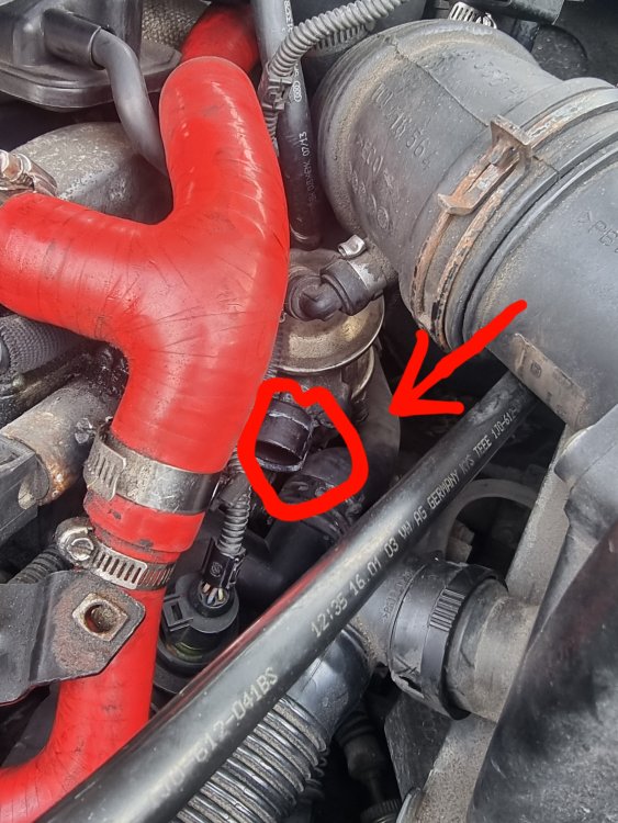

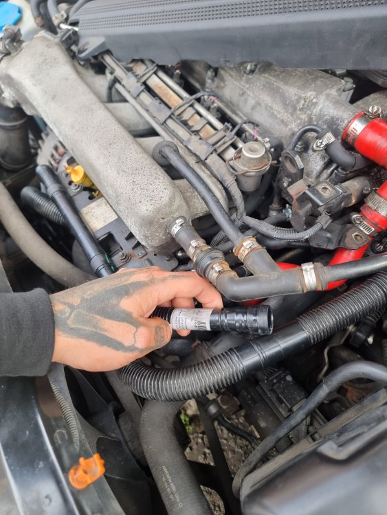

After more inspecting today we found this pipe and the smaller pipe connected was cracked!.... could you tell me if this pipe not being connected via a smaller pipe to the hole in question (circled red) would cause my issues??? When i put my thumb in hole the engine seem to run better straight away!
If that is a corrugated pipe in your hand, (not easy to see from the picture), then that is an sai pipe, one should go from the pump to the air box, the other should go to the combi valve that you have circled - see here - https://skoda.7zap.com/en/cz/octavia/oct/2003-252/1/131-131007/
Any unmetered air is going to give you running issues, and that will be a big one assuming it is standard.
I've done some research since and yes the pipe in my hand is the pipe running from the sai... then between that and the combi valve is a smaller pipe and that was the one that was brittle and cracked so I've orderd a new one.... I didn't know whether that would cause running issues but when I filled the whole in the combi with my finger while the engine ran it then ran quiet and there was no shake anymore so I'm thinking it's got to be that!!..  I didn't realise how much the sai system can effect the engine!
In the link you sent it was 8a that is looking like the culprit 🤞🤞
The combi valve on the engine opens to allow extra air into the combustion process for when the engine is cold to aid emiisions. having no pipe there is going to be a big issue which it would appear you have found. looks like problem resolved once you get a pipe on. 👍
