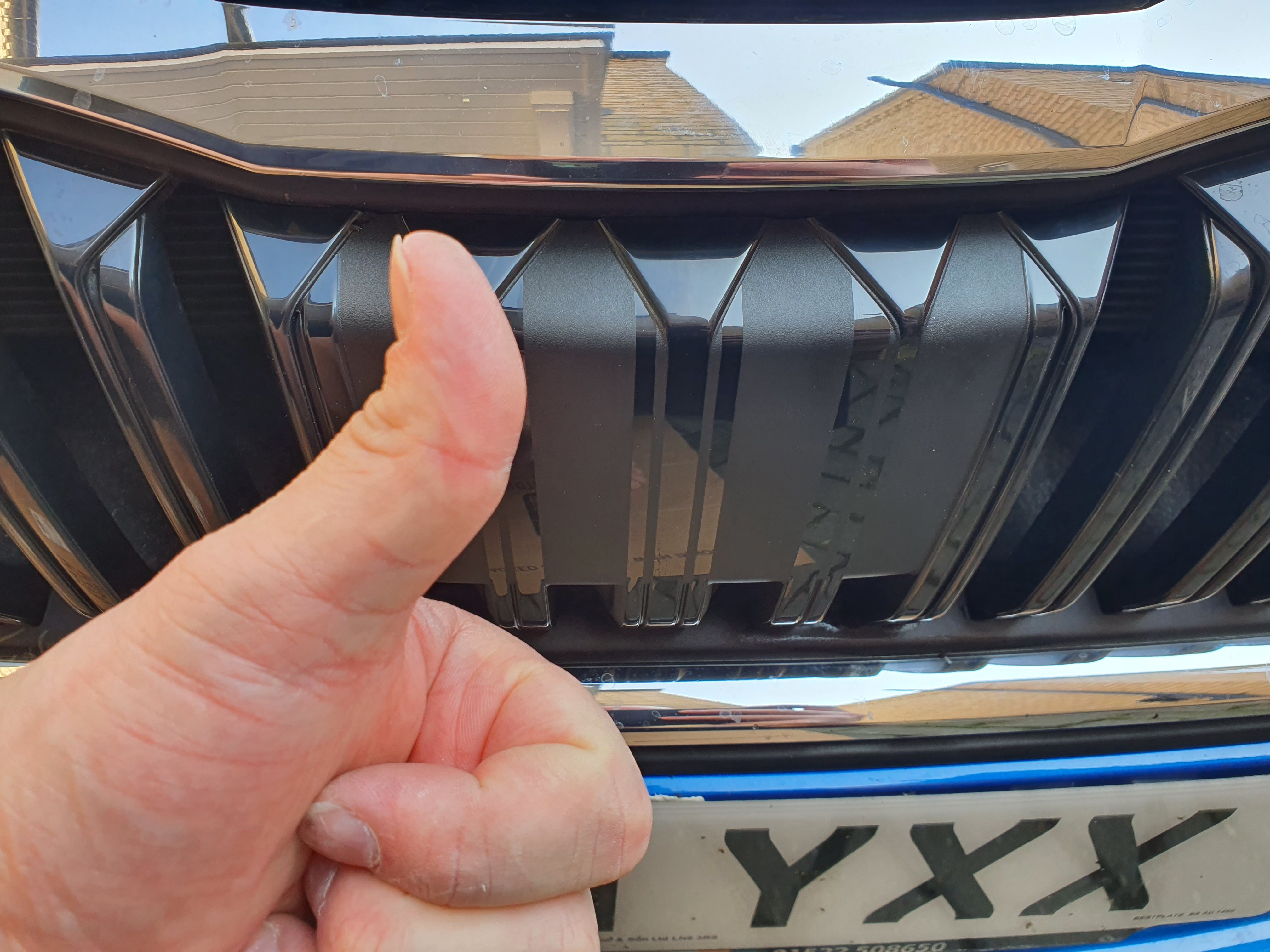

  7. Finally got round to replacing the radar cover 😁

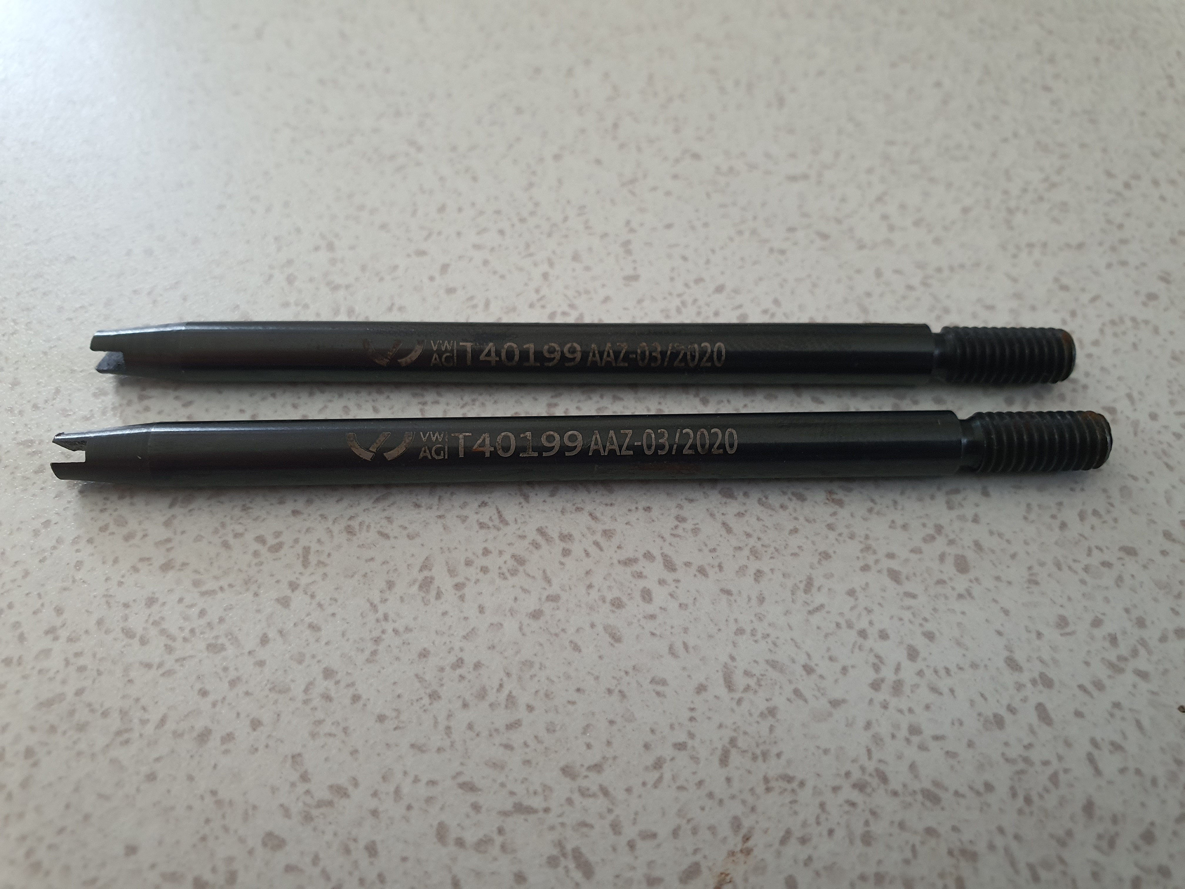

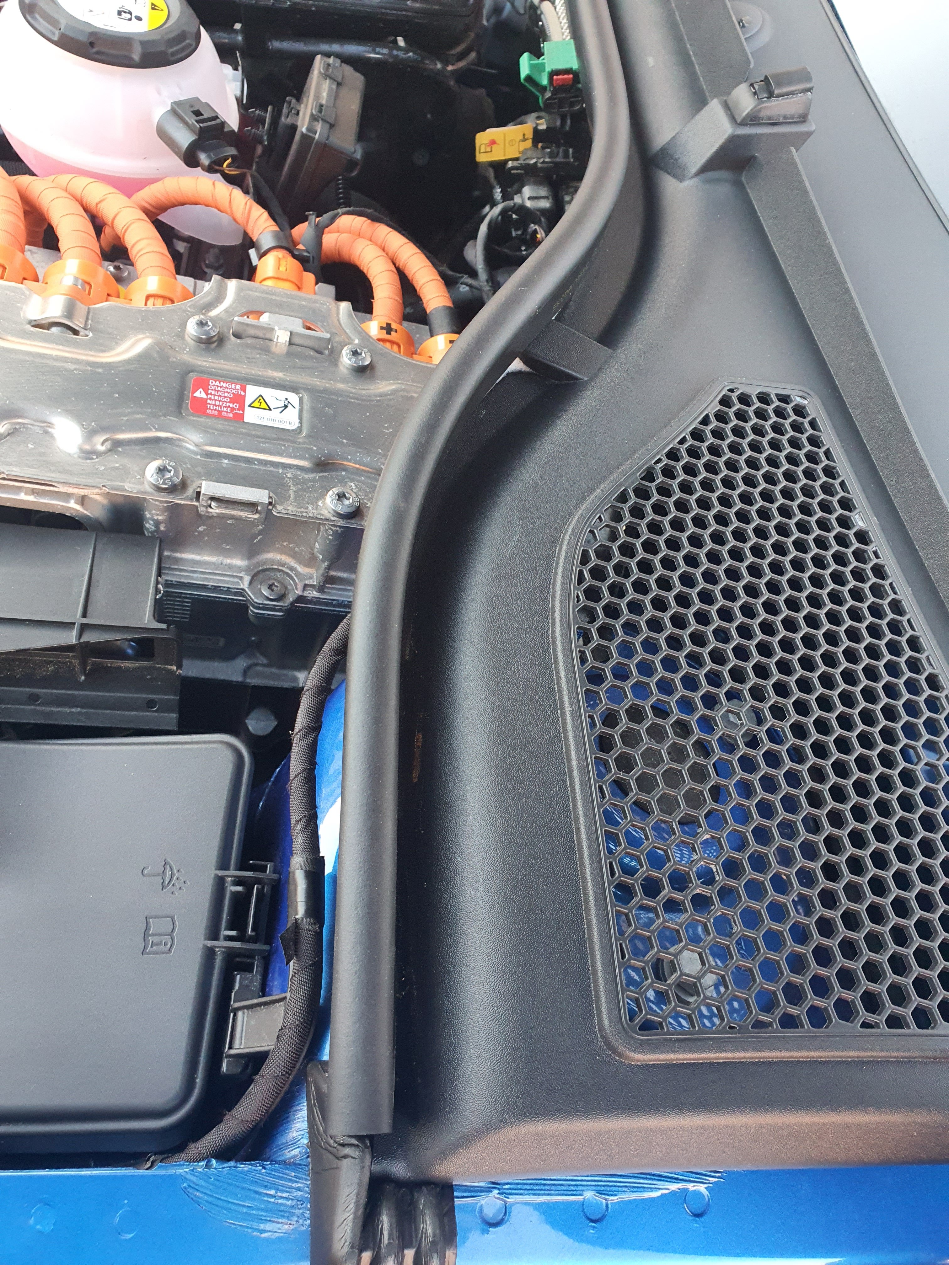

  9. Mine was down again on monday, finally gave up and pulled the fuses yesterday morning to get the connection back. Had lots of loud popping sounds during the week while it wasn't working too! Decided to give her a clean after sorting thr connection out and found some "transmission oil sump install pins" wedged in the rubber seal (that I also had to re-attach) around that tray that catches the water from the windscreen(you can see the rust marks on the plastic) they must have been there since the car was built 😲

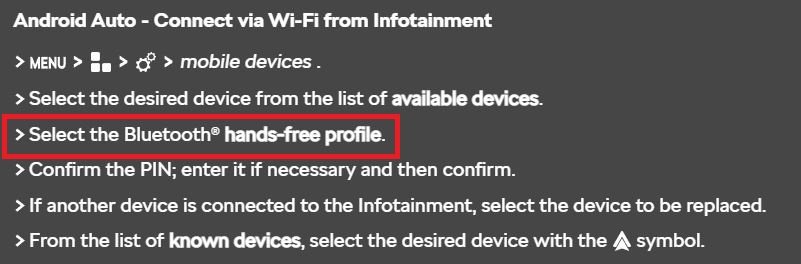

  12. That's the screen i get when i select Android Auto so I'm guessing you have the WiFi completely disabled, this will likely need a trip to the dealer to sort. I'm almost certain i read someone else had a similar issue and the dealer sorted, you could probably do it with an OBdeleven as well. This is what my menu's are like
  13. Hmm, it seems mine is very different to how i originally remember it. I've just been out and disconnected both my WiFi and Bluetooth, I've "unpaired" and "Forgotton" all bluetooth and WiFi to the car and started again. I clicked the Smartlink option and it simply told me the following. I picked Skoda 2968 for both WiFi and Bluetooth, accepted when it asked if the codes were the same and it connected immediately
  14. It's the part in red i remember being a strange name so, it's a bluetooth profile you select that seemed to get things working for me.
