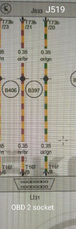

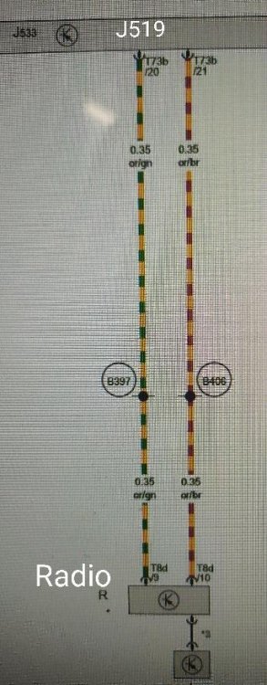

  3. You plug everything in at your own risk ..... This is how I wired FL citigo with 5F MIB2 radio You connect CAN bus COMFORT not CAN bus DRIVE !!! First check if you have wires in OBD2 socket pins 8 and 9. If so, you can connect to them, see the wiring diagram. If there is nothing there you have to finish the wires from BCM J519 (J533) unit pins 20 and 21 (CAN Comfort High/Low bus) on T73 b connector and connect it to radio CAN H/L pins and obd2 socket pins 8 / 9. SEE WIRING J519 (J533) Onboard power supply UNIT or BCM (09 Cent. Elect.) B406 CAN Comfort LOW connection in the cable harness B397 CAN Comfort HIGH connection in the cable harness After connecting all wires you activate in 19 CAN GETWAY your device either 5F device or 56 radio... After activation in 19 CAN Getway and proper wiring, you will connect to the radio via diagnostics and the automatic radio shutdown must work when the key is removed. Next, component protection will activate and you will need to visit your local dealer to unlock. Sorry for my english Good luck
  4. Hi, you need to finish the CAN Comfort in the OBD socket and BSG unit ( J519 pin 20/21). Then check 5F unit ( not 56 radio) in CAN unit list. The radio will lock up, protecting the components. The dealer will unlock it for you.
