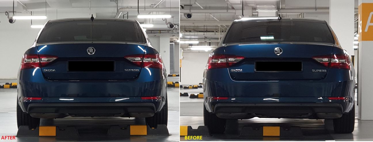

my workshop mechanic did it for me, sorry i dont have the photos when removed, but let me check on the part codes etc. he did mention this highlighted part here was worn out (the brackets that hold onto the bumper), hence he replaced it. this video may assist:
Noticed that over time the rear bumper 'drops abit', thus there are small panel gaps visible where the tail light areas are. It became more obvious after it the rain and the dirt piles up at the panel gaps, and it became more noticeable. Upon removal of the rear bumper, the clips were worn out, and required to be replaced. Below are before and after pics. Something minor, but hope it helps, it can be done to 'minimize' the gaps.

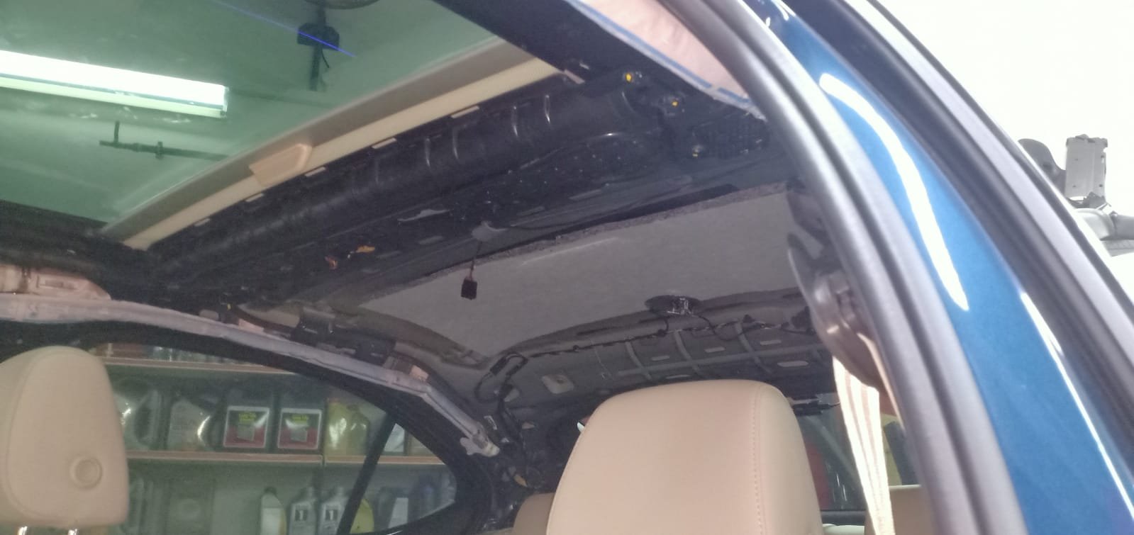

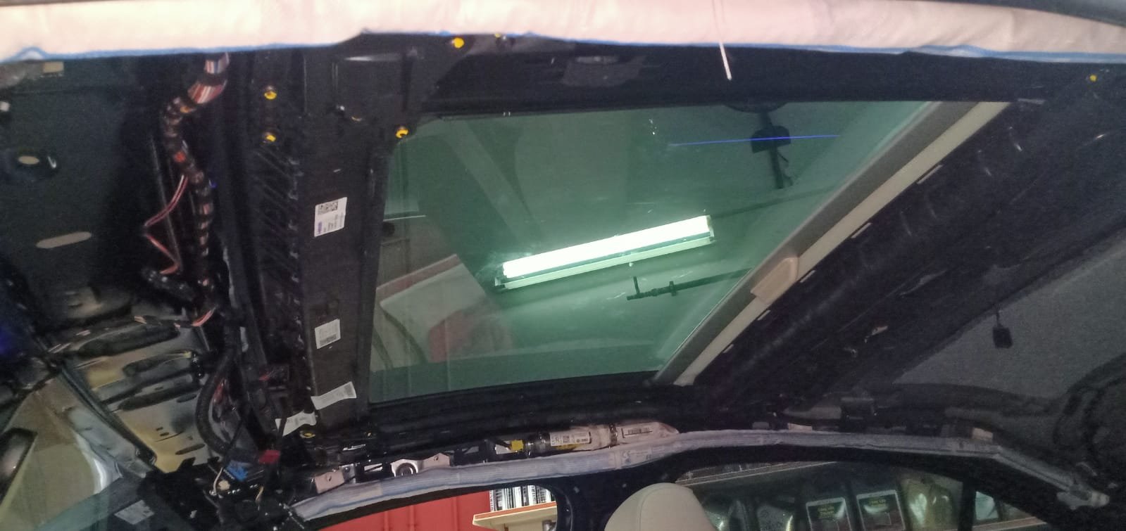

Just to update everyone who had been assisting me in this forum, and those who are experiencing this issue similar to mine: 1) went to the workshop, headliner removed 2) mechanic discovered that panoramic sunroof track is worn out [driver side] 3) he advised whole sunroof track is required to be replaced if want to completely eliminate the noise 4) advised me to head to agent to get it replaced since under warranty 5) he secured and tightened the bolts/brackets, applied some grease 6) now there is about 50% reduction in the frequency of the popping sounds overall i can hear the difference in improvement, since i left about a year for warranty remaining, ill continue to drive and see if i really need to head to the agent or not. im just glad i managed to see the real cause of the noise now, instead of self-diagnoising. thanks to all who have given me your advise here in this forum. 4.mp4

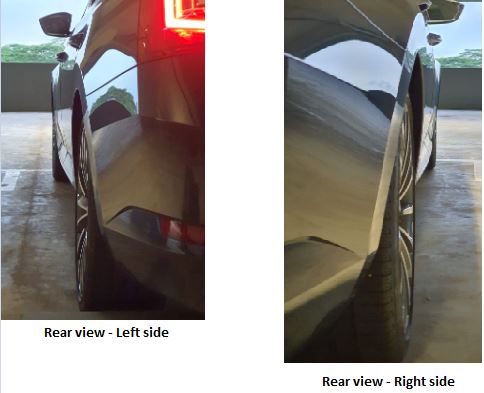

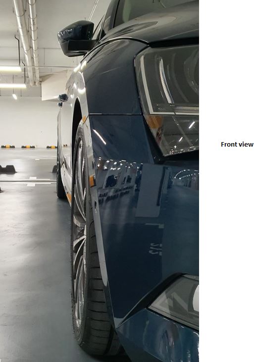

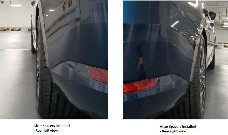

Wheel spacers?
Wheel spacers?
Just changed to 15mm hub-centric spacers alluminium alloy for both front & back. I really like the Trinity 19" Rims. But I would change to forged rims next year, in the meantime I thought of just trying spacers for the outlook. Attached some photos to see the difference for before and after.
