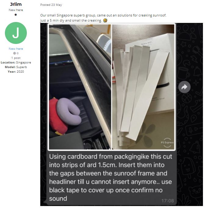

@Jrlim actually suggested this method, i would try later on to see if it would work...
Tried the above method but didn't manage to fit the boards inside as the headliner is securely attached to the cassette. Any advise on how you went about it @Jrlim
