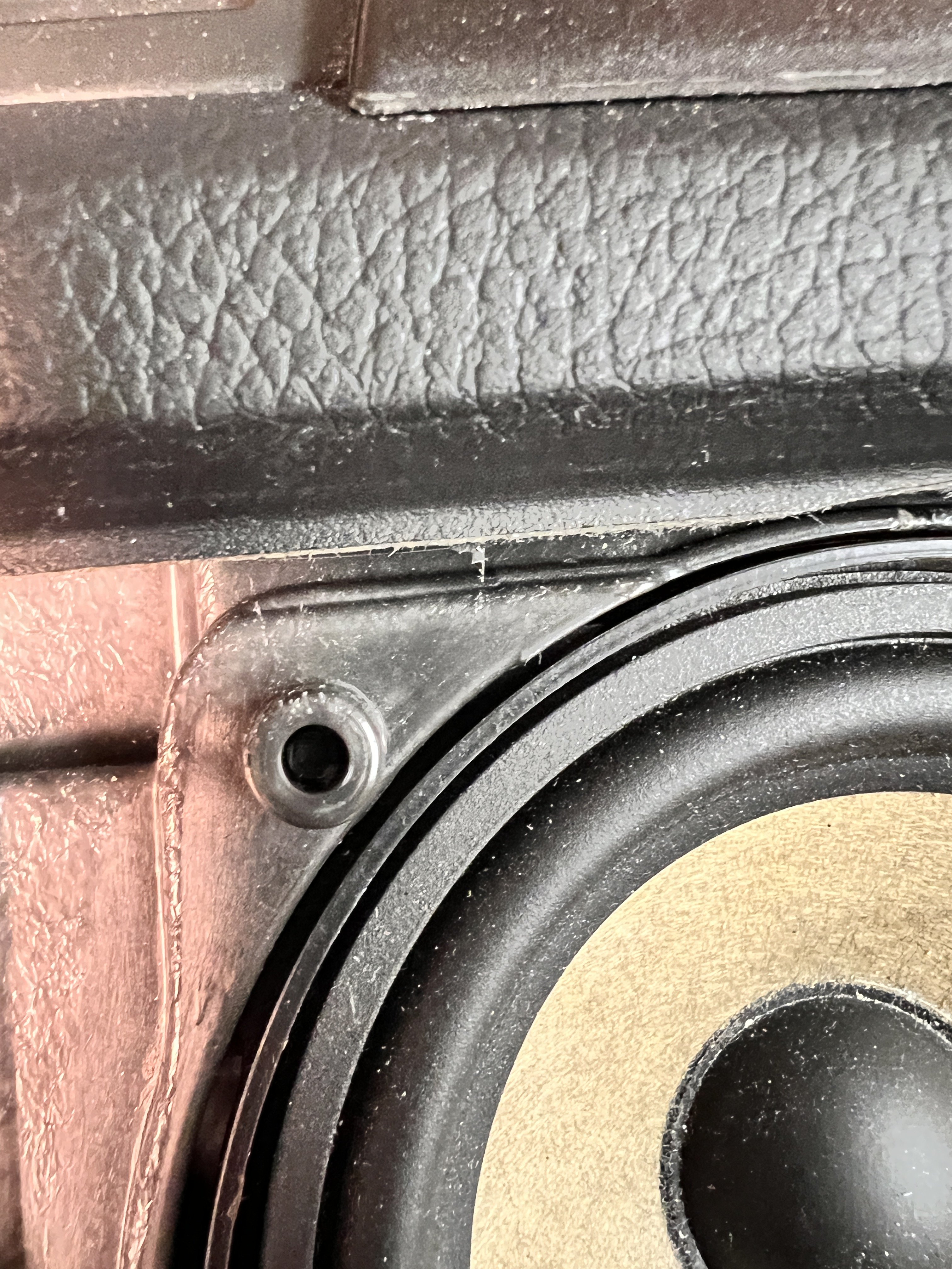

  1. Answer to my own question. Speaker is bolted from below. So bolts are upside down. You need to unscrew them by removing radio screen and there is also something else on the way behind screen. I actually just cut that speaker out with soldering iron by melting that plastic frame. Just needed to change that speaker and there is no intention to put it back. But i hope this helps someone else.

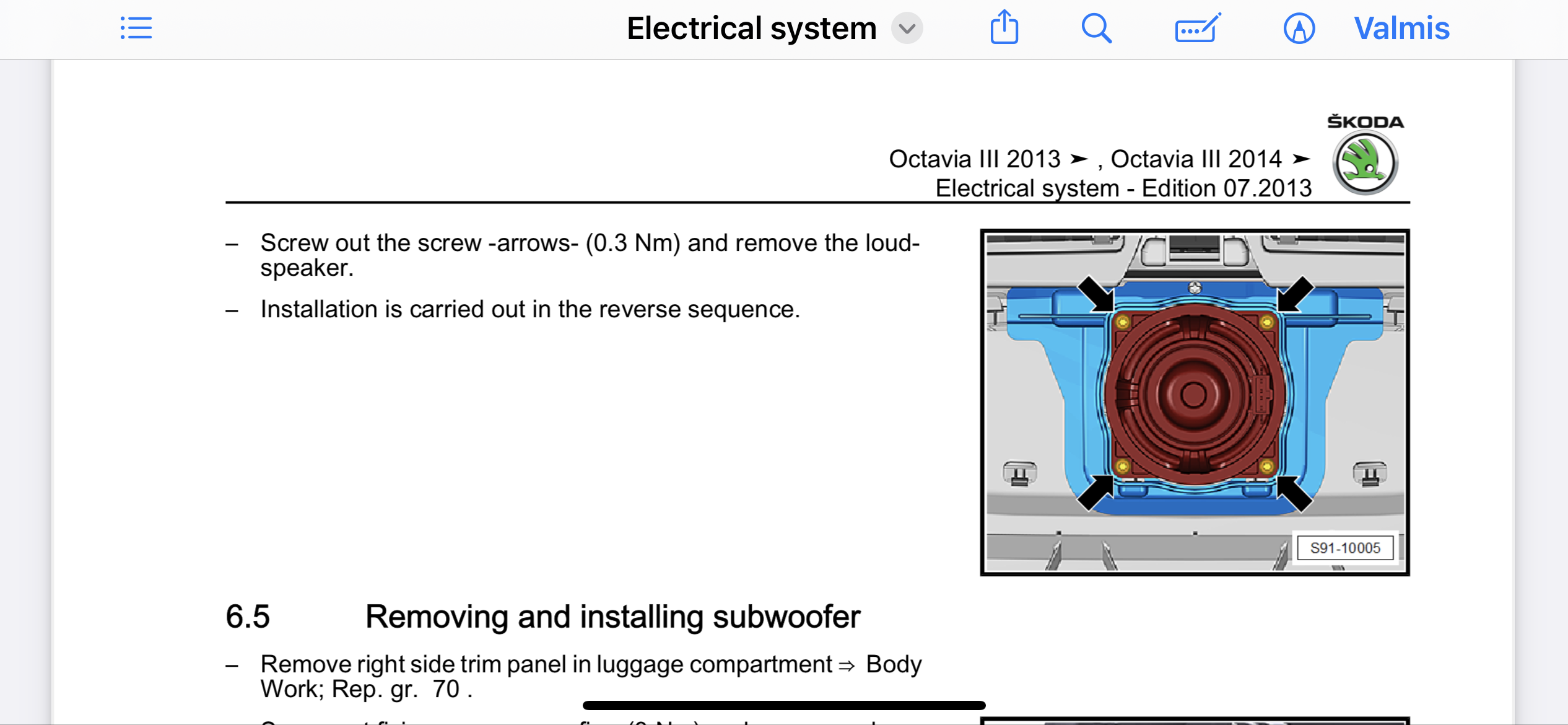

  2. Hello! Does anyone know how to remove center speaker from Canton sound system? I managed to remove speaker grille. But that speaker looks odd. Workshop manual says that remove screws but im my car there is some plastic knobs. Thanks!

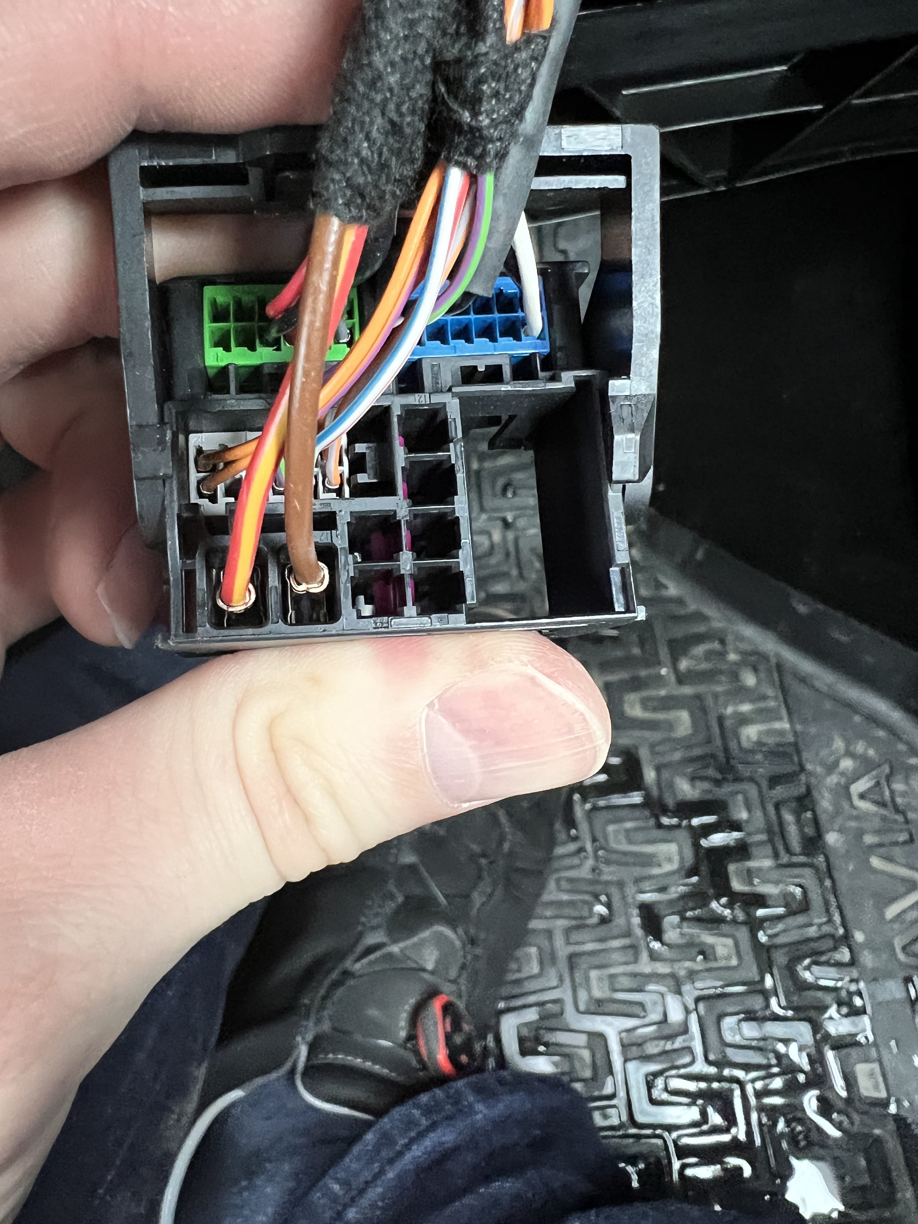

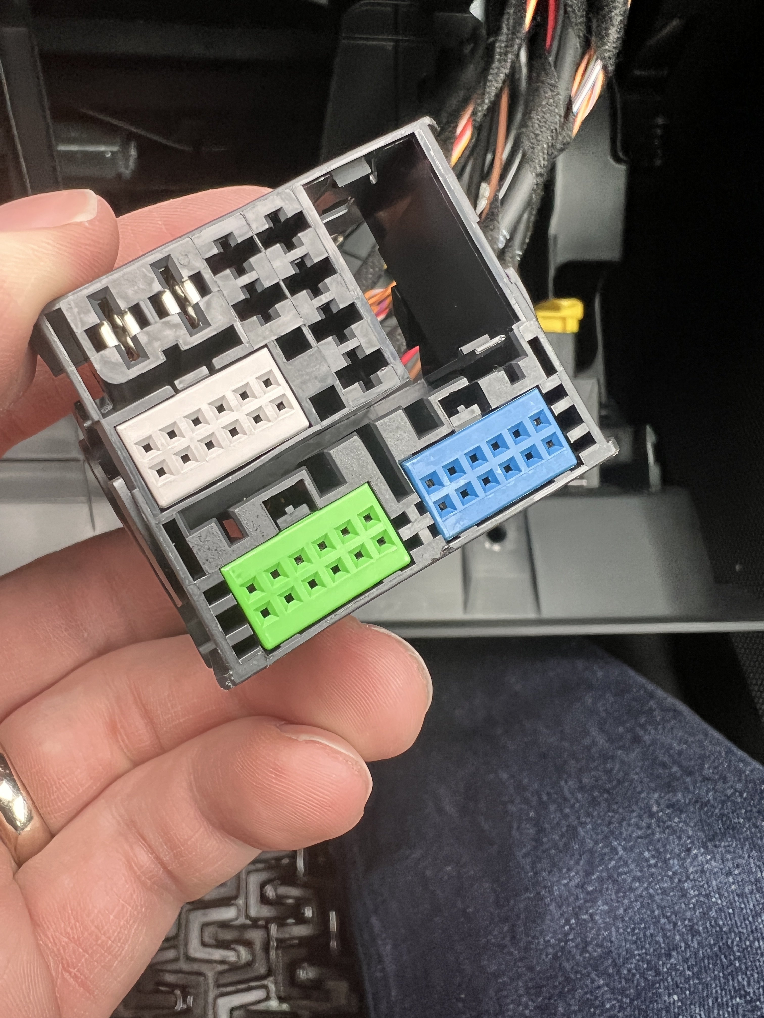

  7. I think i already got the answer to this. i opened up that head unit. It looks same as normal stereo but without speaker signal plug. So i think its possible to change there any Android unit.
  8. Hello! i have Canton sound system in my octavia rs230 2016. I would like to change Canton sound system amplifier to DSP amplifier. Its not possible to change it without changing head unit. So im asking if someone would know what is difference between Canton and normal stereo head units wires? Is it possible to plug normal head unit instead of Canton head unit and run new speaker wires from head unit to new dsp and it would work?
