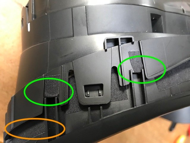

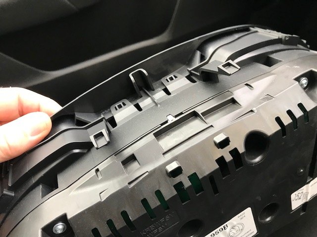

  8. Installation is the reverse of removal, obviously. But first, I wanted to de-creak the cluster surround. I released it by carefully undoing the clips holding it in place (most of them, at least - there were two I couldn't figure out, so I left them and settled for being able to pull the surround mostly free of the cluster, rather than all the way). To start with I tried putting tape on the surround where I thought it was meeting the cluster (example shown in orange). But that didn't seem to do anything, so I had a closer look and realised that most of the creaking was at the locating lugs near the clips. So I released it all again, and wrapped tape around the part of the cluster where the lugs meet it. It creates a snug fit and all but eliminates creaking between the two surfaces. The result appears to be a noticeable quieter dashboard

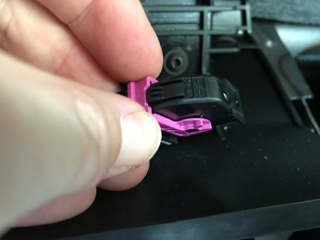

  9. 7. Finally, remove the wiring harness. The biggest problem I had with this is the access is poor, because there's very little slack in the harness and, even with small hands, you need to do everything by feel. Looking at the cluster from the front it's at the lower left rear. Just to the right of the pink clip in the picture you can see a small black nubbin - you need to press this and then rotate the clip to the right (as shown in the picture) to release the harness. It's easier than it sounds... the hardest bit is not being able to see any of it.

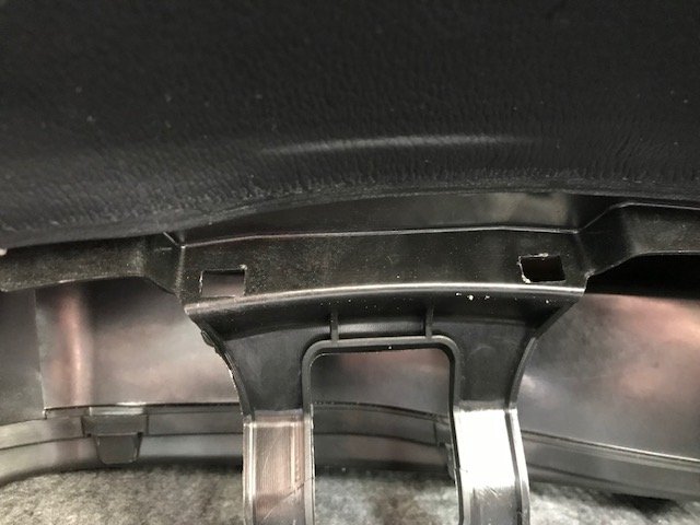

  11. 4. The two bolts recessed at the bottom of the cluster need to be removed. They're T20 and they were tighter than I expected. I also found the recess made access a little tricky, and I had to have a rummage to find a tool that'd fit - my go-to ratchet set was too bulky to get in there. 5. Drop at least one of the bolts in the footwell and swear while you try to find it... 6. Just me? Oh. In that case, pivot the bottom of the cluster towards you and, with a bit of fiddling around, the two clips that hold it in place at the top should come free. An old credit card or similar might help if you get stuck - I used a narrow trim removal tool. The picture shows where those two top clips locate, right at the back of the instrument cluster recess.

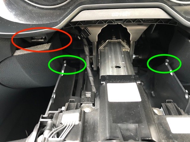

  12. Right then. Here's how to remove your instrument cluster (at your own risk - I'm not an expert and pretty much just figured things out as I went along). 1. Ignition off 2. Pull out and lower steering wheel as far as it'll go 3. It's at this point that you need to remove the trim at the top of the steering column, and at the base of the cluster They're attached with a piece of flexible fabric which allows the steering wheel to be adjusted. Start by lifting the trim at both sides just behind the steering wheel. It should pop free, and then it will pivot upwards from the locators marked in green in the picture. Give it a gentle pull towards you and it'll be free. The smaller trim piece below the cluster is attached at the point marked in red (one on each side). It pulls straight back towards you. I found I needed a trim removal tool to do this part, but if you're confident enough you can probably just use your fingers.
